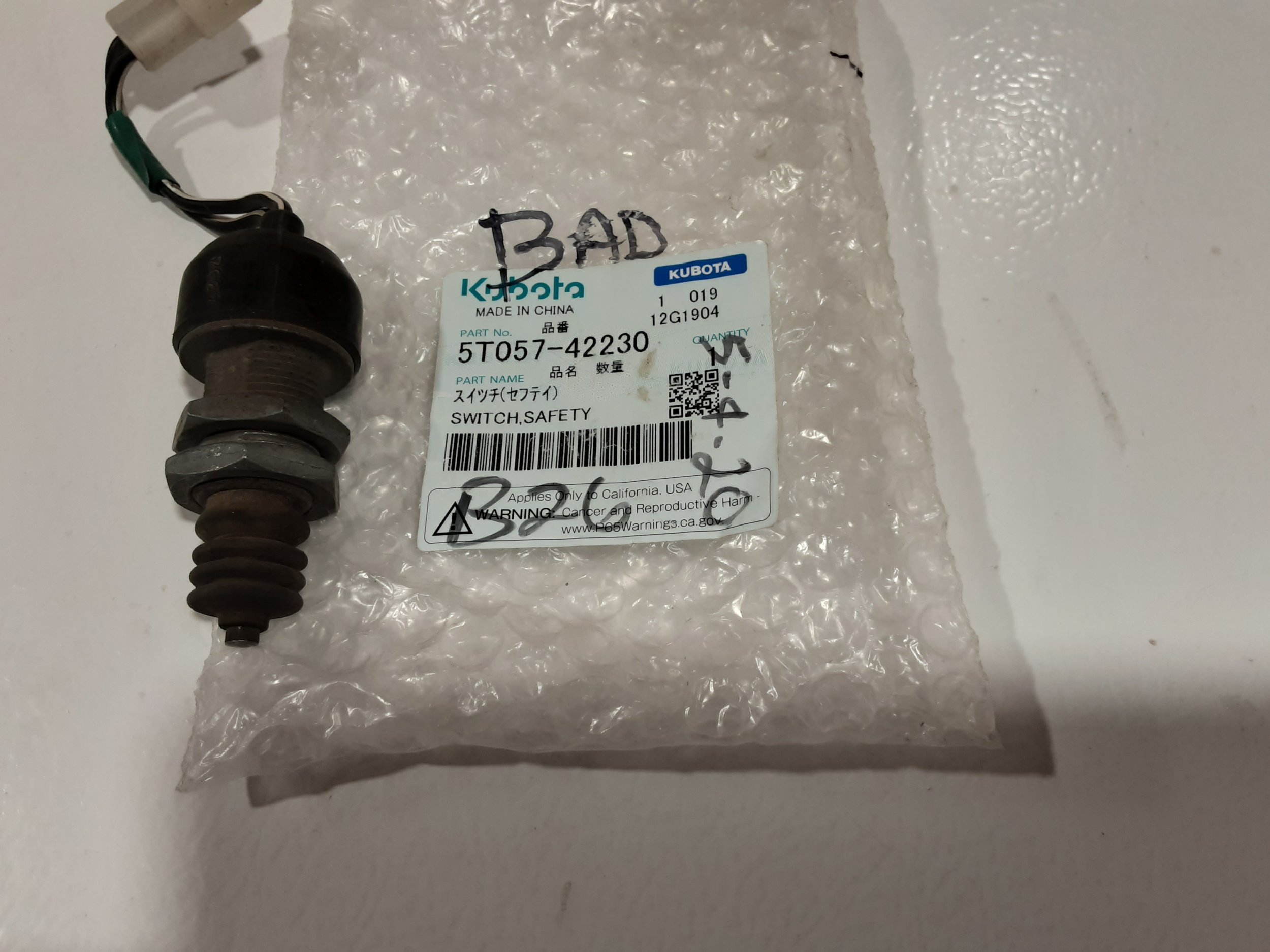

B-26 owner here. I’m blowing 5 amp fuses on the opc area of the fuse block. Trying to trace the problem and notice that the problem occurs just as I step on the hst pedal with forward or reverse. Seat switch works as it should. I have a button to press to activate the open/ close valve for the bucket thumb. That light is often not working. I’m not sure what else may be the culprit! Any ideas appreciated highly!

I found a 5 amp circuit breaker with tabs like the fuse, and used that instead of the fuses. Don't remember where I got the idea from. Been that way a few years now. Jon

That's clever! It's just the finding of one to fit that's the difficult part. Much better with a breaker that can simply be reset if needed!

Brain fart has been fixed. Look at your neutral safety switch. It maybe bad. It is located under your right foot under the patform. Maybe closer to your heel than your toe. It is a pain to change. Very hard to get a wrench turn. My B26TLB is a 2007 year. Jon
