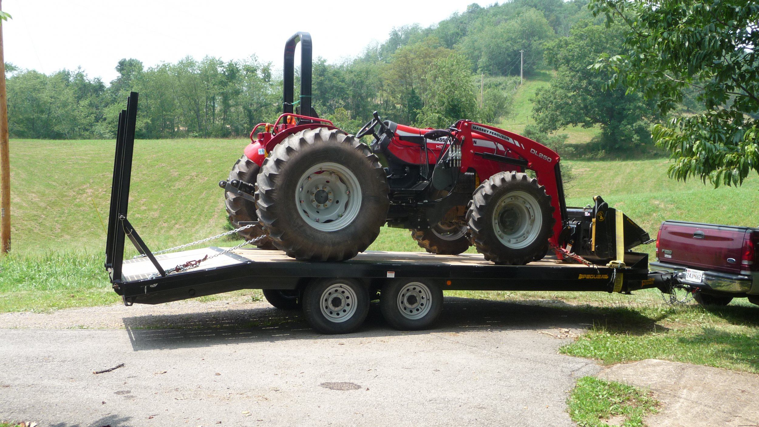

First a Pequea dual axle with roughly a 50/50 placement.

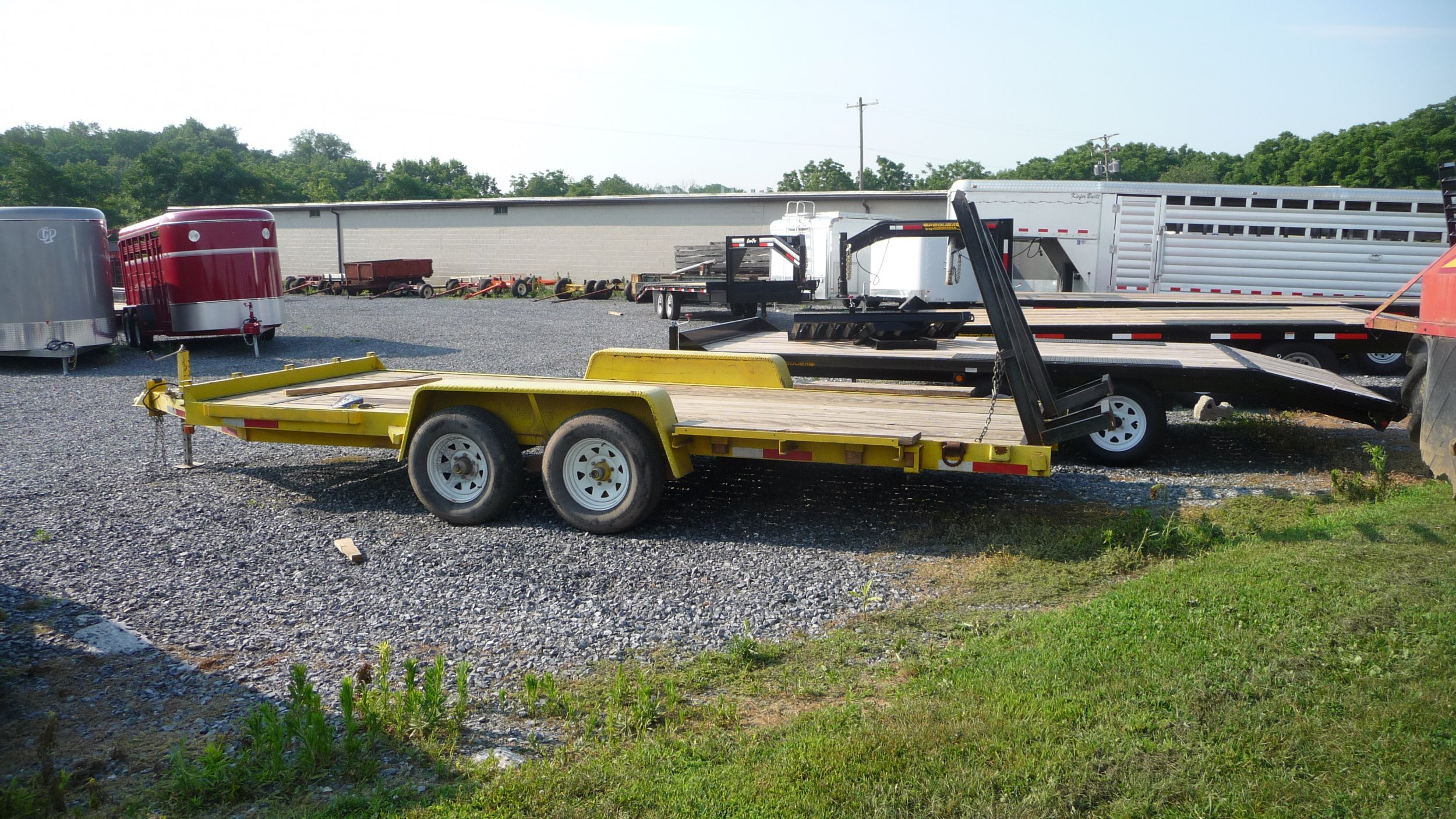

Custom yellow trailer also seeming to be mid-placement but actually forward of center of bed. This trailer was made to tilt too.

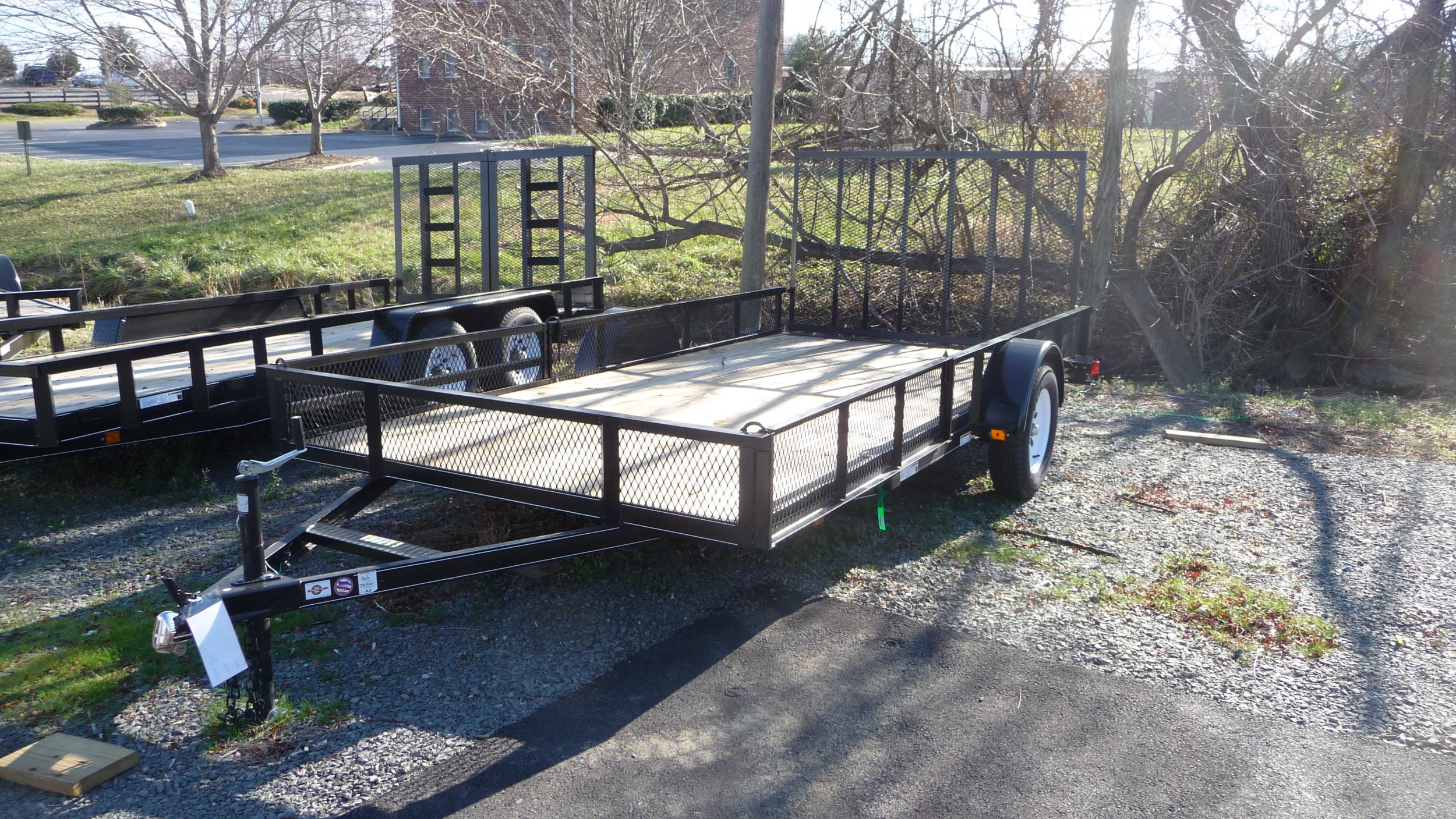

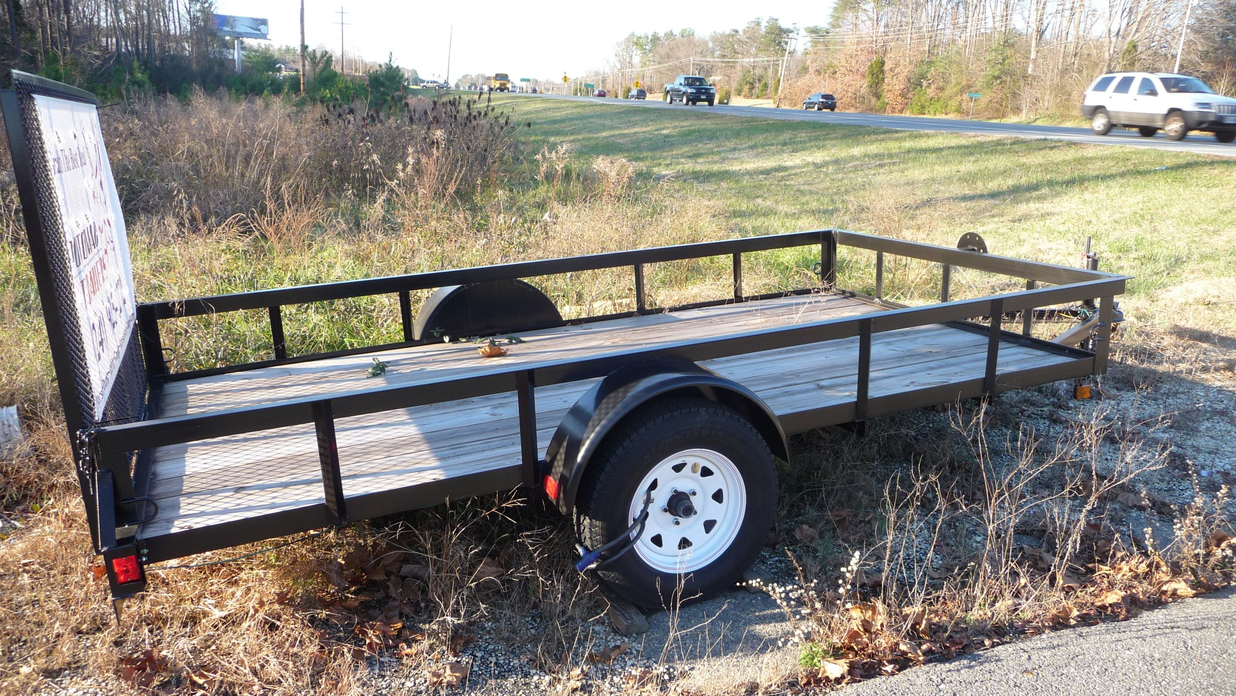

Small utility with very oddly almost exactly middle location

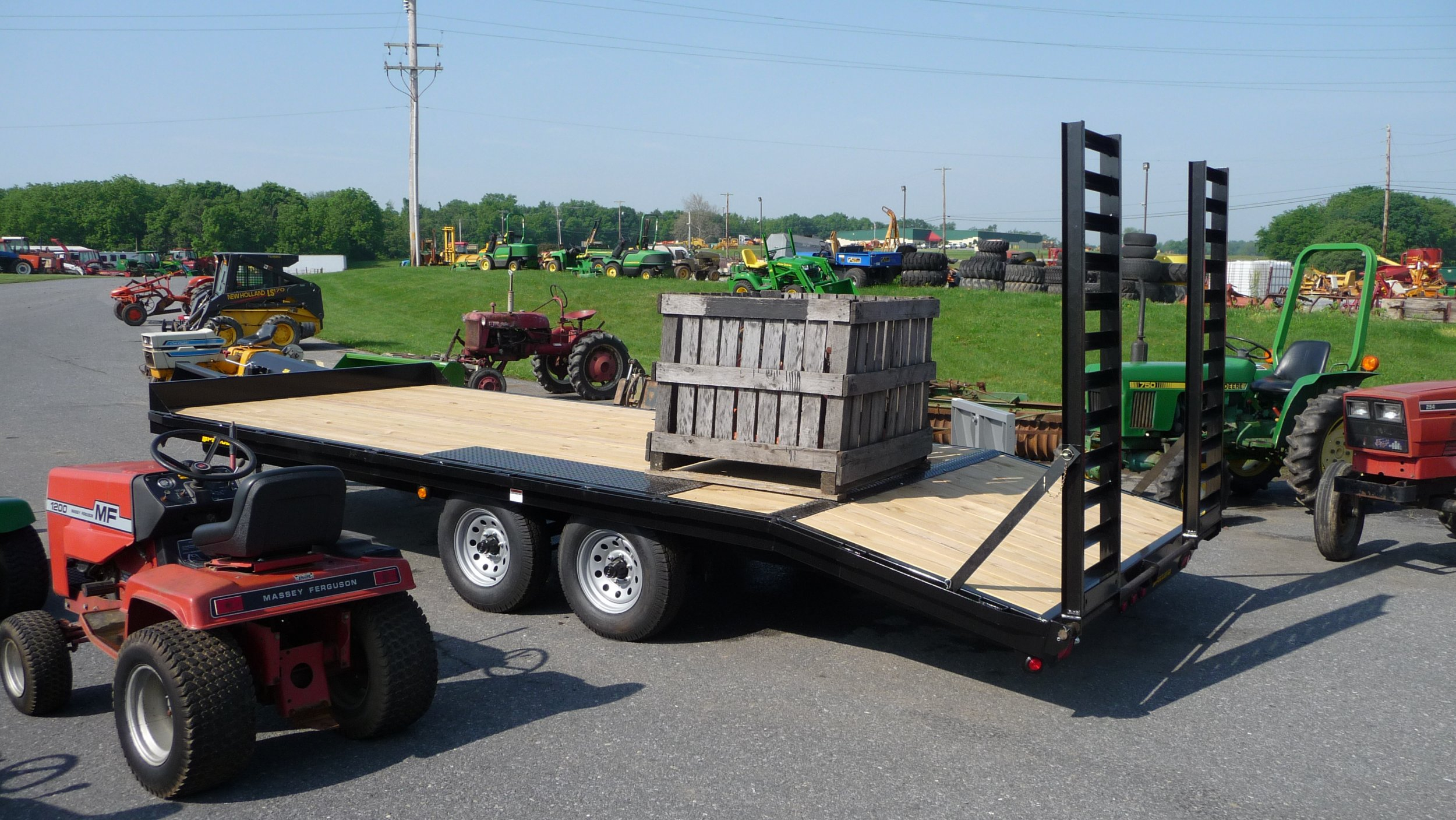

Pequea deck-over again but loaded

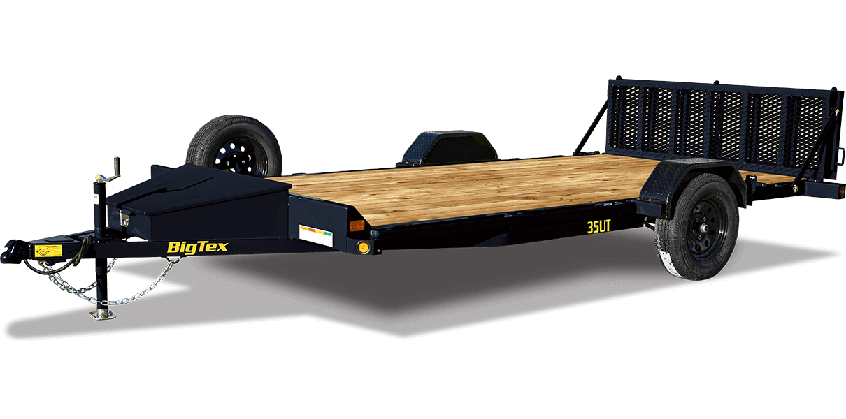

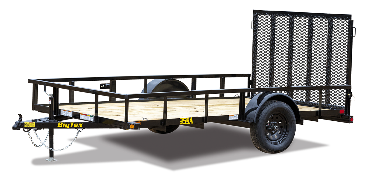

Bix Tex utility -- maybe a 70 - 30 placement?
Maybe an 80-20 axle placement? or more like 75-25? Anyway well to the rear.

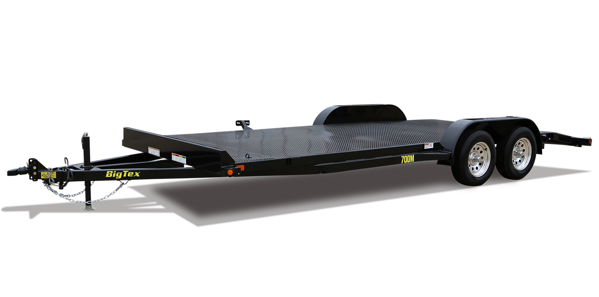

This car hauler has the axles way to the rear.

I had a custom trailer business many years ago and built countless trailers. Because they were all custom I spent a good bit of time with the customer going over exactly what the were going to haul on the trailers. I would adjust my designs accordingly. I also paid close attention to the vehicle that was going to be towing the trailer.
60/40 was the rule of thumb but sometimes I would move axels back or forward depending on the use. If the cargo was more fragile I would move the axels back because the ride is much worse behind the axels. But most of the time I would try to have the trailer carry as much of the load as possible and still have good capacity with enough tongue weight to ensure the trailer tracked well. I also would put longer tongues in to ease the backing pains of novice trailer owners. Never had a trailer come back with issues and every customer was happy. My tilt trailers all had 3 pt pivot designs to make sure the trailer always came down square regardless of terrain. I did not see many others do that but they always came back down nice and smooth.
So from my perspective the placement of axles are really dependent on the type of trailer and what is being hauled. The biggest thing is to have enough tongue weight so the trailer tracks nicely. But all of the designing in the world goes out the window if the person loading does not load properly.
