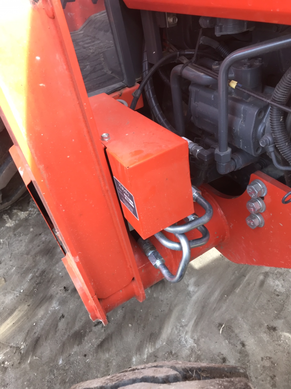

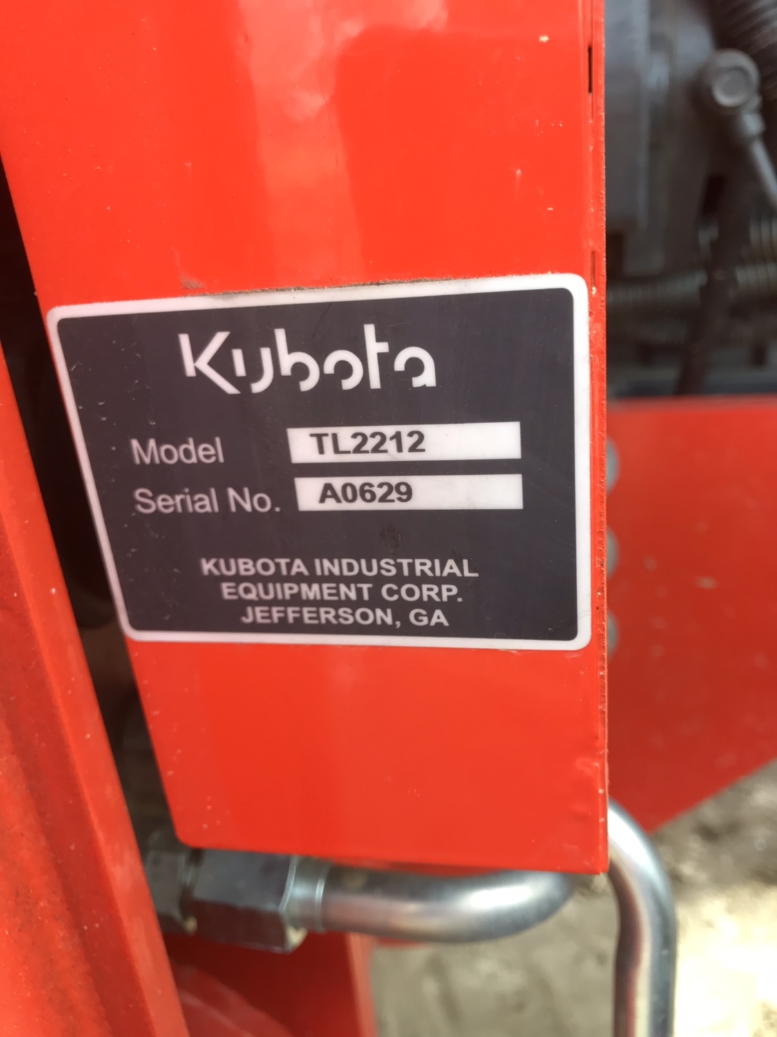

   / Auxiliary Hydraulics TLB M59 #9
4570Man, Can you tell me the PN on the Kubota kit?
