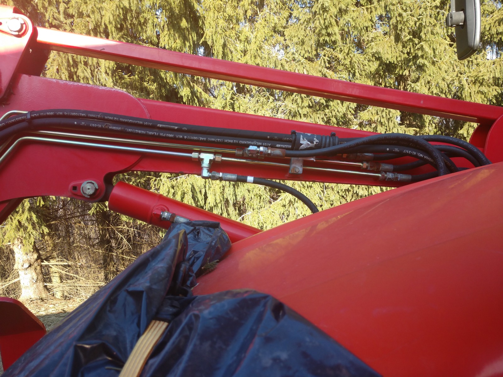

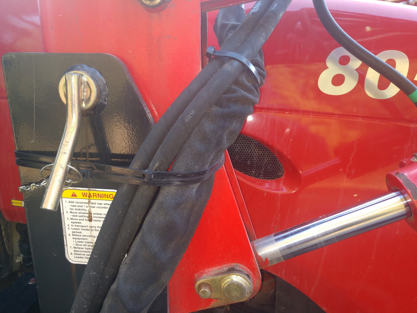

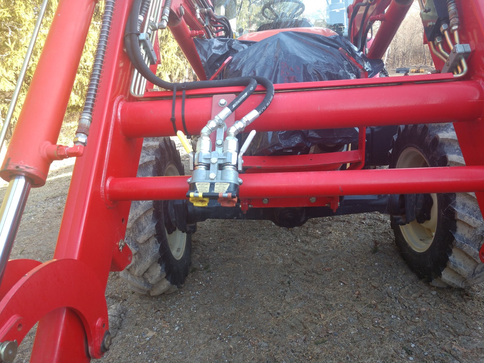

If you are desiring to operate a grapple with your rear remote valve by running hoses up to the front of the loader yes,
it certainly can be done. A detent valve would not be my first choice for that application. you can feather that detent to open and close the grapple.
A diverter mounted up on the cross tube with short hoses from the curl cylinder lines wouldn't cost much more then the long hoses.
That said I have the long hoses from my rear remotes to the front of the loader. rear to front remotes3.jpg rear to front remotes2.jpg rear to front remotes1.jpg Rear remotes1.jpg
   / Auxiliary Hydraulics - rear and/or front for FEL use? #3
I agree with LouNY, that using a rear remote with a detent valve for aux fronts wouldn't be my preference, but as he said you could definitely do it.
Running hoses would probably be the cheapest route to go & if I were to do it I would find a permanent path to route the hose from the rear to the front, mounting them up & leaving them installed even when not in use. I would not want to have to take them on & off every time I needed them & find a way to keep them from getting in the way or caught on something. After you plan the route for the hoses just use a piece of wire or rope to get the length for your hoses, then you can get them from anywhere you want.

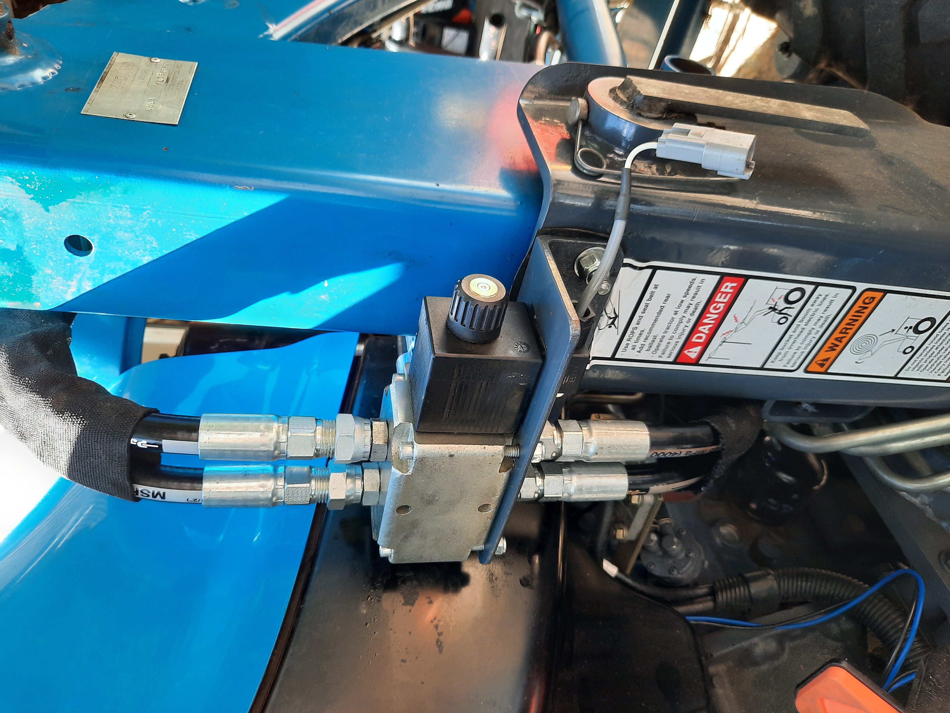

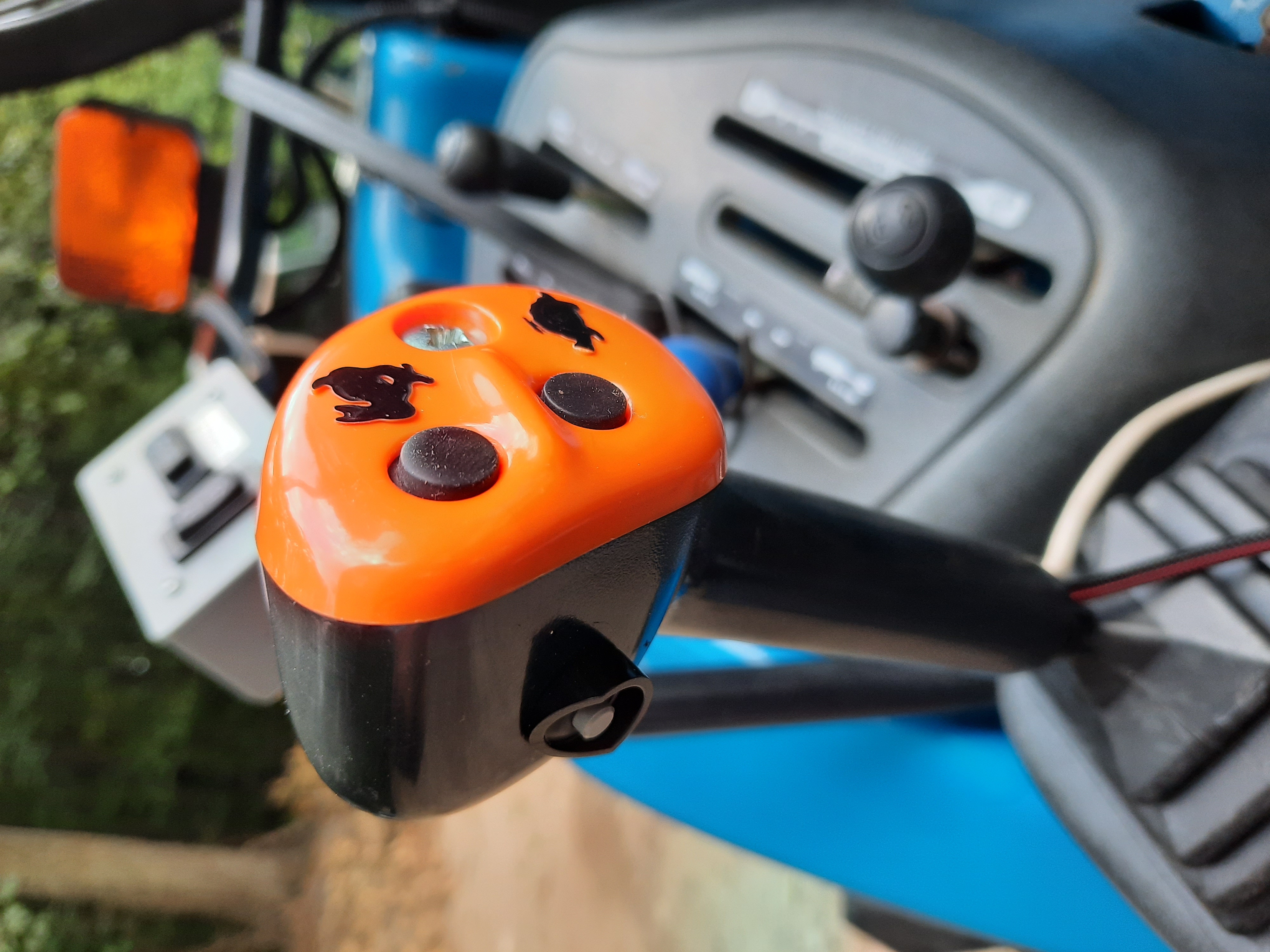

On our machine I finally switch to a diverter valve for the front & personally like it much better then when we used one of our rear remotes but I'm sure this is just an individual preference. I like it better because the way I set it up all of the FEL controls are done with out taking my hand off the loader control... I made my own mounts for the diverter & then mounted a switch to control diverter on the loader handle. It was more money but we really prefer this setup now that we have it...
