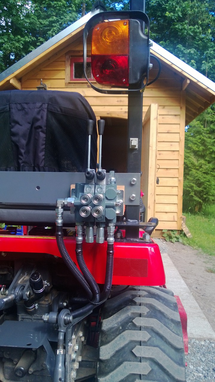

I just got done adding a valve and a set of rear remotes on mine. I'm planning on running top and tilt cylinders with them.
I hooked into the factory-installed FEL valve on mine. From your signature it looks like you have the same setup so you could do the same thing.
According to the service manual this is also how the backhoe hydraulics are hooked up.
The base plate of the loader valve has three ports. The service manual doesn't have information on what they are so I experimented and found, from top to bottom: Pressure, Tank, Power Beyond.

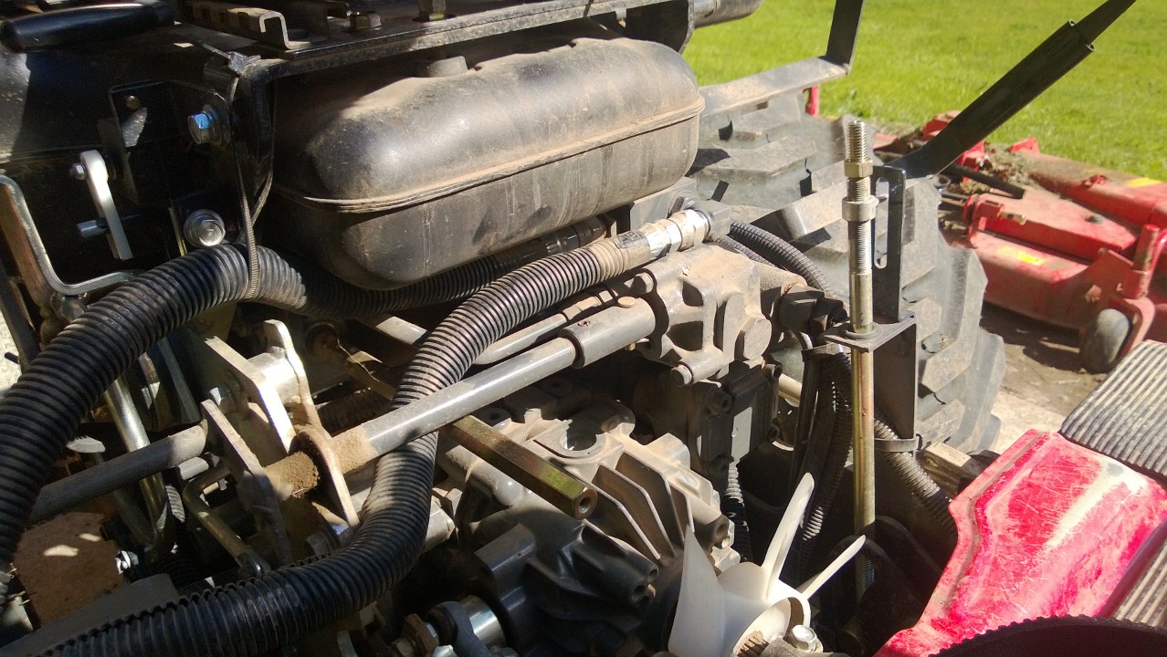

I needed three new hoses:
1 - from PB port of FEL valve to P port of aux valve
2 - from PB port of aux valve to P port of 3PH
3 - from T port of aux valve to tank
#1 and #2 replace the factory hose that runs from the FEL PB port to the P port of the 3 pt valve.
All hose fittings need to be BSPP, the hoses should be 3/8" in size. I found that not all hydraulics stores stock BSPP fittings so it might be worth giving them a ring first.

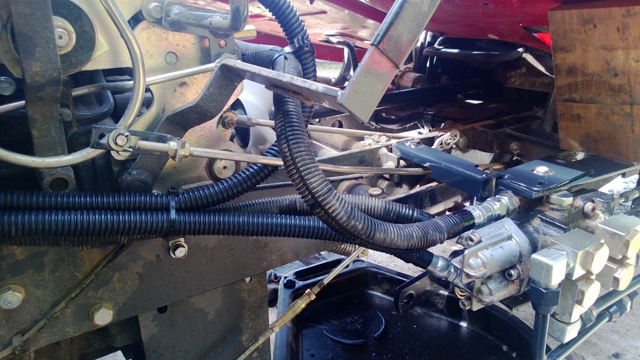

The hose that runs to tank (#3) can be connected to the tank fitting at the rear, roughly to the right of the fluid level glass. There is a plug below the right lift arm that you take out and that is where you can connect the hose. For that the hose needs to have a male end on a 45 deg angle. All other ends are female.

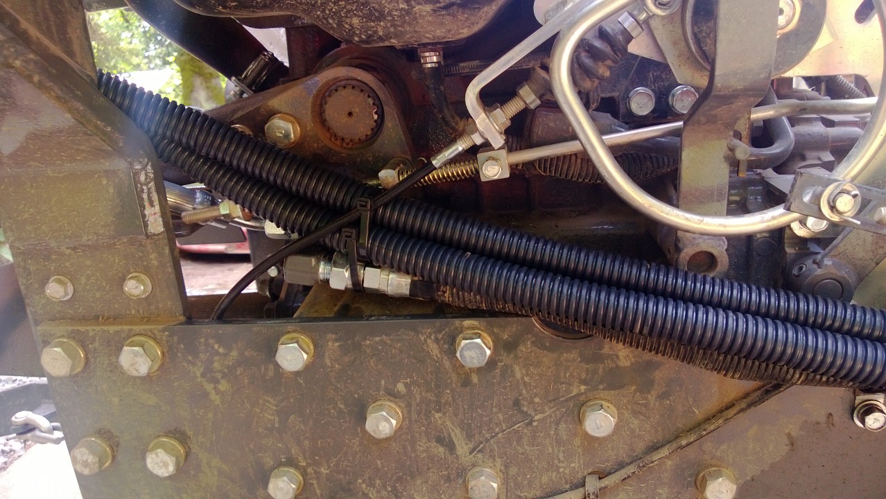

I ran hoses 1 & 2 between frame and right wheel along the FEL tank line. I believe this is where the lines run on backhoe equipped machines as well -- I don't see room anywhere else.

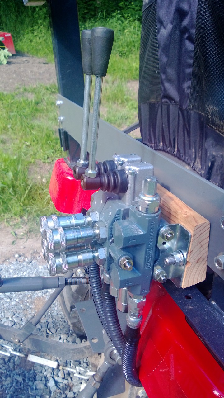

When shopping for a valve try to match the GPM figure of the tractor (6gpm). In other words, get a small valve. Otherwise, it'll be hard to find room for it and it'll require lots of adapter fittings. I got an 11gpm valve (Bucher HDS-11) and that's about the biggest I would use. Also, the valve must be open center and have a PB port.
I mounted the valve behind the seat so that the cylinder ports are pointing backwards and I screwed the QDs directly into the valve with only an adapter (as opposed to routing the QDs to their own bracket). I will have to see how that holds up in the long run.

Here you go :)
The first two pictures show what the valve looks like and where I mounted it. Note that I haven't made the final bracket yet, right now it just sits on a block of wood mounted to a crossbar. You can see how the 2 pairs of QDs are screwed right into the valve. The P port is on the right, the PB port on the upper left (with the 90 deg fitting) and the tank port is the one on the left.
The third pic shows how the aux valve is connected to the tank fitting.
Fourth pic: Pressure lines to and from aux valve are routed between frame and right wheel, alongside existing tank line.
Fifth pic shows the new lines (the clean ones): The bottom one from FEL valve PB port to aux valve P port. the top one from aux valve PB port to 3PH P port.
Last picture shows the old line from FEL valve PB port to 3PH valve P port. It is the line in the back, halfway under the tank & held up by a ziptie. This line got replaced by the two in the previous picture.
