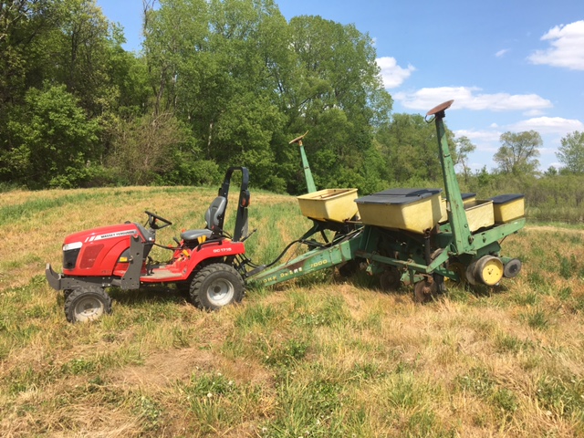

I needed rear hydraulics to run my corn planter, so I bought 5' of hydraulic hose and used the hookup for the loader to run it. Worked perfectly, without the high cost of adding an outlet in the rear.
