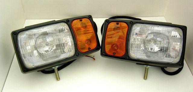

Hog I've been shopping for some aux. lamps for over a month and a half. Finally settled on a pair of lights normally used on a truck snow plow (see attachment) I will be mounting them on my canopy very shortly. The thing I liked about them the best was high/low beams, turn signals, and marker lamps built into each assembly. Found them at eBay where else.

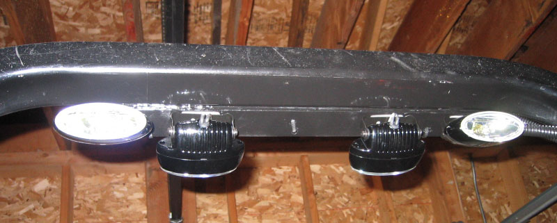

I installed 4 PIAA brand automotive Fog Lamps on my ROPS. I took a piece of angle iron and used marine epoxy to adhere it to the ROPS then I painted it to match. The marine epoxy has a 5000# shear strenght, and it does not void the warrenty of the ROPS like welding or drilling do.
I used FOG lamps becuase they throw a wider beam of light and I was looking for light in front of the tractor so I could see where I was working, I had no desire to light up the field 300 yards out, I was worried about 30' feet. My fog lights are 35 watt. The switches I used are 100% waterproof submersible switches and they are hooked to a relay to take the electrical load so the switches are protected.
The lights are hung UNDER my ROPS because I have lots of trees and I didn't want the branches tearing them off. The attached picture is a view from under the ROPS looking up at the lights and the bar that they are attached to.

Bob- Do you have the upgraded alternator?
It looks like you can rotate all four front or back. Is this true?
Or is 70 watts each direction enough?
