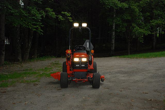

I have a BX2350 and love it. However, I need extra lights to do snow cleaning at night. I have the stock alternator, 14.4 amps (I think). I know you can order the bigger alternator for approximately 250 + dollars, and then cost of lights. I was told by my dealer to buy some cheap lights at ex. autozone, and it should be fine. The lights are 55w, 12v, which is approx.4.5 amps, or 9.1 if you calculate 110w. This is ok? Anyone have LEDs?

I just added two small driving lights from AZ for back up lights. I put an all weather rubber coated toggle switch where the cruise control button would go. If you think about it, the DC Cig plug is rated for more than what the two 55 watt lights use. I haven't had any problems but I let the machine idle a little while with all lights off before I shut it down for the night just to make sure the battery gets charged a little.

I am planning to add a work light at the top of the ROPS and plug it into the aux power thing. I found a source for a magnetic base light 55W.

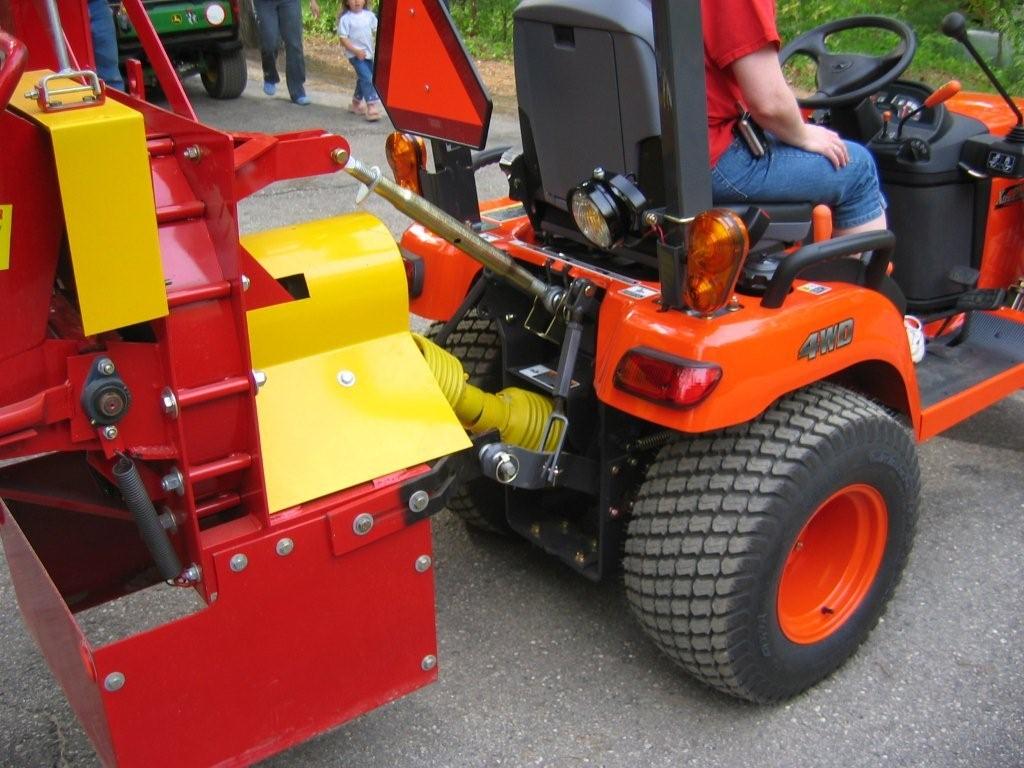

I added the Kubota dealer add on rear work light and it works great for any rear work. There are plug in points at the rear of the tractor for it that are hot with the ignition is on. The light comes with its own on/off switch. I chose this as my installation location-Personal preference. Lights up everything! It comes with enough wire to mount anywhere on the ROPS. No need for any alternator changes. cost is about $65.
