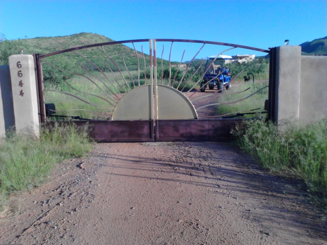

I use a 3600 dual for my front gate. It is big and heavy. Solar powered
Gate Crafters has the best selection of perfectly matched accessories to meet all your gate and gate opening needs
