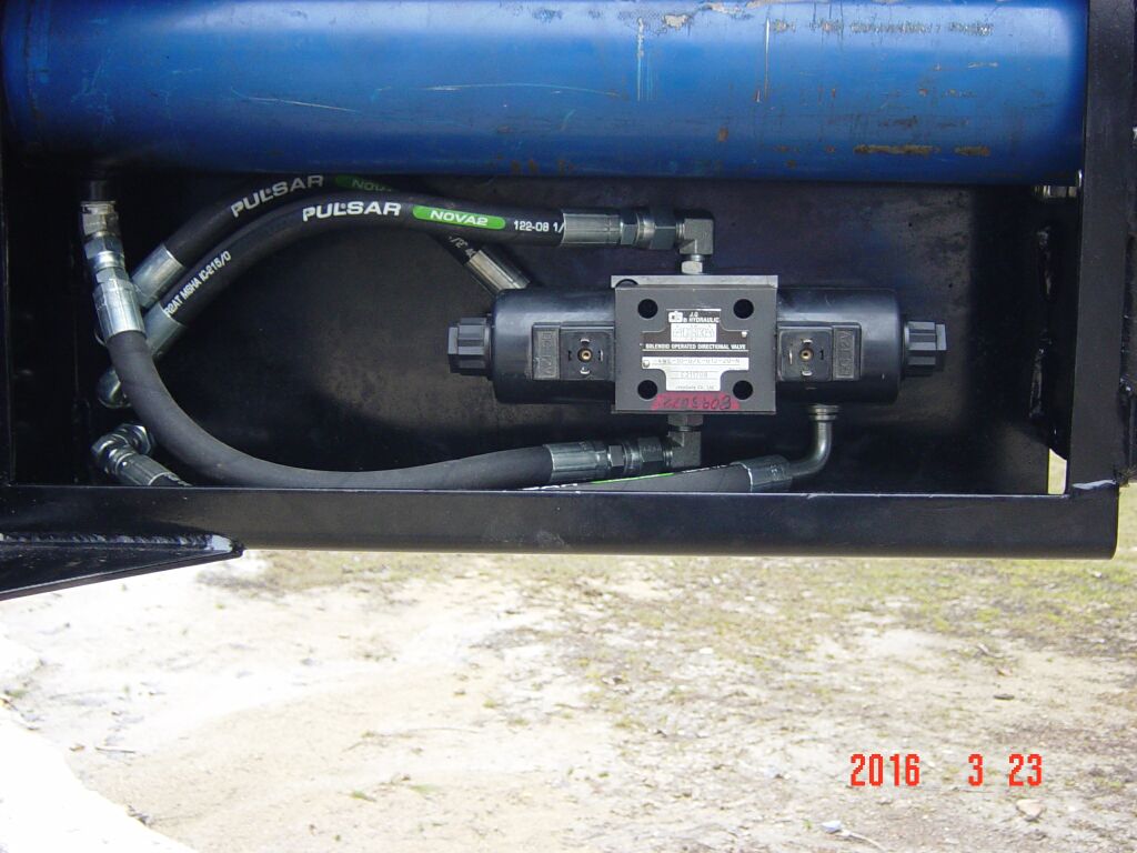

   / auto-cycle valve #2
I am in the process of building my splitter with such options. It is controlled by a D05 Electric Valve. There are a host of limit switches and a bunch of relay logic. Basically, you push a button and the splitter cycles. People (on here) have scolded me about the dangers, but that's what I want. There will be safety stop switches on the unit. I may send you a picture of what I have so far, later.

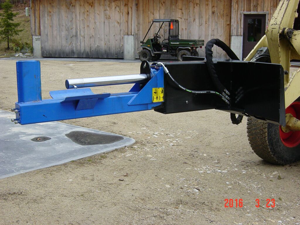

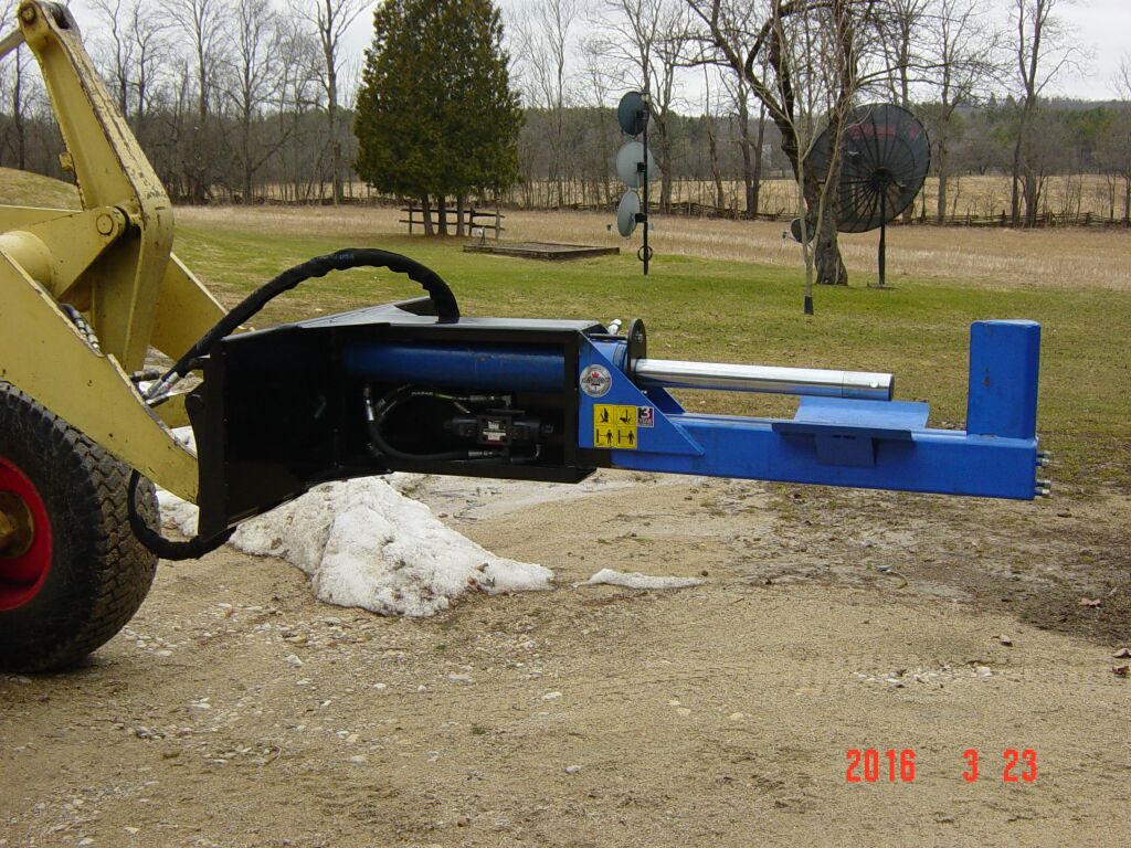

   / auto-cycle valve #4

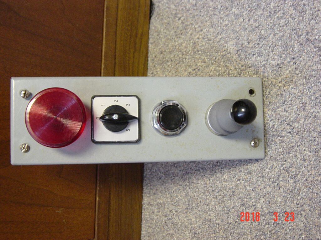

This is as far as I've gotten. More work then I figured on! The beauty is, once the electric valve is in, your options are limitless. Maybe some day, even direct brain interface! lol
The last pic is the control console. The splitter behaves normally using the joystick. The multi position switch allows you to set the position to which the ram returns to several presets for shorter wood.
