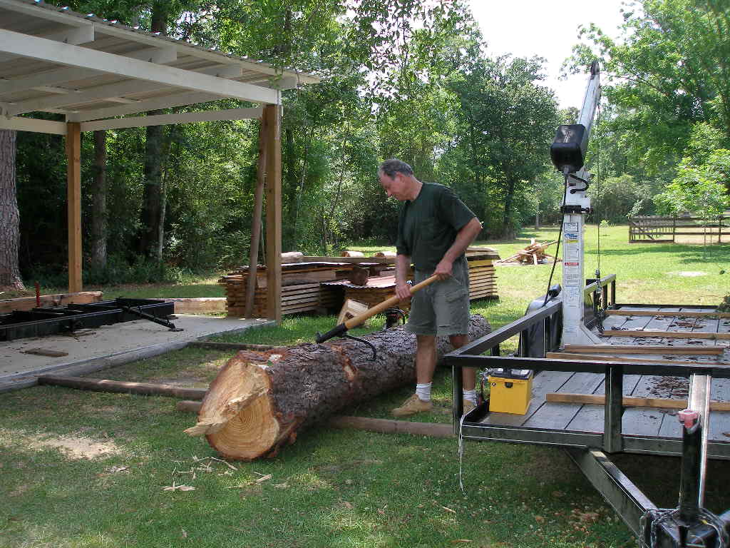

Wow, you bought an fantastic little crane. New they are $2400. I bought a great used one for @$400 to load logs on my trailer.
I'm a one man show and it sure comes in handy. Here's mine. I don't need any out riggers either.

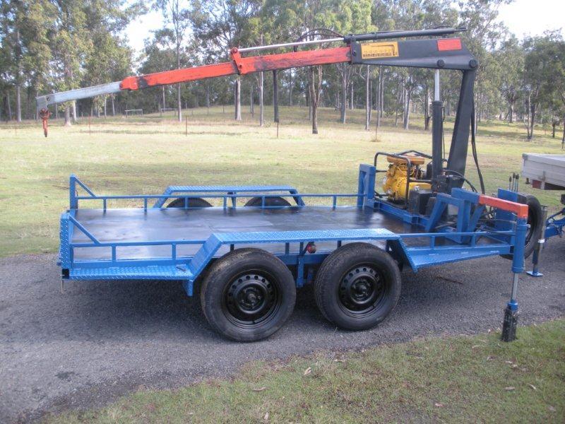

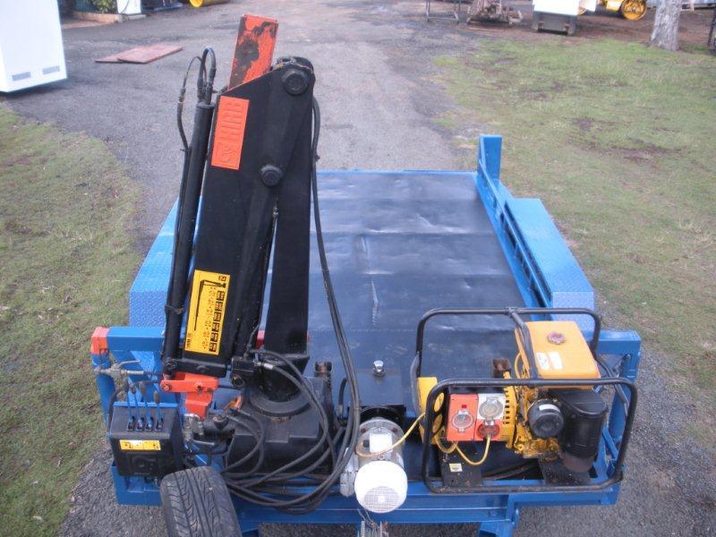

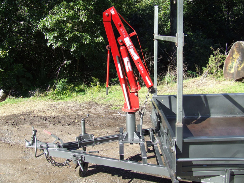

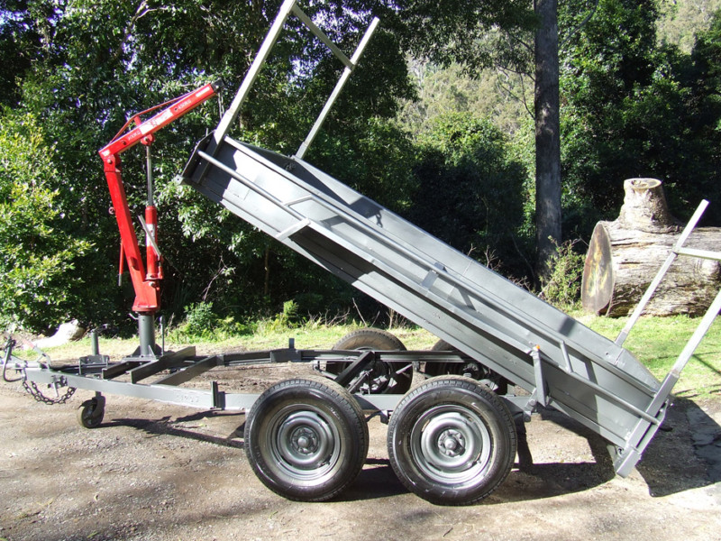

Here's a couple of crane trailers I've built, which might assist for ideas:
- Photo 1&2 was my second attempt & a little over the top, but has proved it's worth many times. Basically a 11'6" x 6'3" car trailer which I reinforced & modified to mount a Hiab crane/powerpack in a removable cradle so I could use the crane/powerpakc independently ( the crane was purchased reasonably , I already had the 5KVA genset & hyd pack ). The crane/powerpack I made to be removed in less than c.10minutes, so after undoing a few bolts/cam locks) it self unloads with the hyd outriggers & is then self mounts(secure by a few bolts/cam locks) in stand alone frame (fitted with 3PL mounts) for independent use in the workshop or around the farms on a tractor 3PL (it will lift c.3000lbs @ 6' to 1300lps @ 12')
- Photo 3 & 4 started out as a 9x5 box trailer & my desire to make a simple tipper out of it, anyways got the tipping thing worked out & then couldn't justify the hassle/cost of the electric powered hydraulics for occassional use. So after playing with hand & electric winches for tipping lift settled on using a small hand powered engine crane I had laying around (not fast or powerful but with the geometry will tip about c.1600lb), it gets 100x more use as the trailer crane than a tipper...
