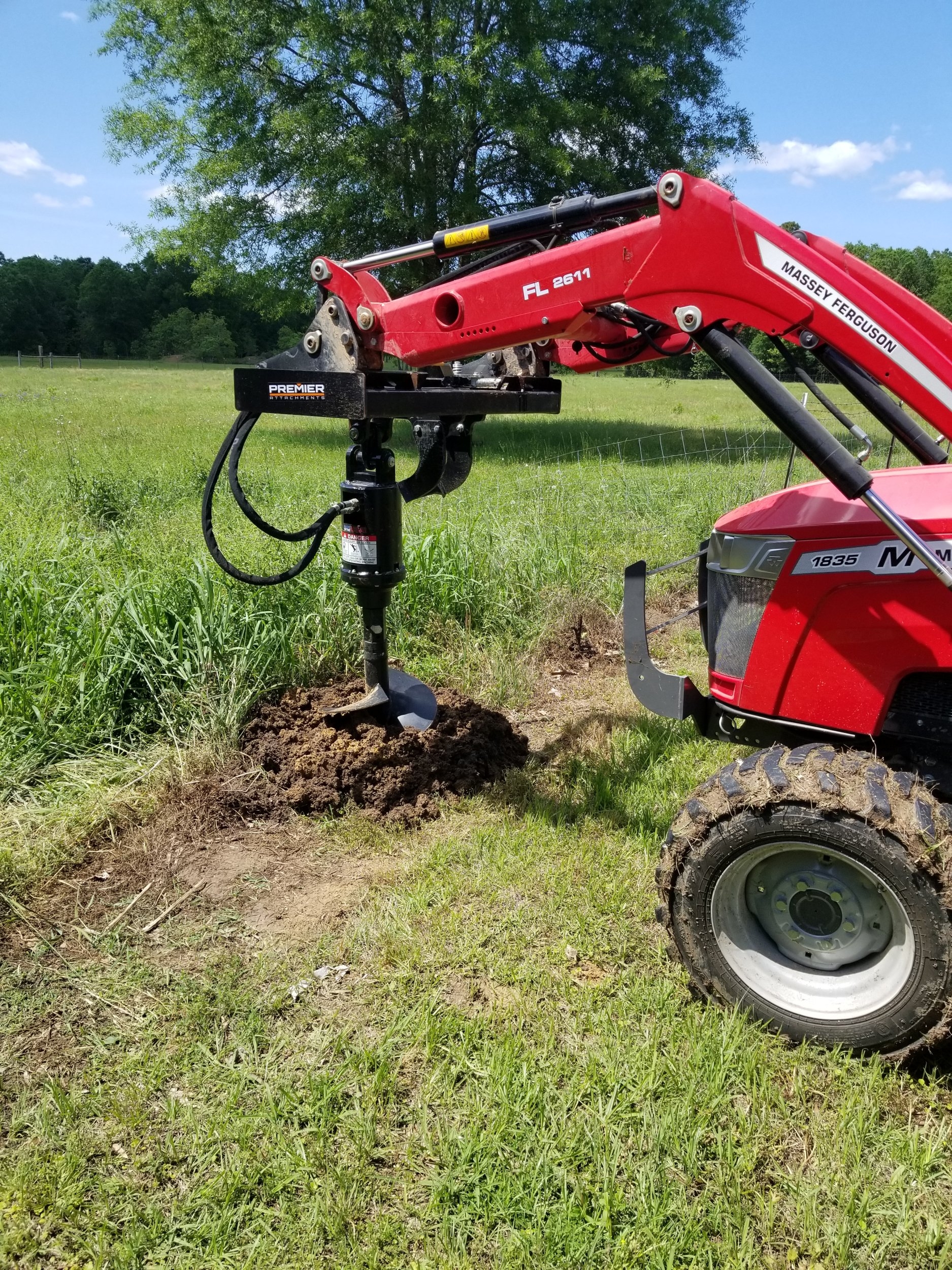

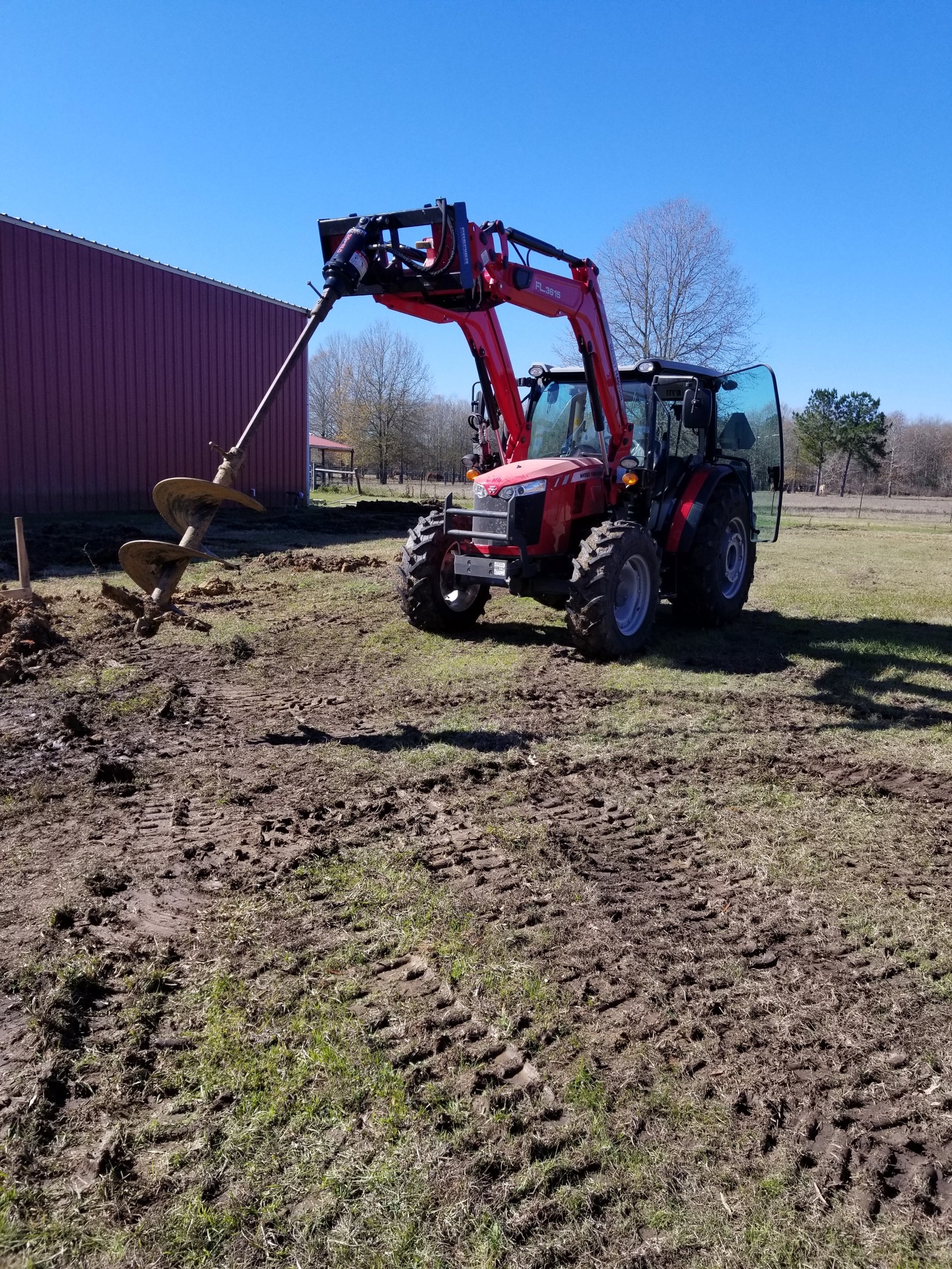

I have one of the skid steer style augers with an 18", 12" and 9" augers that I've ran on both my MF 4707 (75hp) and my MF 1835M (36hp). We have heavy clay here and it works great even on the small tractor. The reason it does, as pointed out here, is the flow rate and the type of motor. The hydraulic flow rate on the 1835 is 12.6 gpm and the 4707 has a flow rate of 17.6. I borrowed a 24" auger and did some 5 ft deep holes when we added a wing onto the shop a few years ago and for that I had to use the bigger tractor but it handled it easily. But one of several reasons I went with MF tractors was the hydraulics being so strong, relatively speaking. Then when I bought the auger I made sure the specs on the motor were compatible with my tractors.
As far as PTO augers, I've had a few over the years and still have one that a friend borrowed and I've never bothered to get it back. I hate them. Not only can you not reverse it but in this heavy clay it just sits on top of the ground and spins.
With your flow rate I think you're going to have a problem ever getting it to work correctly. I agree with a couple of the suggestions above - either add an auxiliary pump or rent a skid steer to do your job. I suppose you could try a smaller auger like a 9" but that may not work for what you're doing. I usually use utility poles for fence posts so they run from 8" to 12" in diameter and the 18" auger works well for those sized. But that's just me.
