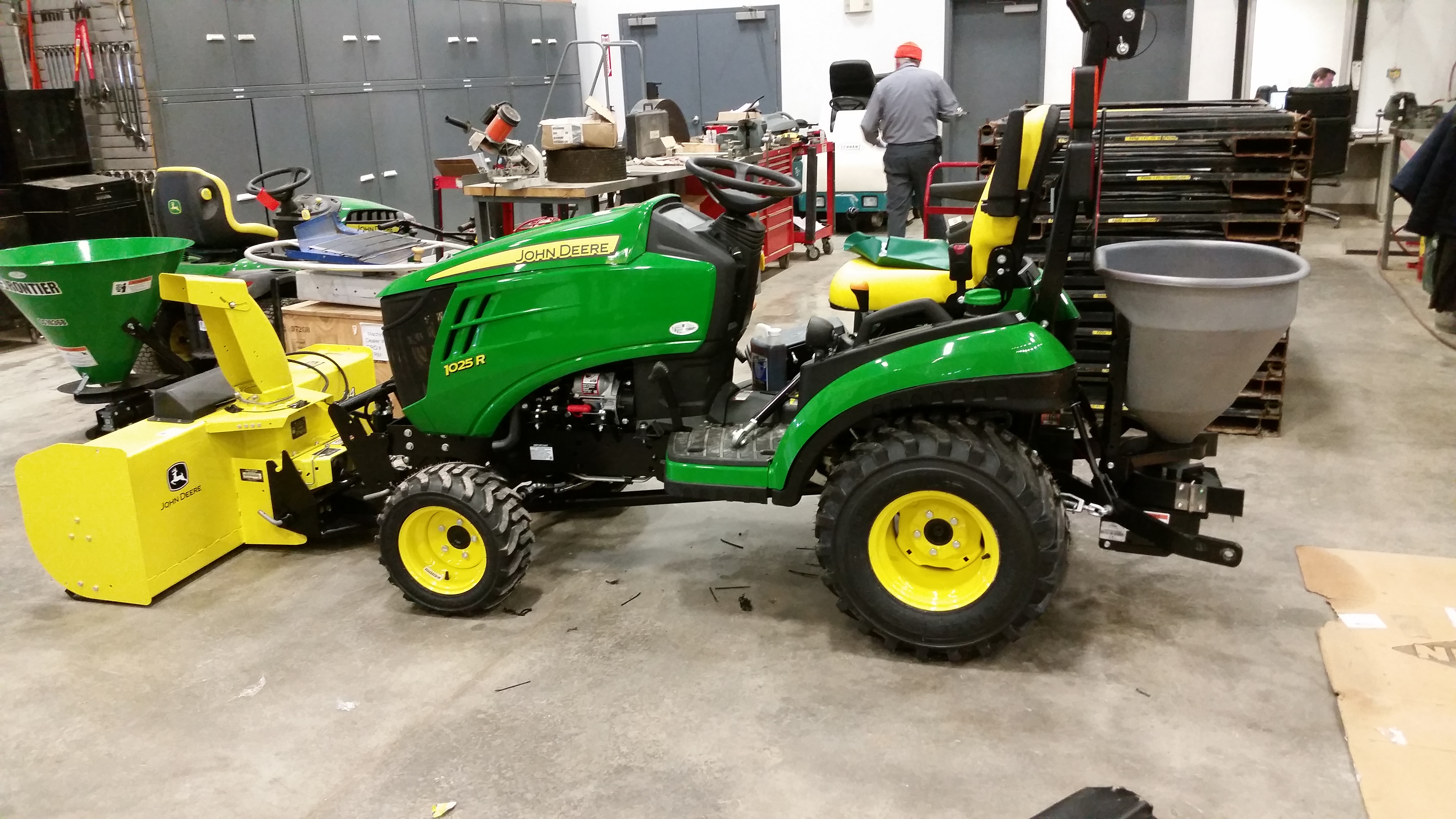

we just installed a reese hitch mounted curtis spreader on the back of a 1025R,
the lower lift arms could stay, we had to remove the top link and tool box,
the customer wanted to shorten up his overall length with the blower and
spreader on, and the 3ph spreaders were substantially longer than doing it
this way. we ordered in the Omni hitch for the tractor.
and this is 12v, so no pto required for this spreader.

Hello,
I know you posted this topic quite a long time ago but if you see this can you tell me what model of Curtis Spreader you use for this mod.
Thank you
