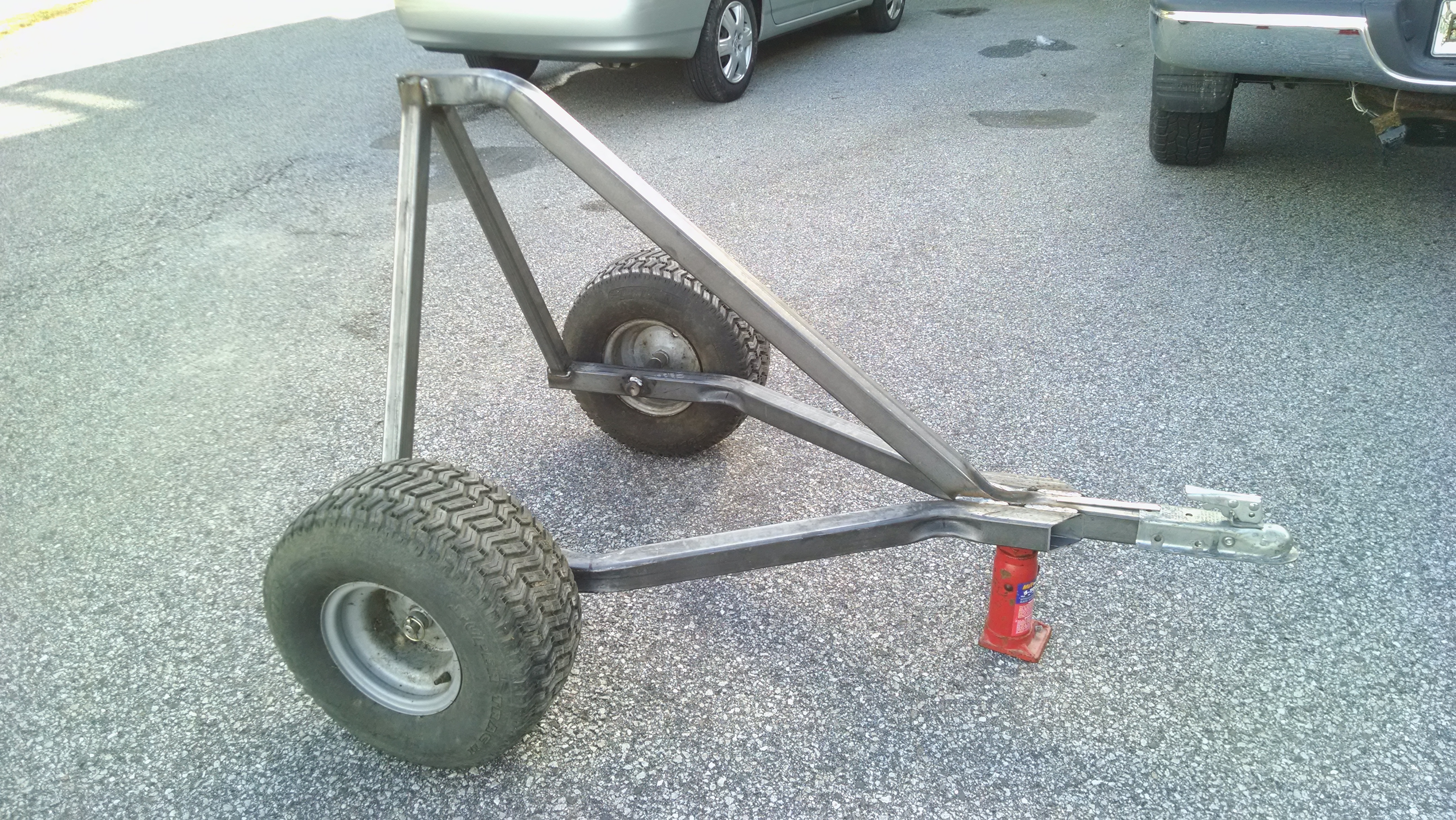

Looks Good! Yea they do work pretty good, I wanted one so I built one a couple years ago and It works great! Really takes the strain out of pullin long heavy logs.

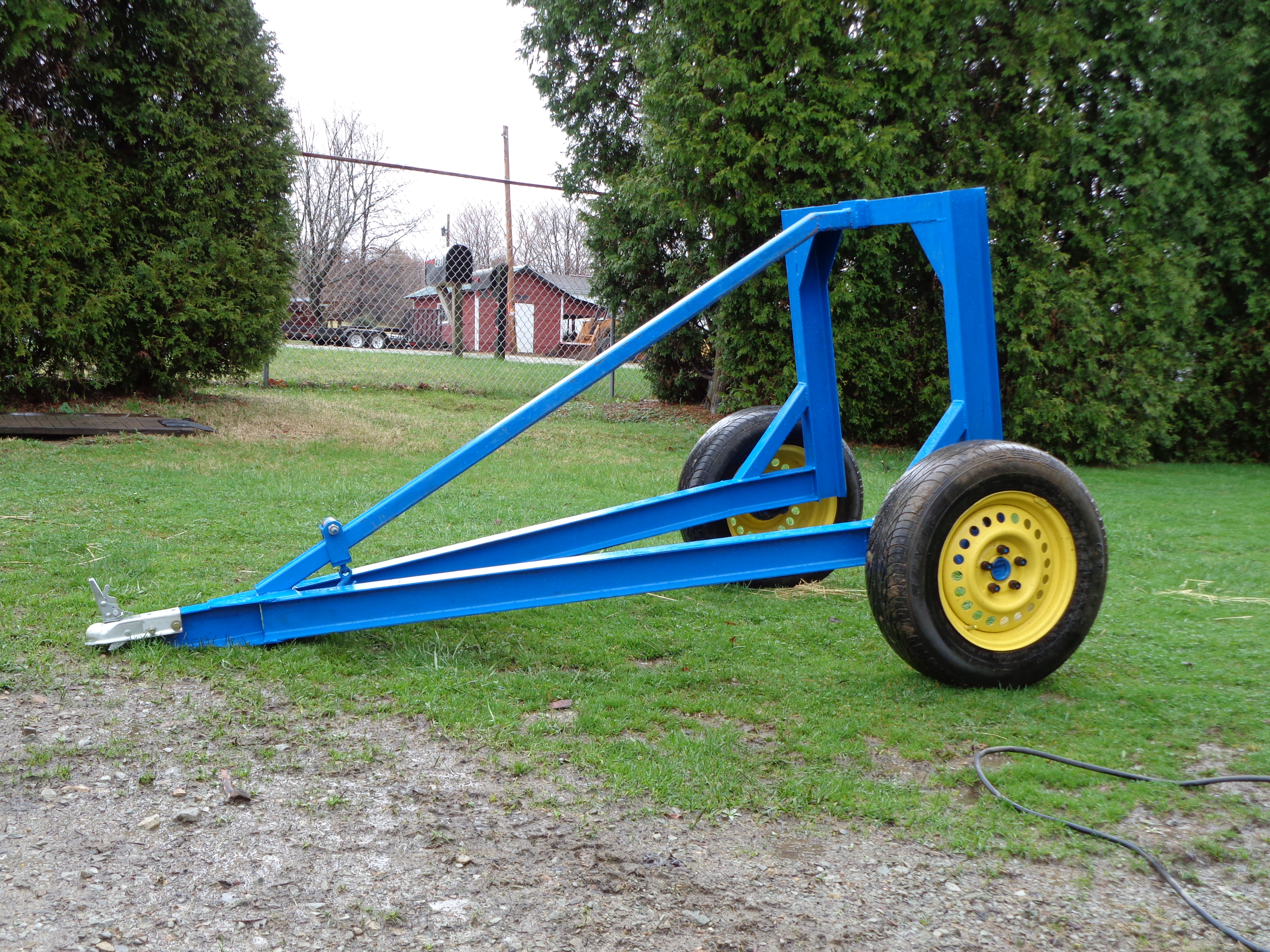

I like the sliding hook so that, when you start pulling, it lifts the butt of the log off the ground. No lifting winch required. Nice job, both guys. Someday I must build one myself.
   / ***ATV log arch*** #4
Also makes for a great brake - when you stop the tow vehicle, if the log keeps going, it will slide down until it hits the ground and stop.

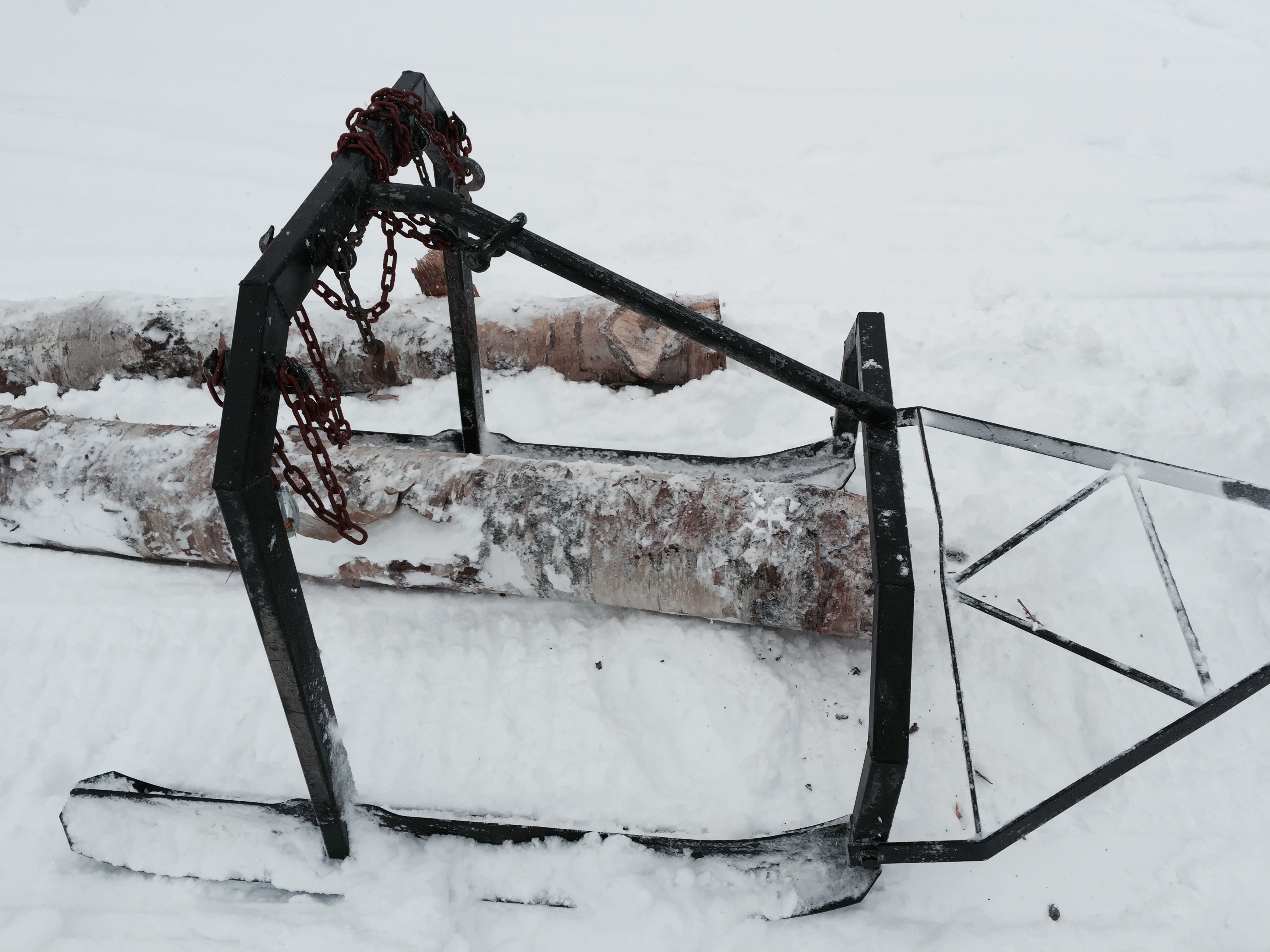

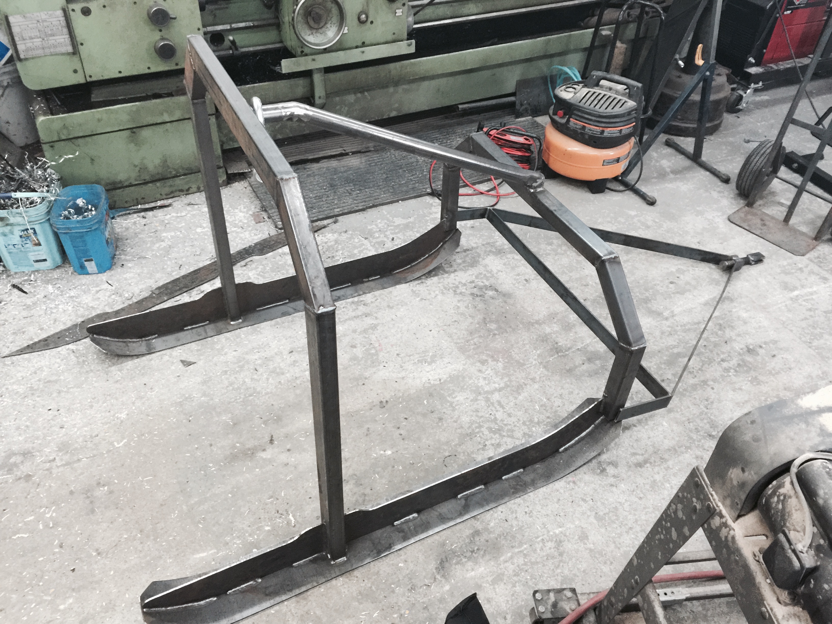

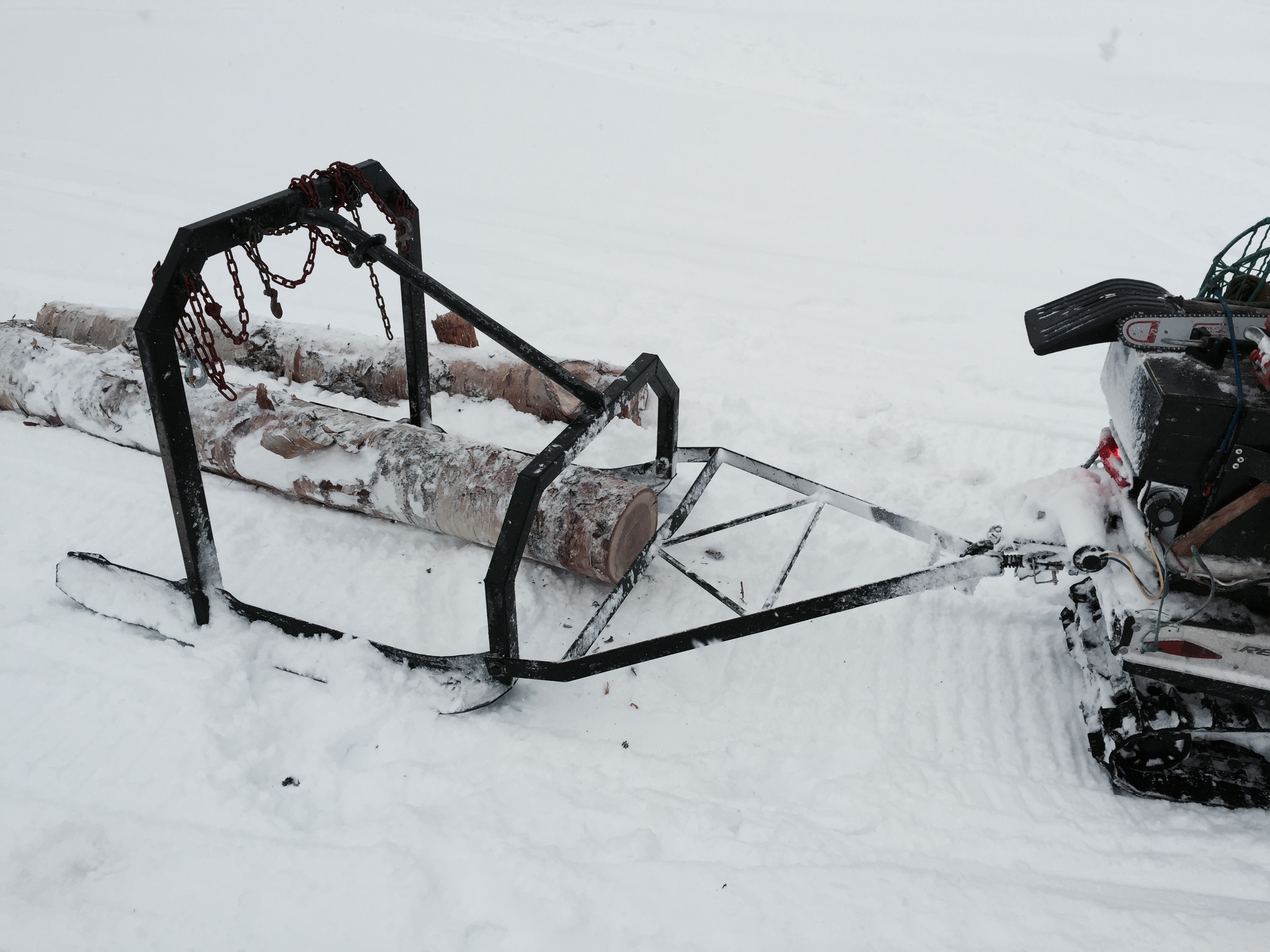

A few pictures of the arch I built to use behind the ski-doo.
