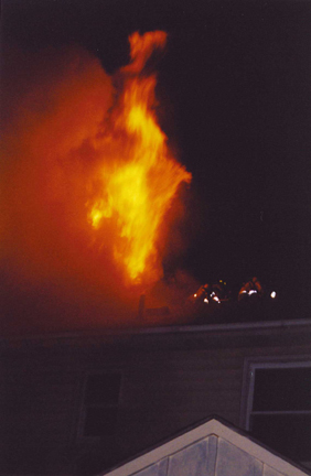

This has nothing to do with your question but as a firefighter I would suggest that you remove that plywood if it is not necessary. During a major fire, firefighters will cut a hole in the roof almost directly above the fire and break through the ceiling from above. This effectively creates a chimney effect that draws all the super heated fire gasses out of the structure. Plywood floors in attics and crawl spaces hinder these efforts to vent the fire up and out of a home in a controlled manner. The attached photo shows fire coming out of a hole that we cut. Just a thought /forums/images/graemlins/laugh.gif.

Thanks for that bit of wisdom, as to why the hole was cut above the fire. I had the notion that it was to burn the house down quicker, which it seems to do. But your reason makes more sense now that you mention it. I've never heard that one should avoid putting in an attic floor of plywood for that reason though.

Not to hi-jack this thread but you'd be surprised at how well a correctly placed vent hole can minimize damage to the structure. In the case of this particular photo; the fire started in a basement and self-vented out a window. It then burned up the outside of the house and burned through the soffit vents into the attic. Damage to the main living space of the home was minimal. It always amazes me how people do so much to protect their homes from water, both inside and out, but not do much to make their homes safer from fire. Like having bedrooms that cannot be easily reached by ladders because of landscaping or the lay of the land. Or having so much clutter around their furnace that they are almost impossible to get to. Don't get me started about candles or extension cords or smoking in bed... /forums/images/graemlins/blush.gif. Again, sorry to hi-jack this thread.
