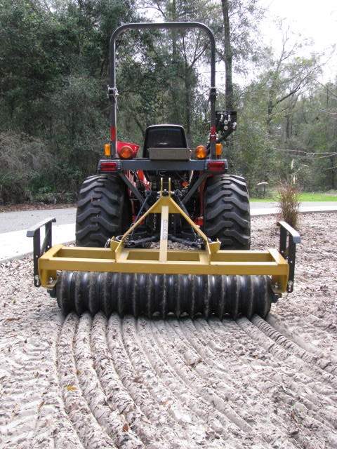

If you adjust the gang angles on your Disc Harrow to relatively minor angles, the DH will bury seeds less deep.
If you adjust your Top Link so 40% of the weight is on the front gangs, which throw dirt out and will leave seed on the surface, and 60% of weight on the rear gangs, which gather dirt in, covering the seeds, you should be good with bean size seeds, assuming you subsequently have 3/4" or more rain per week.
(Rear gang is wider than front gang.) (Longer Top Link transfers more DH weight to rear gangs.)
In addition, use the Three Point Hitch lever position control to just set the DH pans just into the soil surface.
Smaller seeds often require sunlight to germinate. Covered, small seed germination declines. Small seeds are best pressed into the surface of the soil, uncovered, with a Cultipacker. PHOTOS

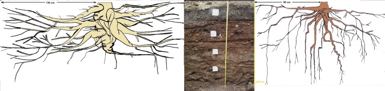

Canavalia is not usually grown for food, but is the best N-fixer. Castor and Moringa only amount to 2kg and 8kg respectively of the ~1500kg seed mix. They are mostly for texture and biodiversity. But this is what really convinced me to incorporate them into my mixture:
A study titled, Above- and below-ground biomass and allometry of Moringa oleifera and Ricinus communis grown in a compacted clayey soil
In short, they help improve compacted clay, which is common in the tropics on heavily grazed land. Here逞エ a cool image from the article. Not many studies actually go into this much detail about the root structures of different species. 90A8E102-95BA-4168-B4AD-A3CDB769351C.jpeg
The first two years of the propert development I will not be harvesting anything from the land. These years will be purely for soil improvement. This is a long term project with about 5,000 fruit tree saplings, and another 5,000 saplings of pioneer trees. The cover crop mixture is simply to help prepare the soil for proper development of the fruiting trees. As such the area will be 杜owed every 3-6months.
