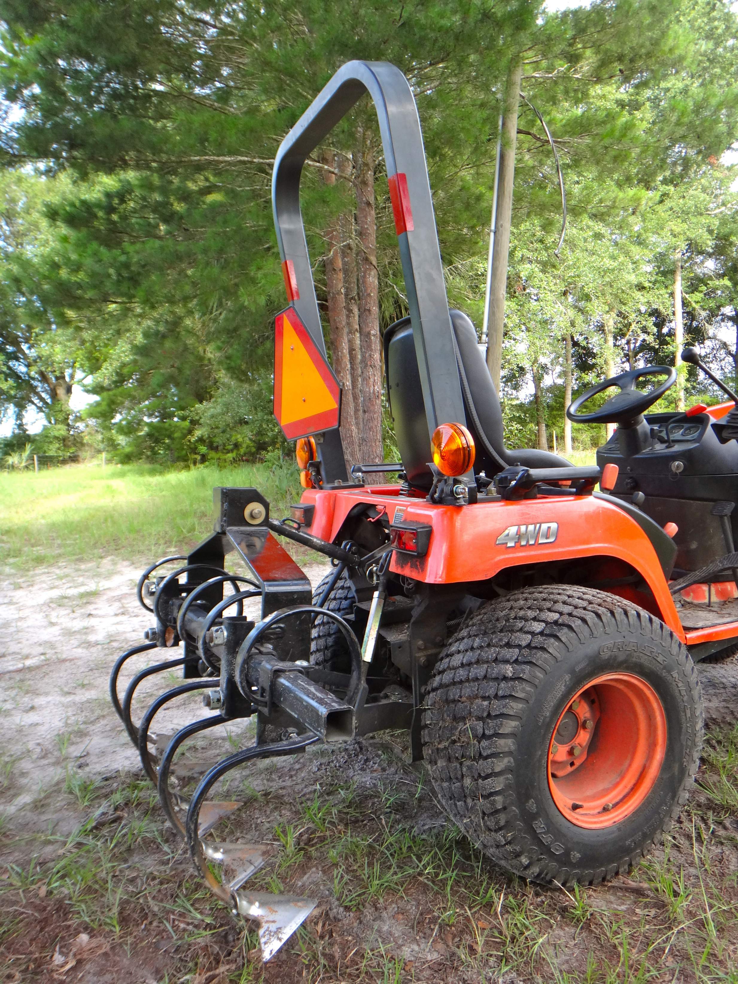

In your situation, how did you acquire a tractor without a front end loader? Consider adding a tractor FEL as your next implement purchase. Your back will thank you now, and years later when you are old, like me. Without an FEL, you will be improvising to laboriously and inefficiently complete tasks that would be relatively easy with a loader.
You have what most of us would consider the BASIC THREE implements: Rotary Cutter/Box Blade/Disc Harrow. I consider a Ratchet Rake bucket attachment the #4 basic. If you want your ground really, really, level a Chain Harrow after the Disc Harrow is excellent. Wingfield makes the best. Winfield's heavy 1/2" diameter mat wire is much more effective than 3/8".
VIDEO: ratchet rake - YouTube
LINK: 7' 2" 3pt MaxiLift Harrow
Grass seeds are fine. Grass seed need direct sun to germinate. If you drag, too much seed will be covered too deeply. Drags are for medium and large seeds.

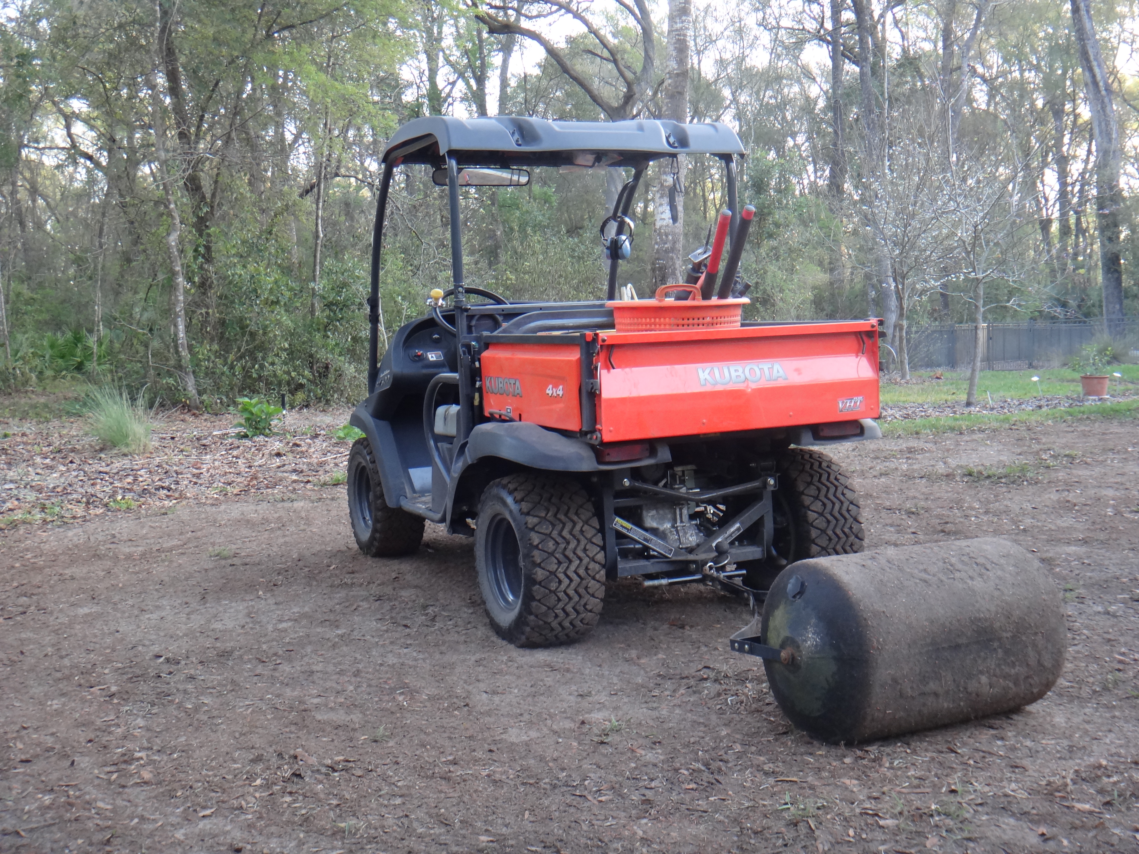

You will have better success if you buy a $300 poly lawn roller which will cover the area between tractor wheels. Roll before casting seed, roll again after casting seed. After last Fall use, empty roller of water. If you have a hard freeze with water in the roller, ice will split the seams. I have used the same roller for eight years.
The only picture I have show the poly roller behind my Kubota RTV500 but I pull it behind my Kubota L3560 too. I used a U-bolt to attach a ring, which goes over a trailer ball, to pull roller.

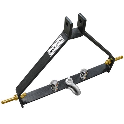

Mount a Handi-Hitch on your tractor Three Point Hitch.
After you plant, maintaining the grass seed consistently moist is crucial. If it drys out once, seed is history. I used 10' T-posts with pulsing sprinklers on top. Very wide coverage. Just need to keep seed moist; not wet deep.
These are cheap China sourced sprinklers. They should be better constructed then they are. If you buy six, five will work properly. Do not plan on having them oscillate. Plan for them to rotate 360 degrees. I do not recommend for semi-permanent installation, but for moistening lawn seed for five weeks they are good. These sprinklers are sold on-line too. If I could find the bases as separate components I would buy the bases and install high quality Rainbird (brand) sprinklers on top.

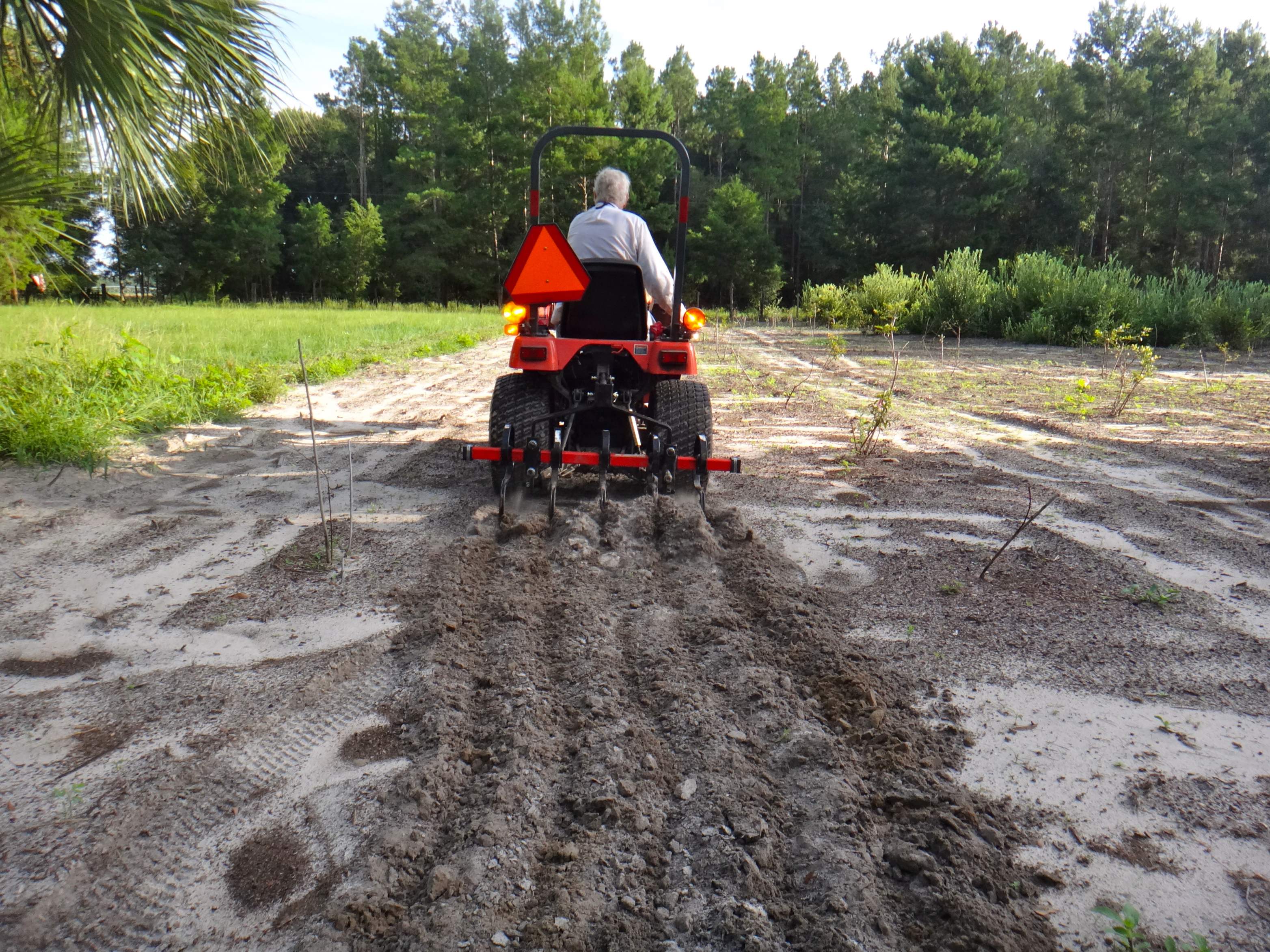

For your garden soil prep buy a tractor PTO-powered roto-tiller. You may also want a weed cultivator with adjustable tine width to straddle/cultivate your vegetable rows. Photo shows "Wunderbar" modular, tool-bar cultivator in expanded Blueberry patch.
LINKS (3): Groundwork T-Post Sprinkler - For Life Out Here

3 Point Handy Hitch for Kubota BX Trailer Compact Tractor Drawbar John Deere | eBay

Removing ruts under power line is the question I am asking. My original post was not clear on this point.
Box Blade for dragging earth to fill the lowest places.
Disc Harrow, moving fast, to chop high spots, then use a drag to move soil to lower area. A beam drag will do. Chain Harrow on a frame is better.
Always best to fill and level when soil is moist.
