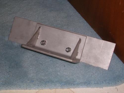

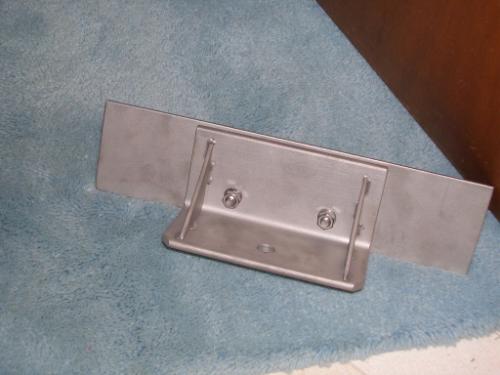

When I started thinking about getting a zero turn mower instead of a traditional tractor I quickly realized that the only drawback that I could find was that a zero turn would not accept my dethatcher and spreader attachments.
When I got the mower I noticed that there are two preexisting holes that I assume are for a bagger. I still wanted to use my attachments that I already have.
I had an attachment made that would allow me to use my old attachments. I realize that I will have to be careful while pulling the dethatcher so that I don't jackknife but I will be glad to have the functionality back.
The attachment is upside-down in the pictures BTW I have a ZRT 42. I will post pictures with it attached to the mower once I get the peice from the guy that made it for me.
http://photos.msn.com/Slideshow/Vie...GIGj!AUZES4co4X5!44CwlGDCBOlVUzynB1U$&index=1
The device is made up of two pieces. The first is a back plate that is 12" wide and made of 1/4" thick steel. It has two threaded rods protruding up that will fit through the two preexisting holes in the tractor.
The second piece fits over the threaded rods and the nuts hold them together. I made the back plate so large so that it would give some strength to the sheet metal of the tractors rear plate.
I didn't really look for very long but I didn't find anything like it out there. I thought that you would like to see what I had made.

David, Your attachment looks very solid. I think you shouldn't have any problems. The only attachments i have ever seen for a ZTR is a bagger. My neighbor has an Exmark and it is very nice. He can mow his 5 acre yard in 20 minutes or less! LOL I guess that can justify the $8000 he spent on it.
I was considering one too but I got a conventional GT. It's just more functional for my needs and for way less $$$.
Let us know how it works!
