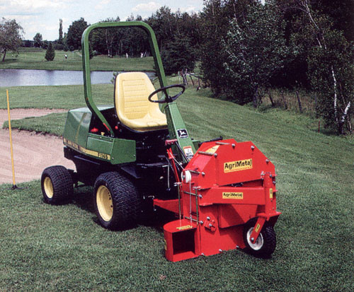

One attachment I HAVE seen but is not on this JD lit for whatever reason is the 76" Swept Spindle mower deck.... I've also attached a pic of the Agrimetal "Yard Blower"....
The attachments for these machines are funny....certain attachments are VERY common and others are apparently only used by Sasquatch... its not hard to find the 60 & 72" Side Discharge Decks, 47" Snowblowers, and 246 Brooms...but I've never even seen a picture of the Flail mower, If I did find the flail mower, I'd probably buy it just to say I've got the only one in North America LOL... i've not come across a 72" Rear Discharge Deck yet either. I'm guessing by "rotary mower" they mean a bush hog type mower...and If thats the case, I've never seen that one either.
