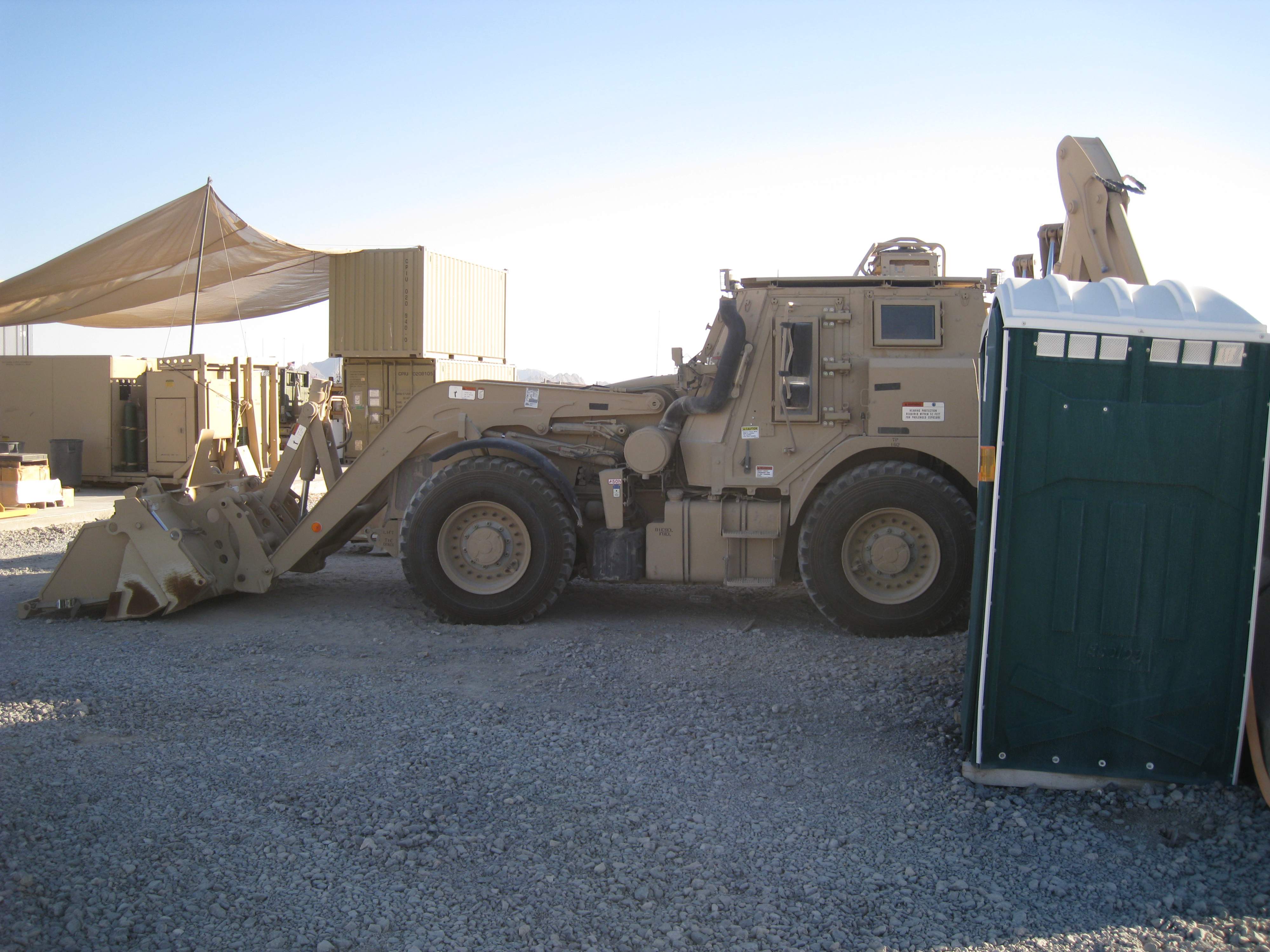

Ok, so as promised, here's a pic. Before anybody asks, I have no idea what brand of machine it is underneath all the armor, and no I don't get to play with it either. The armor is to protect the operator from snipers, who have a nasty habit of trying to do anything they can to prevent our day to day operations from going smoothly. The tires are loaded, but only to keep bullets from flattening them. Not really needed for extra weight.
