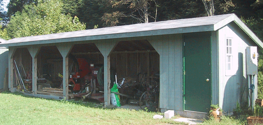

Here's what I build a few years ago:
Certainly make it tall enough to back the tractor in with the ROPS up, but I don't see any need to get the tractor all the way to the front. The only issue I have with height is getting my chipper in - the stack on the blower is tight. No need to go as high as 8 ft. unless your tractor is that tall.
There's no issue with leaving the front open structurally if you build it solid. We regularly get winds over 70 mph in the winter and have never seen an issue. However having it open does let leaves an other debris accumulate, which makes it more difficult to roll the implement dollies around.
If you make it deep enough to get more than one implement in a bay, and even if you don't, you need dollies to roll the equipment around to make good use of the floor space.

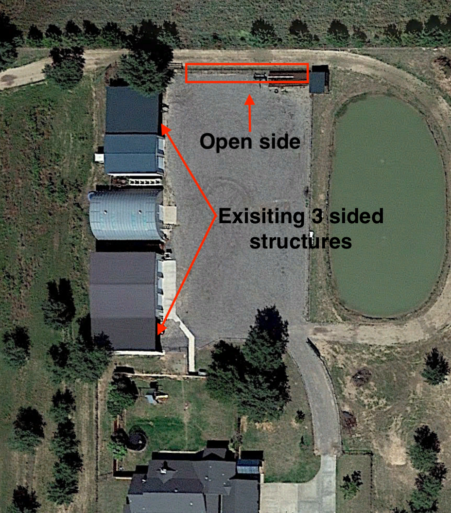

I already have two larger three sided structures. One it 25x50x13' and the other 36x40x11'. No issues with wind. The other two open to the east and the new proposed one will open to the south. Most our storms come from the north or west. Everything is built of steel beams and R panels.
Here is a picture of where it would be built. It can't be any deeper or it would block the road to the north or block the entry to the existing building to the south. Running out of room and no where else to put the thing.

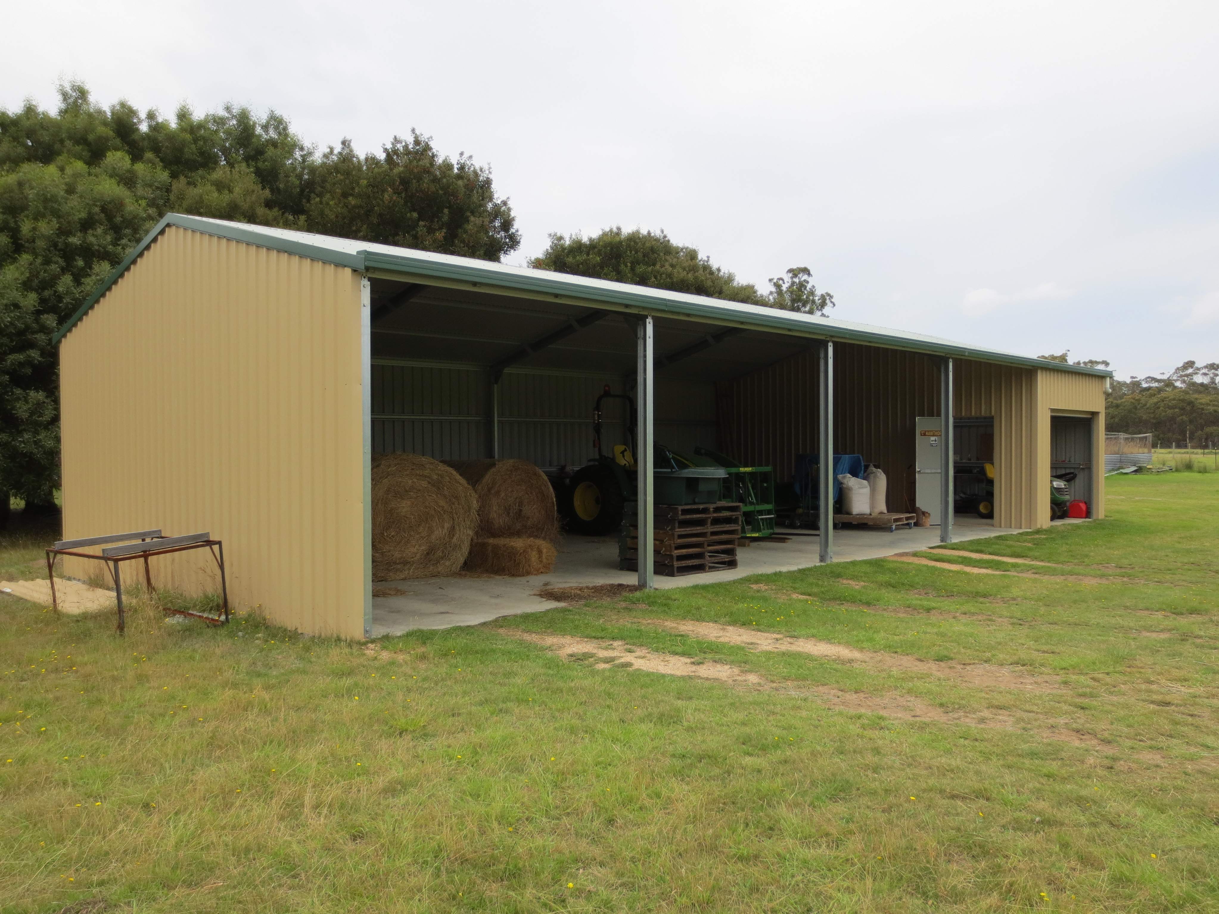

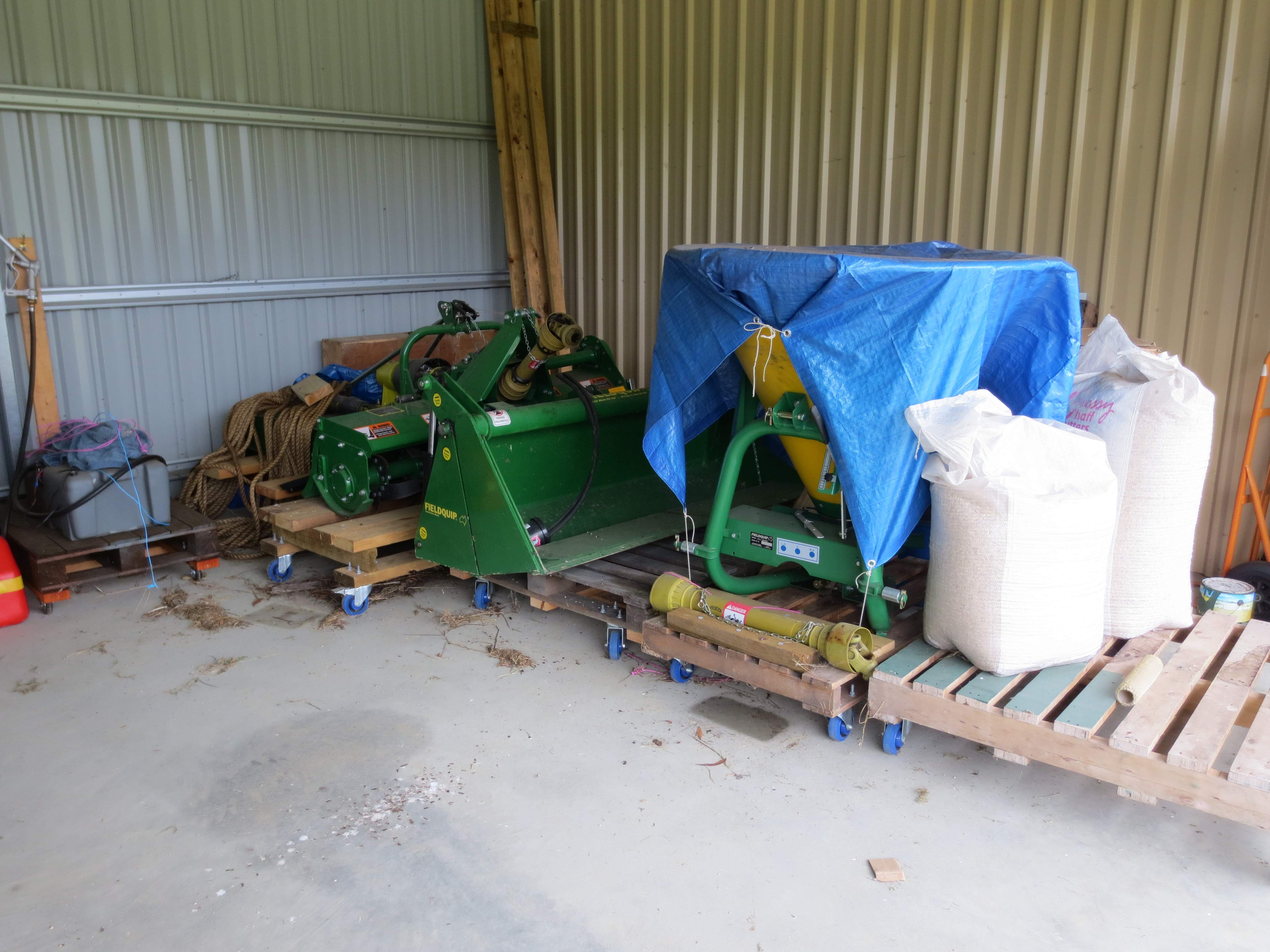

Suit yourself... but a concrete floor (along with your implements on dollies) will maximise the number of implements that you can store in a single bay. In the first picture (below) there's a slasher, then a tiller, the 4-in1 bucket and a fertiliser spreader... all 'scrunched' together, yet easily accessible.
Also, putting in a concrete floor before building the shed is less expensive (and less of a hassle) than doing it after the fact.
