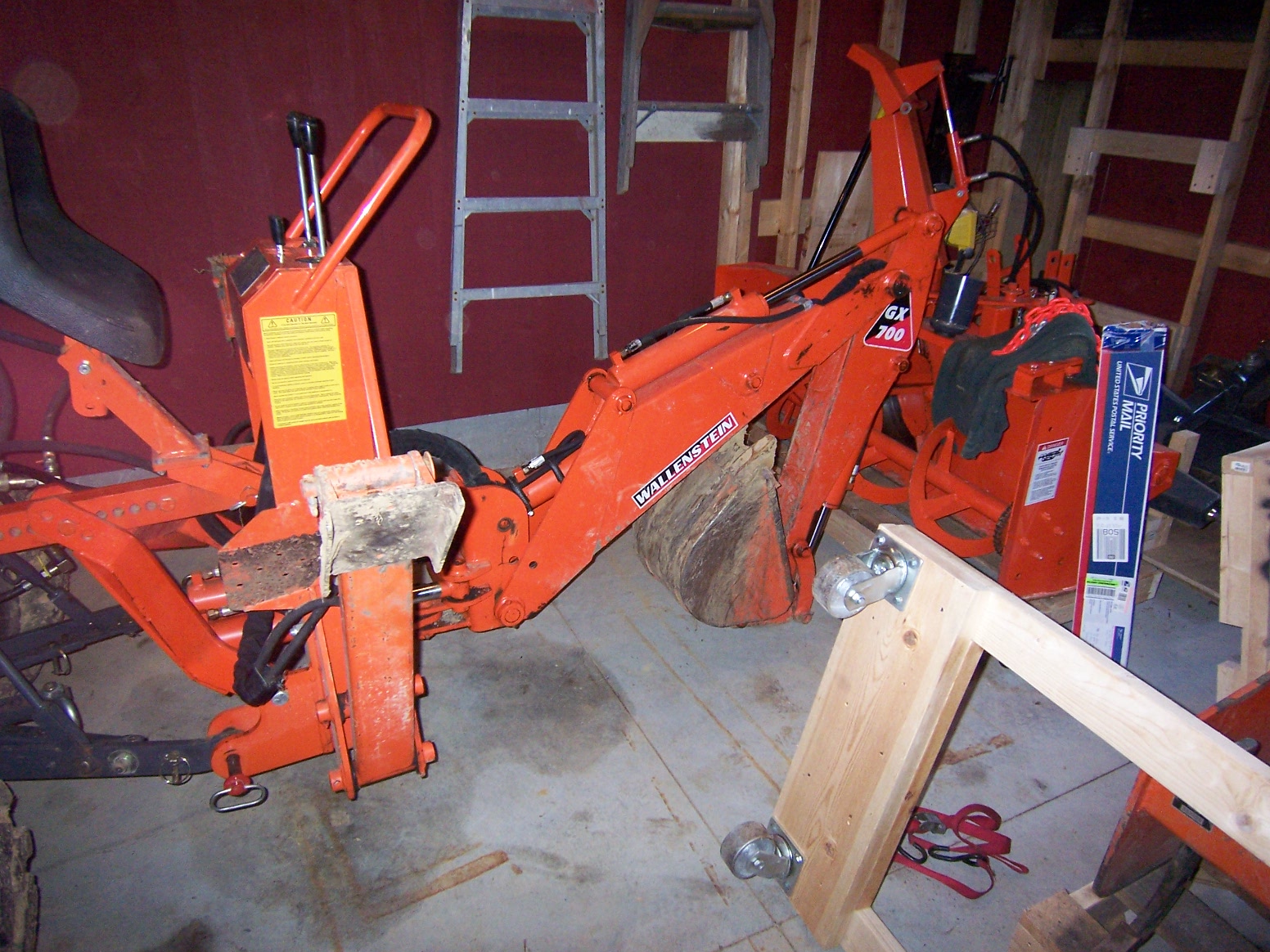

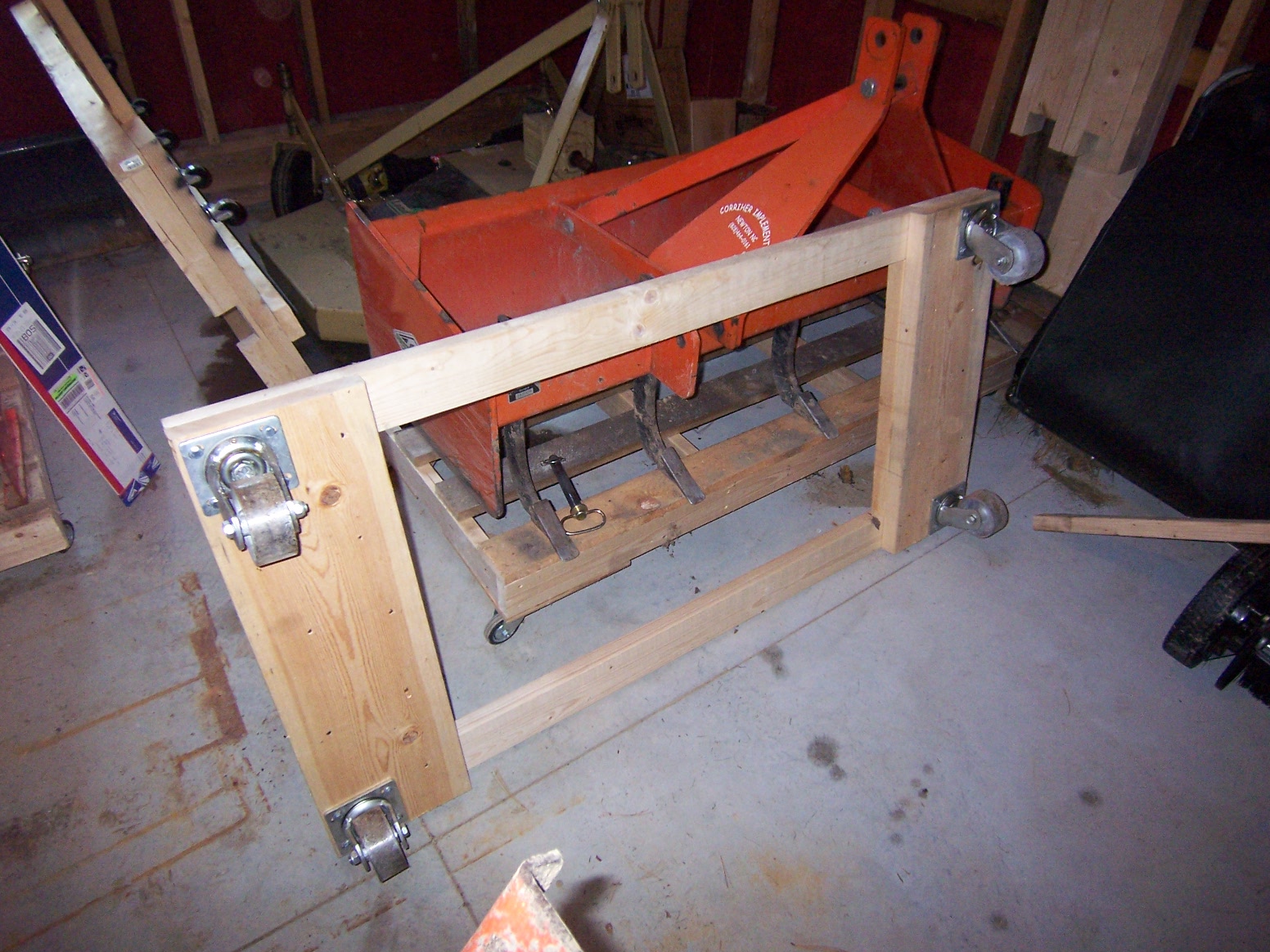

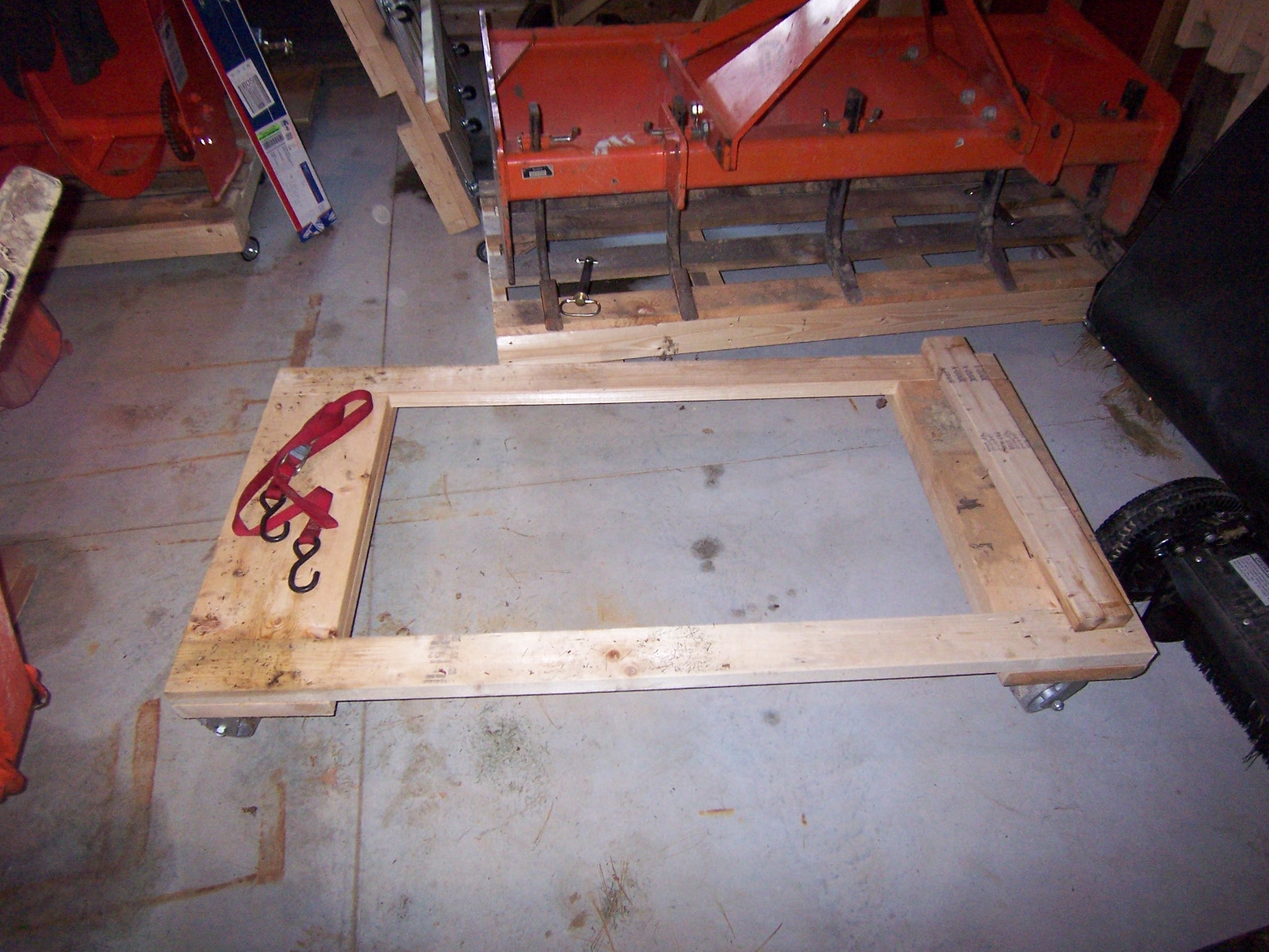

The slickest answer to this problem is a 'dolly' that supports both stabilizers and the bucket. Then you just wheel the 'hoe' into the tractor, adjust for hight with the hydraulics and away you go! It would work for mounting and dis-mounting.
EanJay
   / ATTACHING THE BACKHOE #7
I used to fight my backhoe going on big time. I hated putting it off and on, hated it to the point that I would let backhoe jobs build up, put in on for a couple of weekends, then take it off for several months. Then I built a custom dolly. OMG, you can't imagine how much easier it is. What used to take 30-45 minutes of swearing, re-positioning the tractor, swearing, trying to force it around, swearing, getting it part way on, swearing, you get the idea. I now get it on in 5 minutes or so and it is super easy, never even a frown, no bad words. Build a dolly on casters, it will change your outlook on your backhoe.

You dont happen to have a picture of that dolly you could posted.Sounds to me this will solve my problem if this works am going to promote you to 8562
   / ATTACHING THE BACKHOE #9
I can get you one tomorrow. My backhoe is on the tractor right now, so it should be no problem.
   / ATTACHING THE BACKHOE #10
It's not very complicated, but it sure works well, and it's built rugged. Basically, I just slide it under the backhoe and set one end under the frame, and the other under the bucket. I then use the dipper hydraulics to take the weight off and it's free. I use the red tie-down in one of the photos to run between the stabalizers to make sure they don't leak down. The real beauty is in putting it on. With all the weight on rollers, you can push it to exactly the spot it is needed. Believe it or not, it can be pushed with one hand. Here are the photos.
