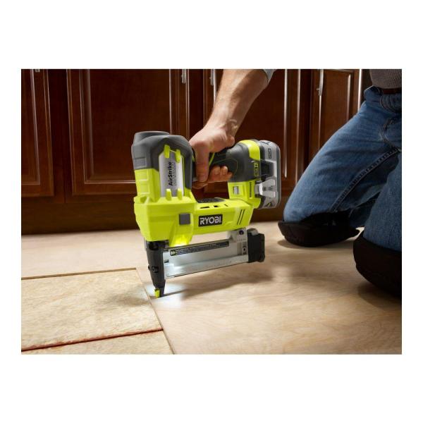

Daughter has a pasture already fenced with conventional horizontal boards. They want to enclose it with wire fencing.
Driving staples by hand would be extremely difficult.Been looking at alternative methods, but what might be a minimum size staple one could use Most staple guns only can handle a thin staple. Other alternatives to fastening this? No large animals, just small goats. The standing fence posts are 30 years old, so would there be a problem with galvanized staples?

Unless you have a physical limitation 800' is nothing.
There are air powered nailers just for fence but are priced more for fencing companies or large farms. $$$

What about holding the staple with needle nose pliers and using a cordless palm nailer?
