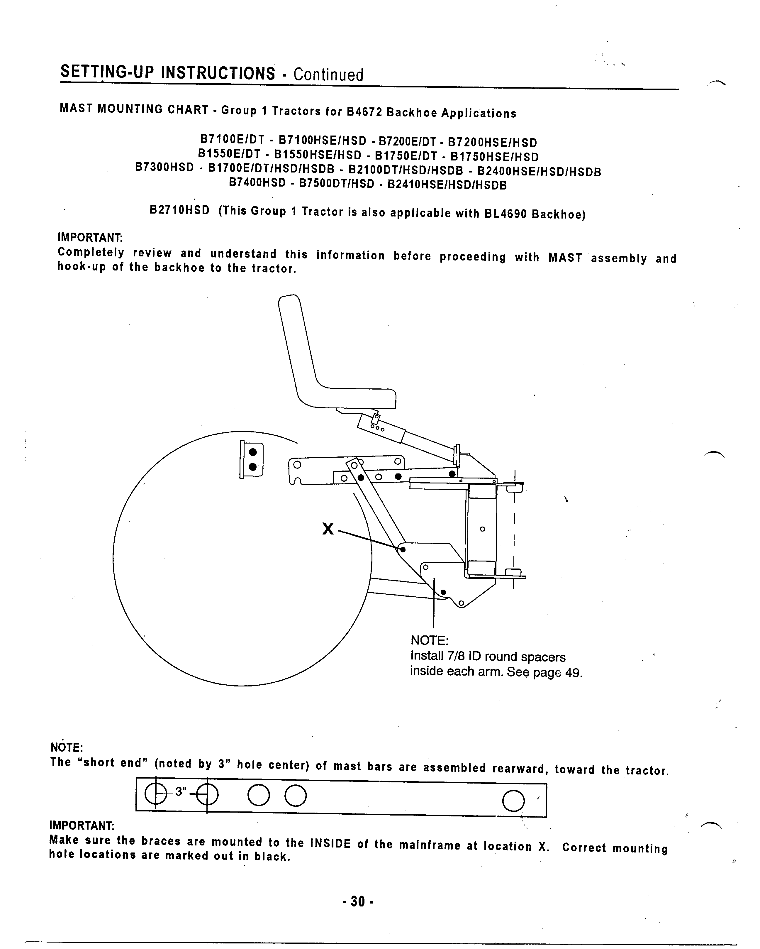

I recently purchased a used Kubota B2410 (only 60 hours on it). I also purchased a new Kubota backhoe that the dealer installed. I had the dealer remove it upon arrival so I could use the belly mower. I now want to use the backhoe but cannot get it installed. I can get all points attached until it gets to the final point which is the top pin on the stabilizer bar. The pin seems too long to fit between the top arms of the 3 point hitch and the center attachment connection and I cannot seem to adjust the arms to a point where they are above or below the pin enough to fit it in. Help

You might also find it hasn't been rigged correctly. There are lotsof bolt holes and positions for the BH frame and it needs to be right. I had this problem with my 2910 as did someone else, and it turned out the frame wasn't set up correctly. I found the diagram in teh manual was actually wrong for the 2910, but I think it works for the 2710, with the difference being the telescoping draw bars on the 2910.
I'm attaching the manual page with the setup drawing. Can't say if it will make things better or not, but this is how Kubota says to set it up.
Even when set up correctly, it can be tricky to get it on. Good luck
Peter
