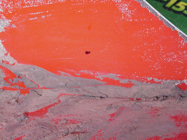

After many weeks of waiting for my dealer/saleperson getting the CORRECT size of toothbar for my BX23, I finally got the right one. What can I use to drill a hole fore the mounting bolts? Or what is the best way to mount it?
/ Attaching a toothbar #2
If it is a large hole use a hole saw. Cuts the bucket real fast and easy. Mine is bolted on with 1" bolts. The hole saw made sort work of making those two holes.
/ Attaching a toothbar #3
Go to your local hardware store and purchase a bi-metal hole saw (its usually white) the proper size for the bolts you will be using. Loader bucket sides are fairly soft metal and the bi-metal hole saw will go thru it like a hot knife thru butter. Installation time should take about 10 minutes.
Well thanks to all the TBNers that offered all kind of assistance in this VERY EASY task of attaching the toothbar!
Here is the first of three photos that I took while completing this task.
This one is marking the holes...
