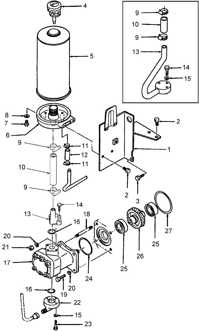

I looked up the 1920 power steering online. The reservoir is identical to mine. It's a reservoir and filter combined. You have to replace the whole thing. The part number is SBA360101470 and is about $106, very expensive. Here is a diagram that shows it, item #5.
Ouch! I'll see what my friend wants to do. We'll probably just roll with the ATF. What site did you obtain this schematic?

The diagram is from the "parts" section of messicks.com. Click on the New Holland emblem and then type in 1920 in the model number block. Select and search for the 1920 and then pick the front axle and steering section. Expand that section and look for the power steering pump sub-section.
