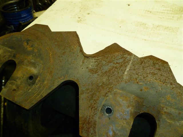

Problems,
Here is how the end of the axle shaft look where it supports the bogie after 2300 hrs.
Now, one can flip them over to get a second run out of them but the bogies and lockplates need rebuilding to make it last as the shaft contact surfaces are no longer straight and the shaft can still roll back and forth in the worn out slots.
The bogie side plates are only 3/8" thick,not thick enough where it supports the axle and not beefy enough where it is welded to the torsion shaft IMO,cause they do break loose there.I got several that where rewelded or cracked and a couple broke off ones as you can see in the pic.

Bison, interesting, thanks for the pics. I can't quite tell what the third picture is showing. It will be interesting to see what I find when I take things apart on my machine with 1800 hours. I'm glad to have found you here since you are definitely someone who's been there and seen these parts. Not sure when I will tear into the job. Might not be for a week or two yet.
   / ASV Undercarriage design 4500/4810 #5
Third pic is the axle shaft pocket in the bogie that supports the down pressure on the axle.It wears out of true (look at the shaft pic),when one flips the shaft it tends to support only a fraction of the shaft and it's gonna be shortlived if one does not pay attention to it( weld back up and file/grind flush).

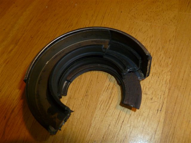

Here is a couple pics of a original axle seal cut in half.
When i had it cut in half i found all the spaces in and between the seals solid packed with dirt(to put it mildly, a very poor design at best)
It was the reason i put a sealed brg in and packed the cavity between the seal an the brg with grease in the hope to keep the dirt from the bearing as long as possible.
there are 2 common spring loaded double lip oil seals side by side( and a single thin dust seal washer(lip facing the world) in a single steel rubber coated housing.
The seals ride on a steel sleeve with a rubber coating on the inside(the sleeve has an intererence fit on the shaft)
The total seal is 1" thick and acts as a spacer between the brg and the end cap as well.
I have not been able to find an after market seal to take its place.
I dont think a common oil seal(even doubled up) will last very long in the environment it has to work in on these machines.

Again thanks Bison more good info that might help me. These pics are interesting. One of the ideas I had was replacing whatever was in my machine with a pair of lip seals. I've done this on other shaft seal designs and they will last more than twice as long as a single seal although I've never done that on something in this type of environment. I would also use your idea of installing a bearing with seal and filling with grease. How many hours did your machine go before the factory seals started going bad? From things I have read I believed that your machine had several design changes influenced by CAT and I thought I read that axle seals was one of those changes. Apparently not. I read somewhere that CAT uses something called Duocone seals that are essentially metal face seals, no rubber parts involved other than static o-ring seals that seal against the housing on the outside and the shaft on the inside. The moving parts are metal against metal face seals. I also read somewhere where someone claimed you could replace some of the ASV seals with Duocone. I'm not sure which machines this might apply to however. I hope to start working on my machine soon and it will help to find out what I have in my machine. Oh, BTW, are there any markings on the seals or outer cartridge that might indicate who made these seals?
