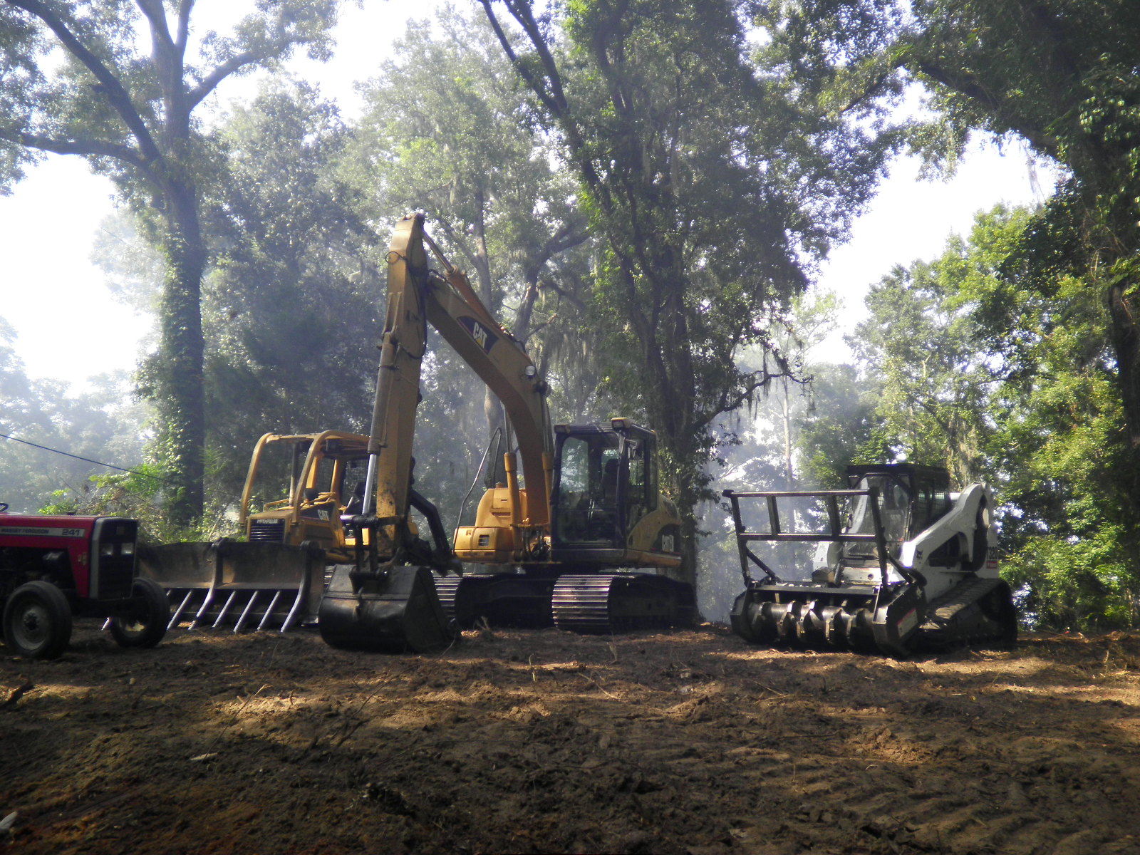

   / ASV RC100 operating temperature? #5
These are the guys I was working with all week.
The thick vegetation I mulched was as high as the cat 312 exc.
The d5 cat did the grade work while the 312 piled the big trees and stumps.
I'm on the right of course.
The steep hill goes down behind us about 250 yards.
