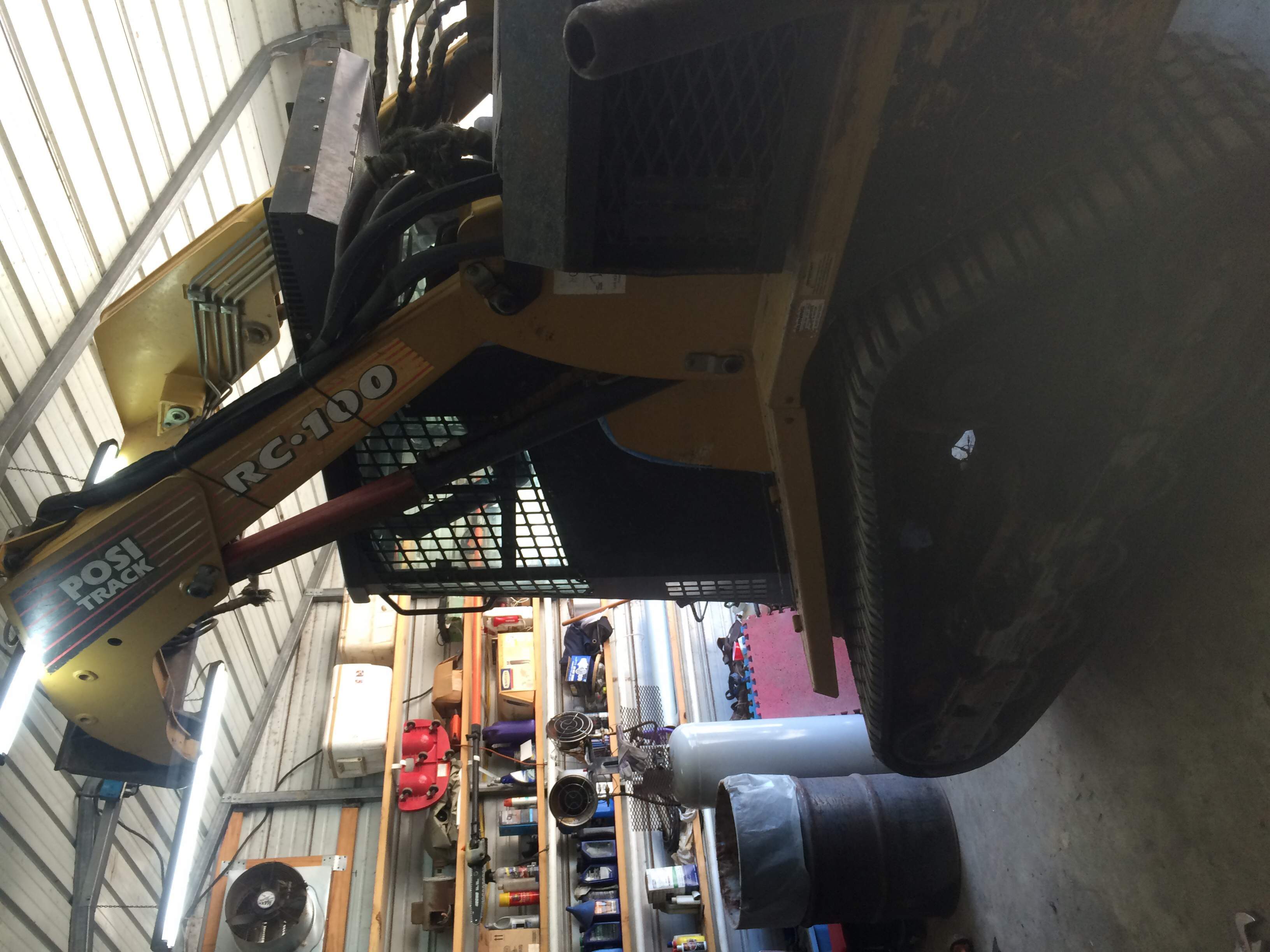

Lots of them but it depends on the model # if it's a PT100F then should have one of the best AC's made. We have been retrofitting the RC100's with better AC unit for 4 years now.
   / ASV PT 100 AC #5
No the unit off of the SR/PT 80 you have to compromise the rops certification but it's the best AC out there.
   / ASV PT 100 AC #6
I took the fans that were on top and flipped it upside down behind the cab. Seems to work better and the fans or protected. image.jpg
