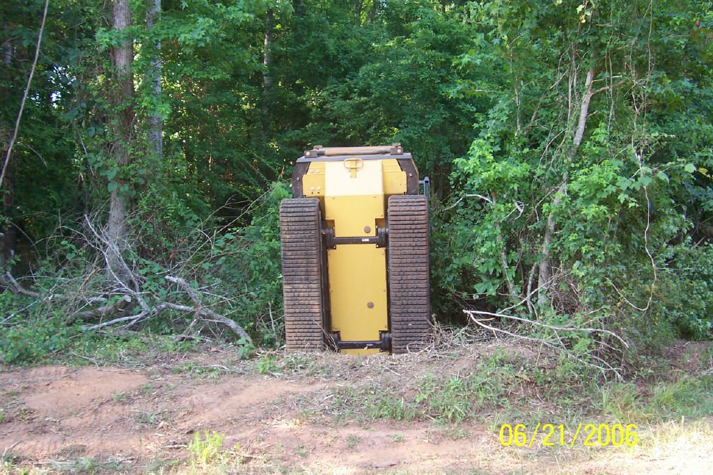

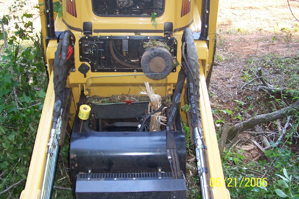

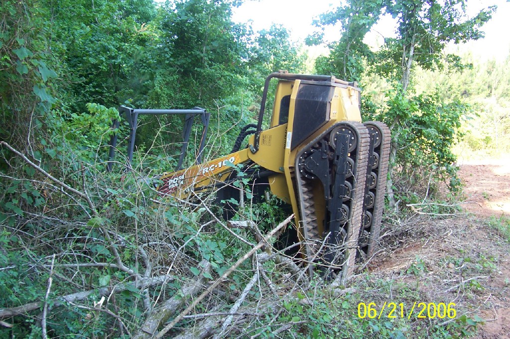

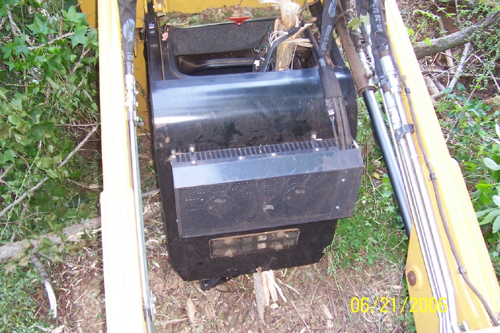

This is the end result of inexperience, a one ton head, and a two foot ditch. Gravity helped too! It was no fun climbing out the VERY SMALL back window! 100_10201.jpg

Robbie, nice to hear that you were able to crawl out the window and leave the ROPS cage with nothing injured more than your pride.

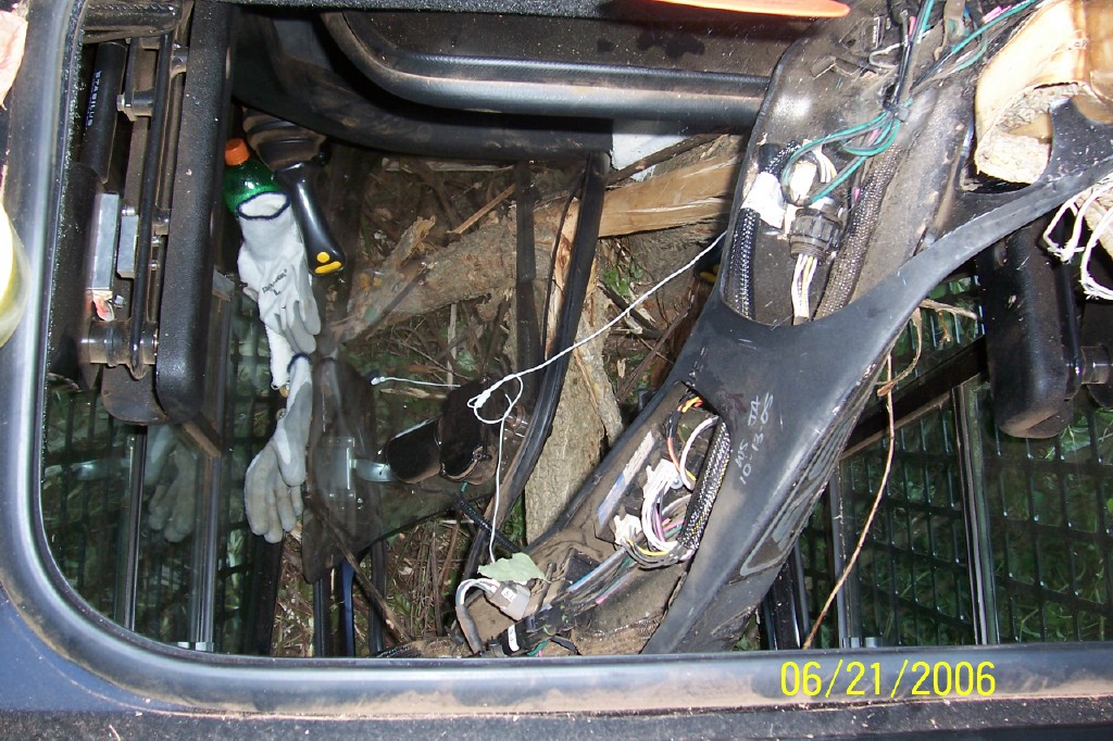

Thanks, me too. It would have been much less eventful without the tree through the front window. With no tree I could have simply raised the lap bar and crawled out. But when the tree came in it pinned the lap bar in the down position, so I was trapped for a couple of minutes. I was able to wiggle out from under it and out the window.
As far as the rops I have thought of adding saftey features, definitely not removing. I hope no one makes the mistake I did, they would think twice after it happened to them though. It doesn't take long for things to go south!!!
But to ASV's credit all we did was pull her down onto the tracks, bleed the front two cylinders and start it up. When then drove it out and onto the low boy and to the shop. It took a week and 6000$ to fix.

If posting can help somone avoid this happening to them than I'm glad I could help. Yes that's what insurance is for.
I was pretty upset with myself for letting that happen. But you live and learn. I keep God busy looking out for me. I'm trying to give him a break these days.
The lesson here is unless you are on completely level ground keep the head atleast two feet from the ground. It will and can pull you over. Proofs in the pictures, right? Robbie

Glad you're safe, if your ROPS had been shortened 10", that stick would have went over the top instead of coming through the front, I'd be breakin out the sawzall.:rolleyes:
