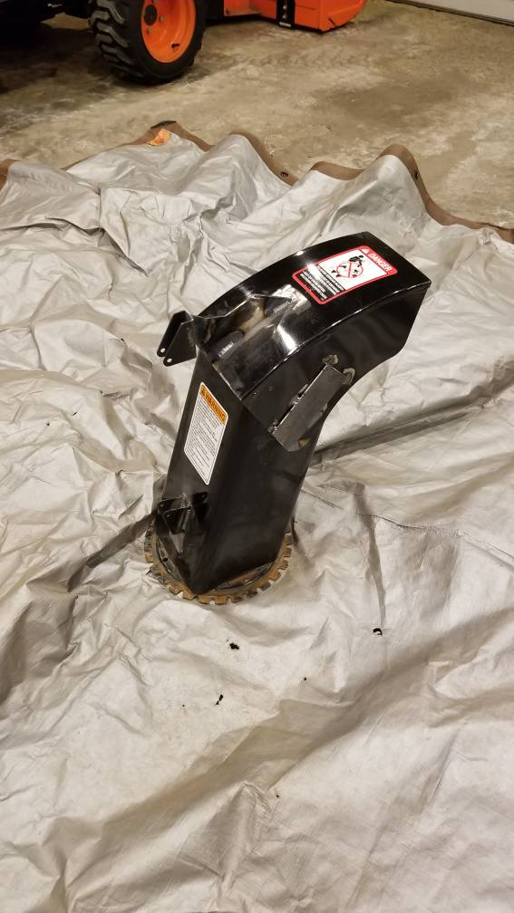

I have a bx25 with a front mount snowblower.
It's been one of the most amazing attachments but it has its flaws.
I currently run an electric window motor which handles rotation. I blow fuses and it's not designed for the elements. During some storms it stops working intermittently and that's very inconvenient.
I run a 6 inch linear actuator for the deflector. It also runs into issues even though it is rated to be waterproof.
I have a 3rd function valve for my grapple which is useless during the winter.
My dream: all hyraulics
Control the lift/drop with my joystick (already exists)
Control chute rotation with left/right of joystick
Control deflector with grapply buttons open/close
Would anyone know how to accomplish this?
I know I need the hydraulic lines, a small piston for the deflector. I don't know what sort of motor to use for the chute rotation.
Do I need any sort of check valves or limiters?
Pics of what I currently have set upView attachment 715225

For chute rotation, a motor, chain and sprockets are nice with continuous rotation, but a simple cylinder and some cables may be a much simpler fab job.

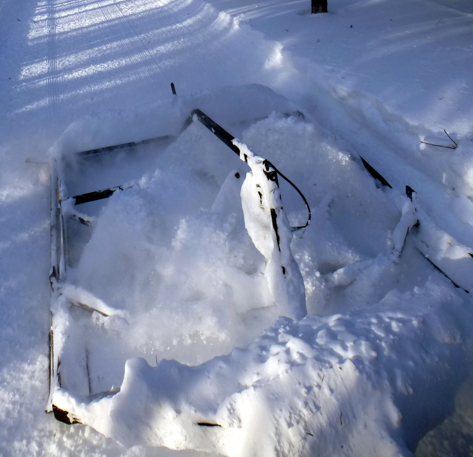

Linear actuator's are commonly rated as "IP 68 waterproof" but that's not really much. Seems they spray some water on them and call it certified. Having said that, I've used them for years and many versions of them while working in the snow. If properly installed (shaft down) they do reasonably well. The wire in this photo's center goes to a actuator. Its been in service on this implement for about 8 years today and it still goes. Its stored outside.

Most of the snow blowers I've seen have a cable and arm assembly to rotate the chute with a small cylinder. If you want to run it with a hydraulic motor you'll want an orbital motor. Char-lynn are my preference. Size the motor based on hydraulic flow and how fast you want the chute to move.
It's technically not ideal to run a motor off a cylinder valve, but it shouldn't be an issue for this application.
As to limits and check valves, they won't be. Required. Just make sure the travel of the cylinder is short enough that it can't break anything at either end of its stroke. Because attached to a flimsy snow blower chute, it WILL break something if the chute hits the end of travel.

Id be inclined to make chute rotation with a direct linkage and cylinder. No chains or cables or motors. Similar to how a rear blade angles. Might have to get a little more complex if you cannot design something with enough rotation for your linking. Look at a mini excavator bucket or even the loaders on some of our tractors for example. Same principal. And 180 degrees of rotation should be doable.
