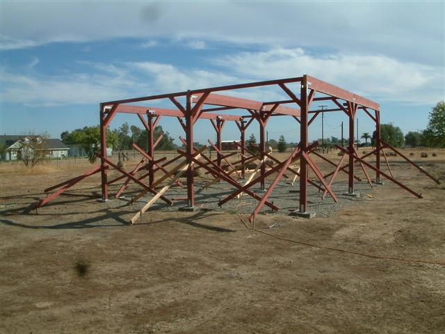

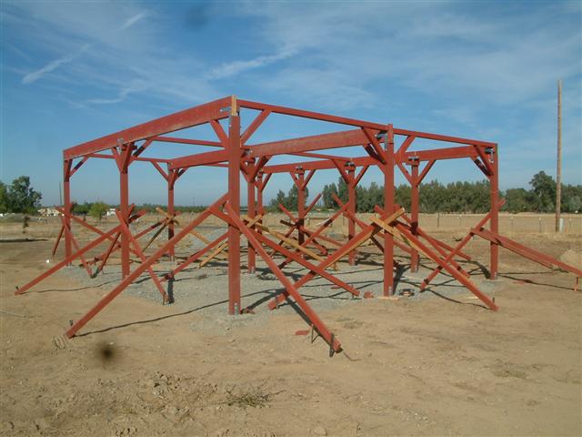

I used doubled construction-grade 2x12s (glued and nailed) to span 14-ft between posts on the equipment shed I built a few years ago.
Also, used a lot of Simpson hardware to tie the components together.
Good luck
