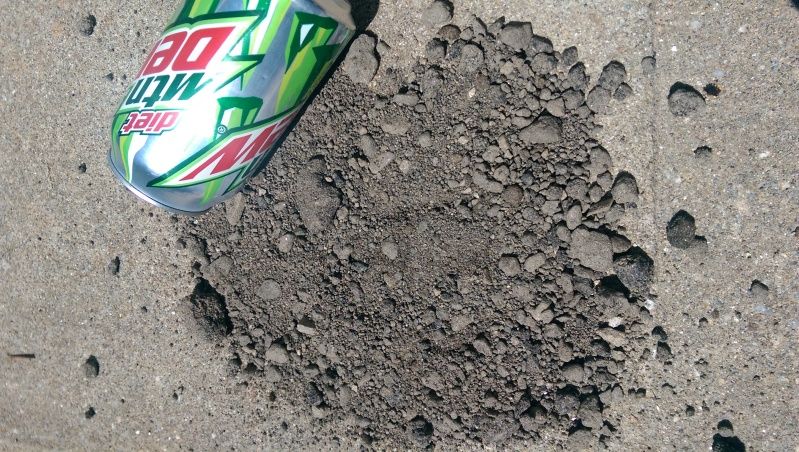

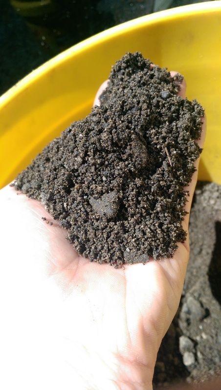

OK,
Here are some pictures of the actual material.
More in the album. Driveway Photos by tastyratz | Photobucket
in my hand, and this has some moisture content darkening it:
poured out on top of my garage concrete apron:

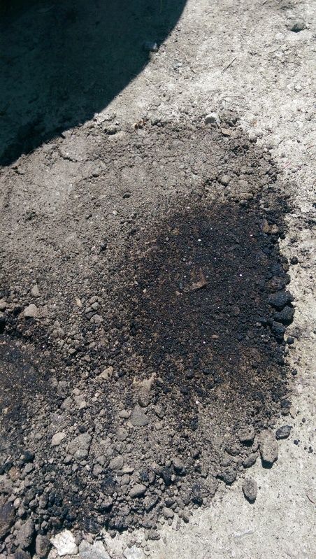

Here I poured some out onto my crusher run driveway and rolled over it a couple times with my car. Then I hit it with my blowtorch and did some hand tamping to see how much bitumen remained and how hard it got.
Looks like it got pretty black pretty quick?
What do you guys think?

IMG_0420.jpgIMG_0419.jpgIMO, asphalt "MILLINGS" should have no dirt. If this guy says he is getting it off driveway jobs I would be a skeptic- he is using a reclamer, not a milling machine. A milling machine is about a 700,000 piece of equipment that does just that- it grinds an inch or two off the surface-although they can do much more. end result is you get fines, certainly under an inch- occasionally machije will ripmup a bigger chunk. Good stuff will look moist-in particular when it is exposed to sunlight. I have a fair amount of experience with the stuff- did about 37 trailer dump loads at our fairgrounds. Also my own driveway about two years ago-has held up very well. Used a small Vib roller (rear rubber tire drive) which is key. Also you want toput it down on a hot day or for sure with good sun.

I'm no expert with this stuff, but it looks too sandy and dry.
