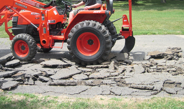

I tried to pull mine up with my loader and tooth bar first but it was coming up in huge sheets and they were annoying to break up and get in the loader. Then, I ran my subsoiler through it on a 96° day in full sun. It went through like butter. Anyway, for me, once it was broken up, it was just a matter of loading it into the dumpster. Went quick.
I'd think I could have done mine with a BX with a subsoiler on a really hot day but I it probably has a lot to do with the temp., condition of the asphalt, and thickness. Mine was probably only 2 inches thick and pretty beat.
