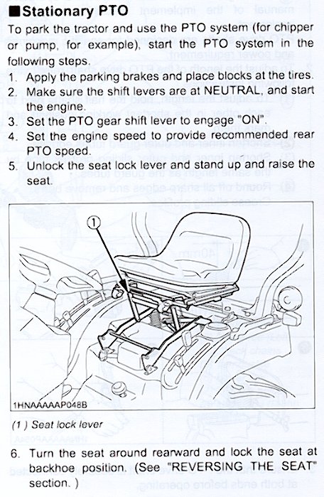

Escavader,
I believe there is a procedure in your manual on how to run the PTO while off the machine. I think it is get off with PTO disenganged and motor running. Then tip seat forward then start PTO, but I may be wrong as I don't have a one. Just going from memory on some post I once read.
In any event it sounds like you have a real nice piece of equipment there well two I guess with the Bota /forums/images/graemlins/grin.gif
Looking forward to the pics.
/ AS REQUESTED:BX-23/SALSCO 600 TESTING #4
This is why you had some problems with your PTO... you have to turn the seat.
I'm looking forward to see those pics. /forums/images/graemlins/smile.gif /forums/images/graemlins/smile.gif
thanks ill give it a try,didnt want to haul shingle around anyway. still raining cats and dogs.pictures to follow

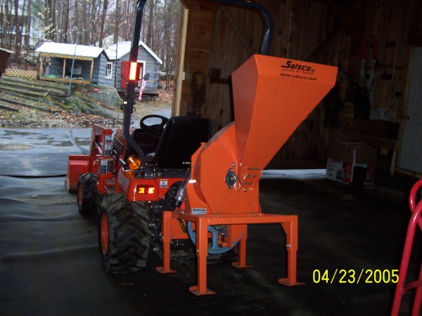

rain rain go away

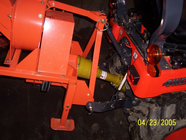

come again another day...

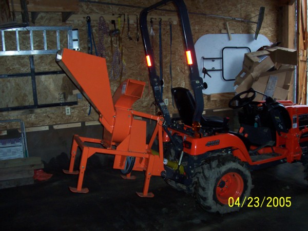

little bota wants to play....
/ AS REQUESTED:BX-23/SALSCO 600 TESTING #9
Wow... nice rig as I said when you brought it home.
I'm looking forward to see a pic of that baby in action.
Rain, rain, rain... all day today.
It looks right at its place behind your BX. /forums/images/graemlins/smile.gif
Have fun /forums/images/graemlins/wink.gif
#13
CHRIS,
I think that would be a nice idea.i had a heck of a time hooking and aligning it to the tractor-it drags hard even on a cement floor.my only concern would be the wheels in the dirt when you set it down.whay im going to do is put my snowmobile dolly wheels under it to roll it to the back corner of the garage.only problem is i only got 3,got to pick up another,or make one.if you make wheels for it,id be able to unhook them easy to use in the woods-mabey drill holes in the feet and use heavy caster wheels ,you can pull right out,before you set it down.I THINK I JUST TALKED MYSELF INTO IT.
i ain t going to get a chance for a few days to try the salsco again,back to the weekly grind dont you know,when i do ill be sure to post a report and pics.after my quick trial i got an awful good feeling about this chipper.
ESCAVADER
/ AS REQUESTED:BX-23/SALSCO 600 TESTING #14
Escavader,
Maybe all you need is a dolly larger enough to set the unit down on.
You may have to adjust the legs up to put it on the dolly.
Dollies are the only way to move these things around without killing yourself...
I built some low ones... But each wheel would only carry 50 lbs...
You need wheels that can handle over 100 lbs each...
Regards,
Chris
