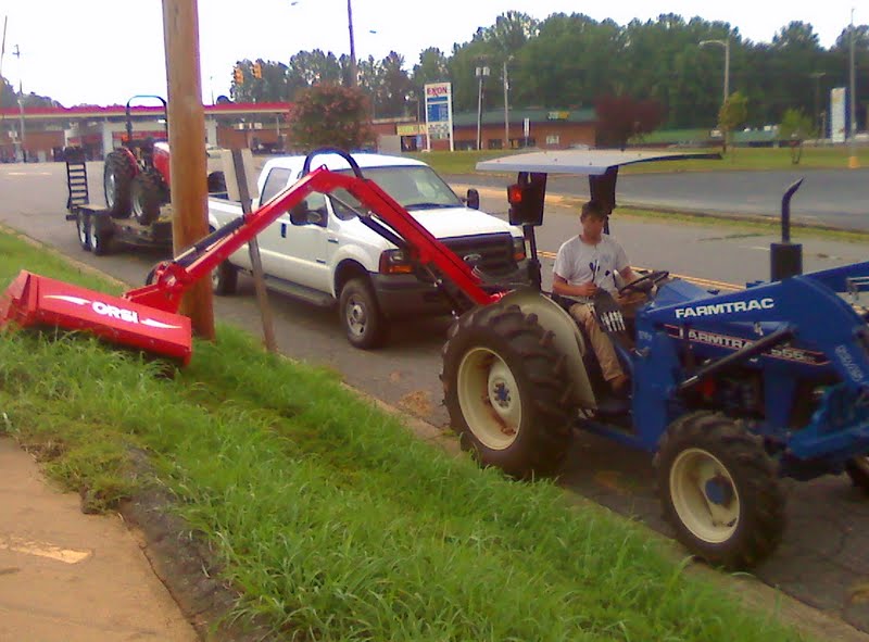

Orsi River Compact 355/420. Goes on the three point, is powered by hydraulics and ran from it's own pump on the PTO. It's like a backhoe arm that goes off the right side of the tractor and has a good bit of counterweight built in. I have been shopping around and spoken with most of the manufacturers of these types of boom mowers, all tell me the horsepower requirements specified are spec'd high to ensure the buyers have a heavy enough tractor to stabilize any additional forces beyond typical operation.
Matt at ORSI told me they don't sell as many 355s (12' reach) and at the time he had one ready to go for $9500 and several 420s (14' reach) ready to go for $10,400
I've been told the Bush Hog branded boom mower was the best in the business, but it's quite a bit more expensive and has higher requirements. Their comparable model would be RMB1445-1 if you're interested in it.
