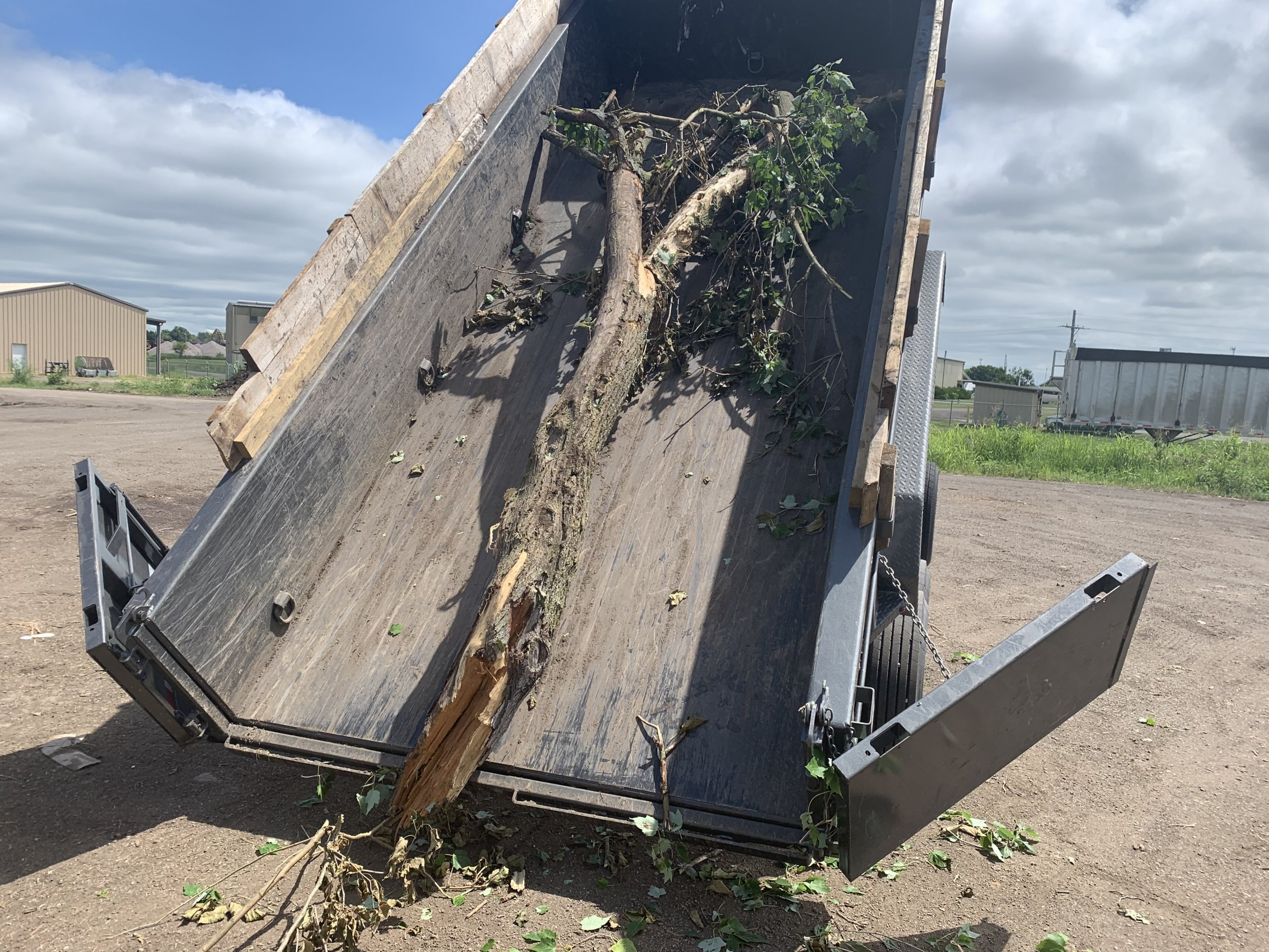

Tree brush goes on the bottom, logs or heavy parts go on top. This keeps the stuff in the trailer, during transport, and makes tarping easier. When you go to dump, the small twigs (in the brush) will easily slide past and break on the D-rings, if the heavy stuff is on top, using the brush to slide on. If the heavy stuff is on bottom, it gets stuck easier. Be careful that all logs are laid in front to back. If you don’t, they can roll, when the trailer is lifted up. I’ve heard of some rolling out and hitting the doors, causing damage. I’ve had a couple roll out, but no damage. It can also be dangerous.

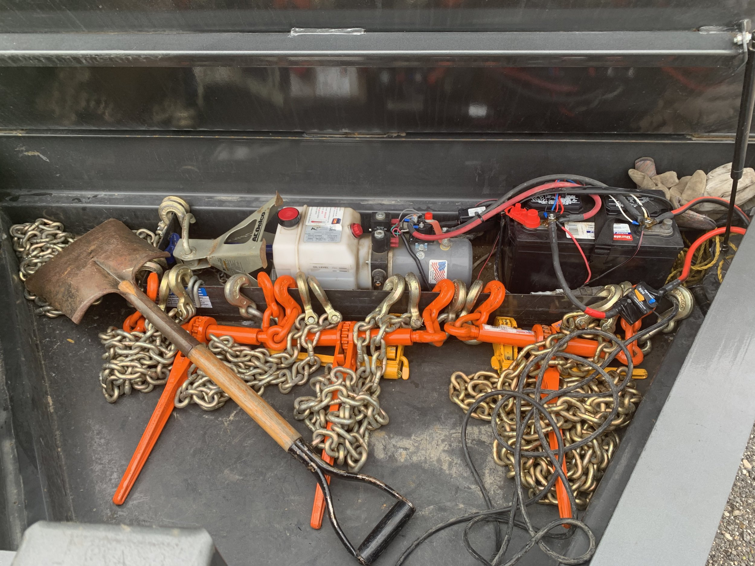

Keep a shovel handy. I keep at least one in the toolbox. It’s handy when you’re loaded too front heavy or when stuff gets stuck, inside. Remember, do not stand where the load will land. Major safety issue. If stuff is stuck, use a shovel to break it up, but stand to the side as much as possible.
Also keep a 24-36” prybar handy. I had a log get stuck in the ramp mounts and it was much too heavy to move, by hand. Me and another guy put out weight behind a 36” bar and got it to move enough to come off.
I ran a 2 AWG set of cables from my truck battery to trailer battery. If you’re using the trailer much, do this. I did a detailed write-up, on a couple of other forums, which I’ll come back and link. I also have a high idle setup, on my gas F-350. I use it when I know the load is heavy or loaded poorly. It further retards voltage drop.

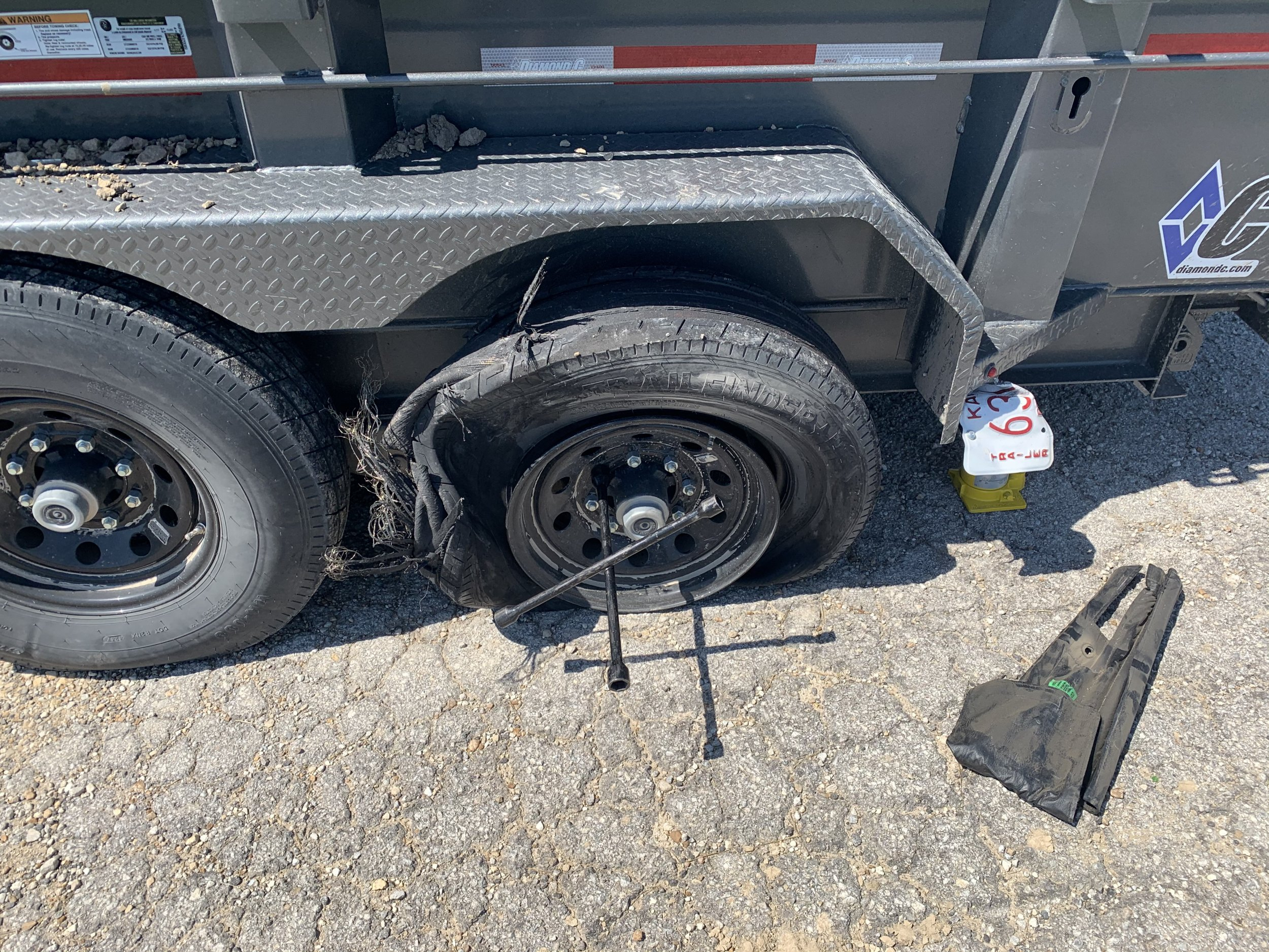

I’ve had one blowout, while traveling. Of course, I was loaded at around 4.5T (not far from payload capacity). Lifting a loaded dump trailer, in summer, is a terrible experience. Have a proper bottle jack handy as well as a way to get lug nuts off. Also, have a proper spare that’s weight rated, for your load.

Low battery is the cause of most problems, with electric over hydraulic pumps. If you don’t have gravity down, the first sign of a low battery is the fluid will come back into the reservoir too quickly and will blow out the relief. On the power down (opposite of gravity down, some pumps offer both), the pump controls the fluid return rate and a low battery doesn’t control it enough. The next most likely problem is a solenoid giving out. My first one burned up within a couple of weeks. That was replaced, by KTI (the hydraulic pump maker). That one lasted around two years. I am on my third (first one was bad off the shelf, for the most part). I also have a backup I keep, in the truck.

Here is the tree limb that got stuck. It wouldn’t have happened, had we out it on top. this was after we used the pry bar.
This is how I currently have my trailer toolbox set up:
From the blowout. I was able to back it onto the blacktop.

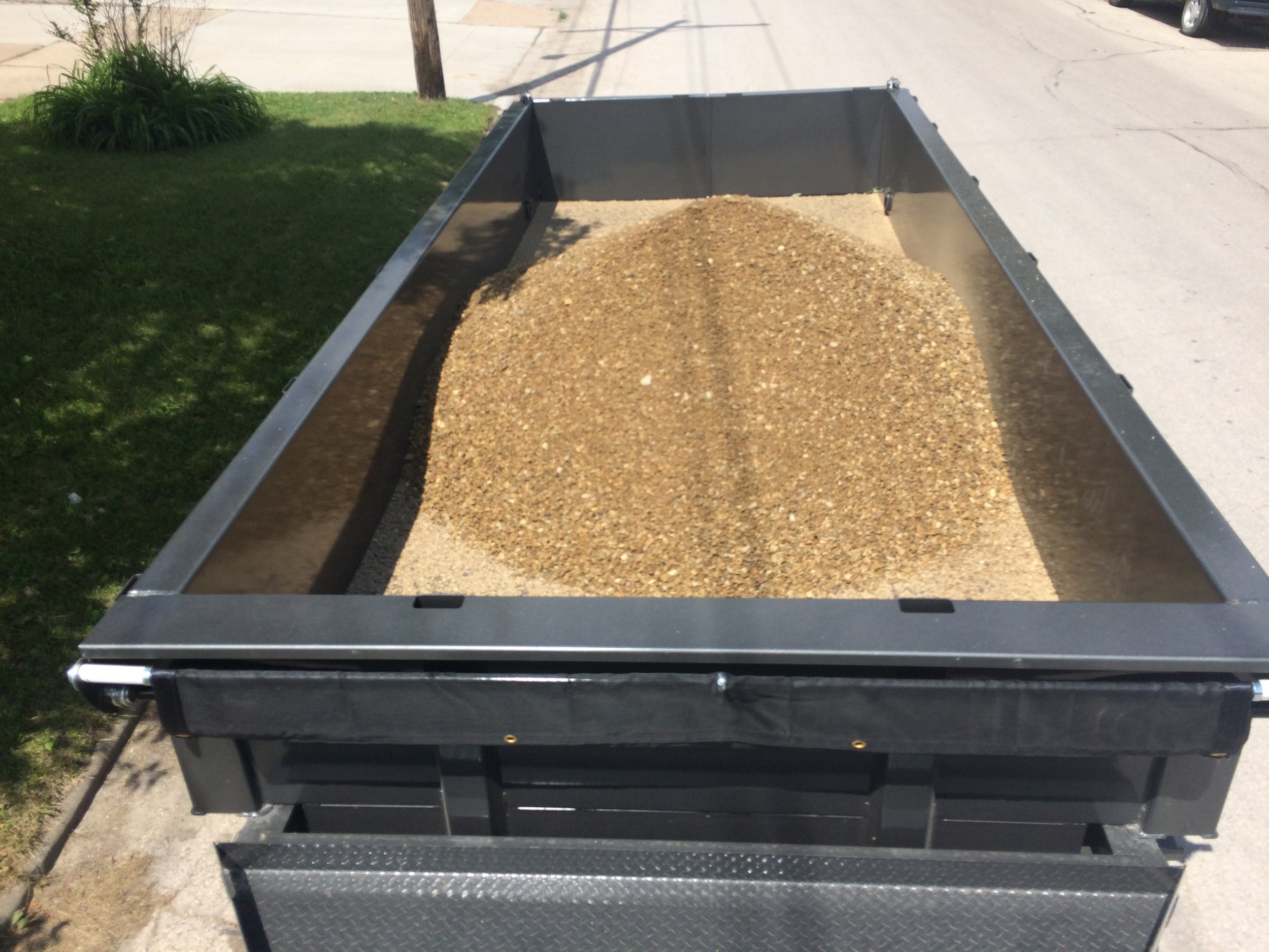

What I bought it for (this was my first load, 3T small river rock):

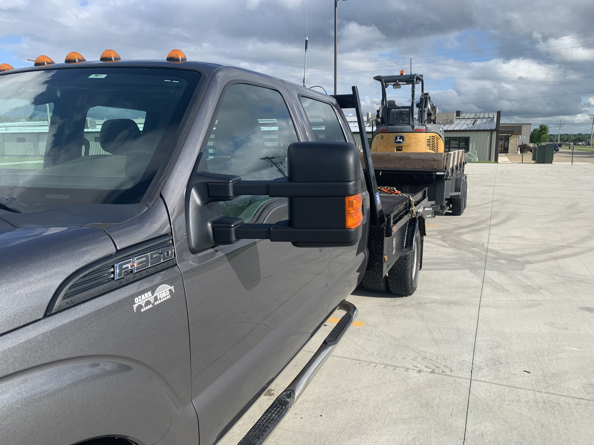

Thus us what I’ve been doing, lately:

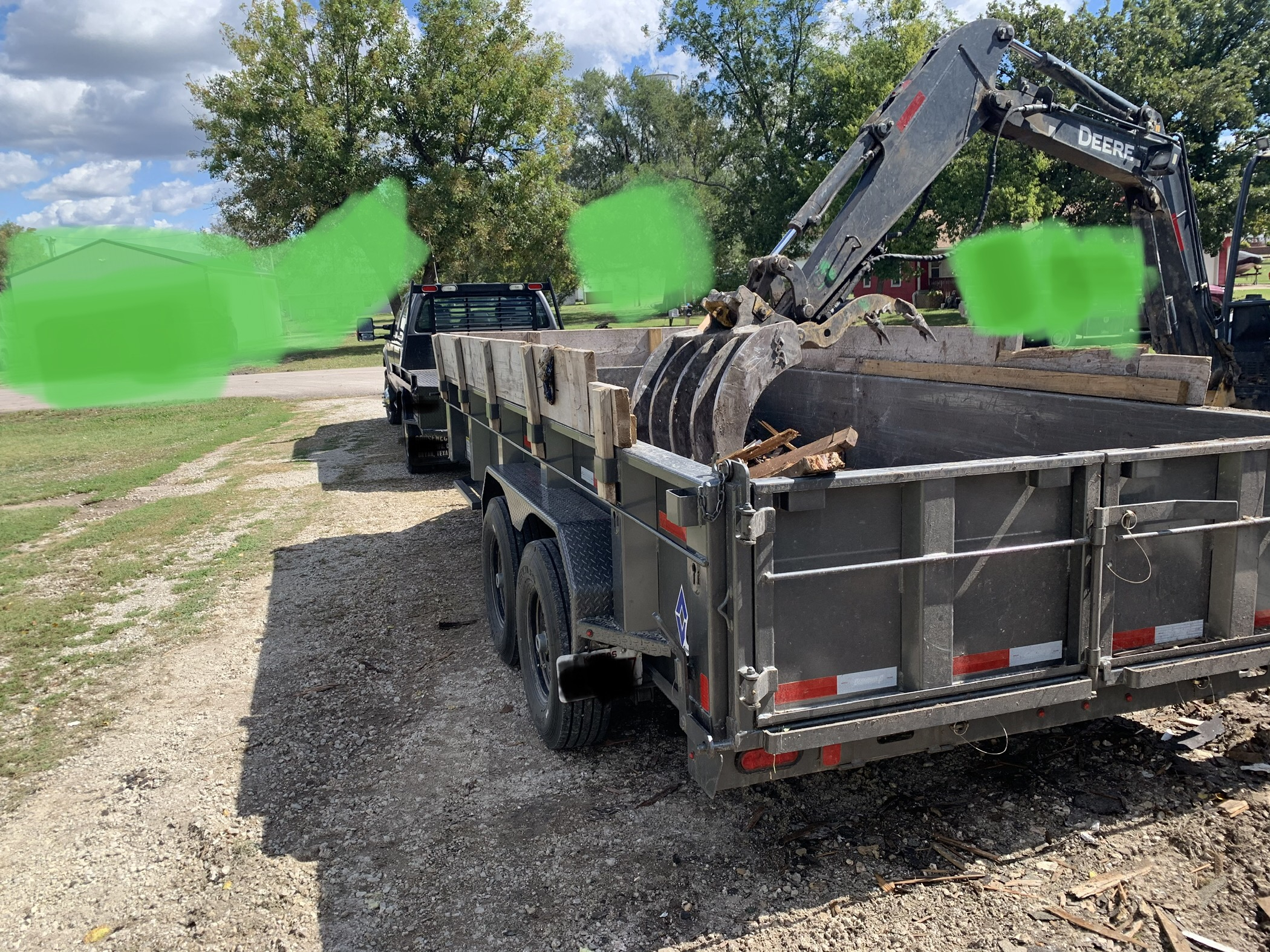

And this:

I would be scared to death working around those thick green clouds:)
