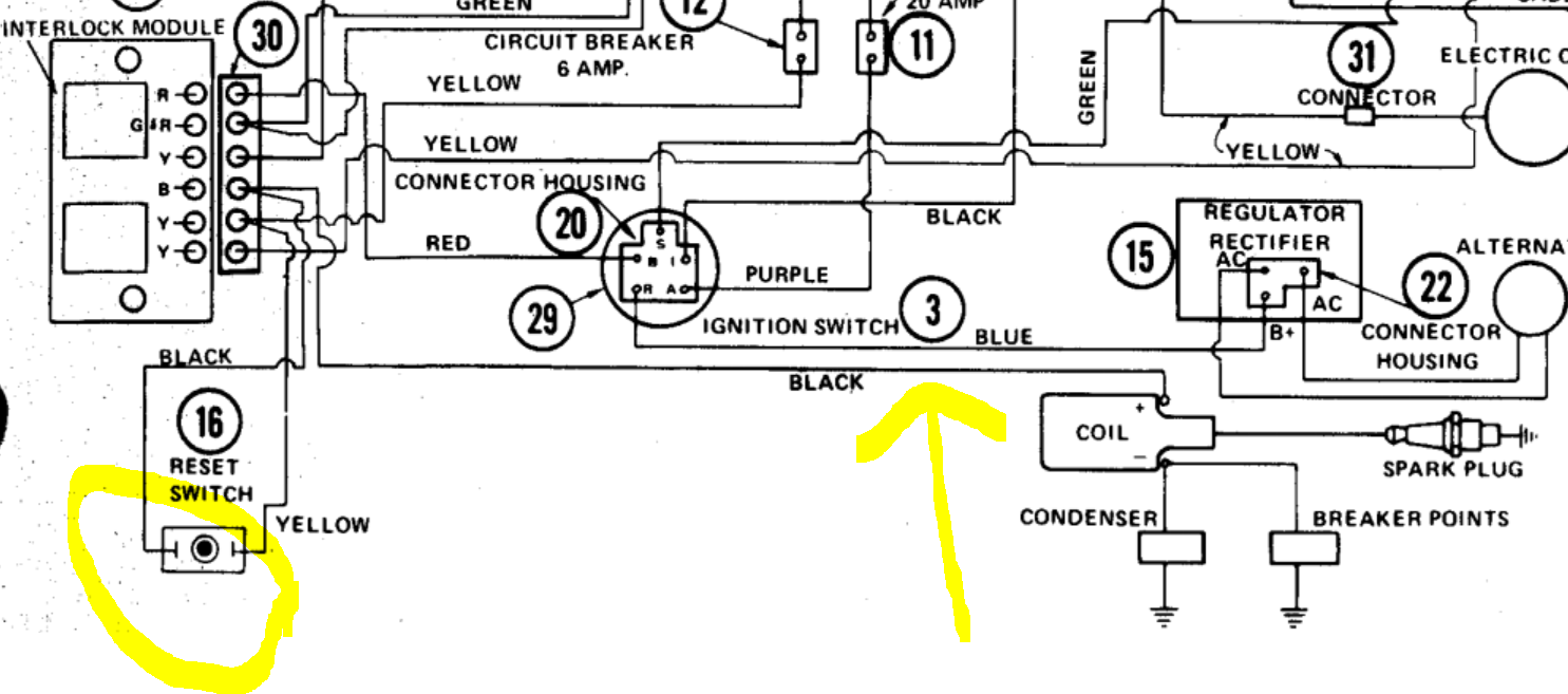

Looking for information about the Ariens GT16 lawn tractor : Just bought it and I cant get it started turn the key but nothing happens I know there are several safety switches but have no idea where they are located Also looking at the reverse valves for rolling it backward there down and do not move no matter if the lever is up or down yes battery is ok. Thank you for any help.

thank's will ck that however wiring diagram nor manual does not show location of the safety switches any clues?
/ Ariens GT!16 #4
switch under seat .... if you're not sitting in it , the unit won't start .
some have an interlock on the shifter lever ( must be in neutral to start )
the PTO switches must be pushed IN or it won't crank (circuit is broken by the rear connections on the switches )
depending on the model and accessories, you either follow the green wire or the purple wire on the PTO switches and find the last safety switch.

Have you tried the reset switch ? It looks like the interlock system disables the + to the ignition coil. Take a volt meter and see if you have battery voltage on the coil with the key on. If not you could remove the + wire and jumper it to the battery for testing.

Ok guys
Got it started was a switch in the shift housing sits and runs fine we are going to give it a full service now before use. just want to learn how to use now now this opens to a whole new bunch of questions lets start with HOW DO YOU OPERATE THE MOWER I CAN'T SEEM TO FIGURE OUT HOW TO LOWER IT SO IT WILL CUT.
