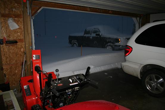

Fordlords,
I own a 9/26 Ariens snow blower. I bought it a few years ago, and I really like it. It shares the snow removal duties with my Toro WH 520xi which has a front blade. I use it when the snow gets above 8". I remember you saying that you live in, and around the mall area. I live just south of Conneaut. We have around 15" of snow now. How much do you have in your area? This is what my 9/26 Ariens had to look forward to on Friday morning.
