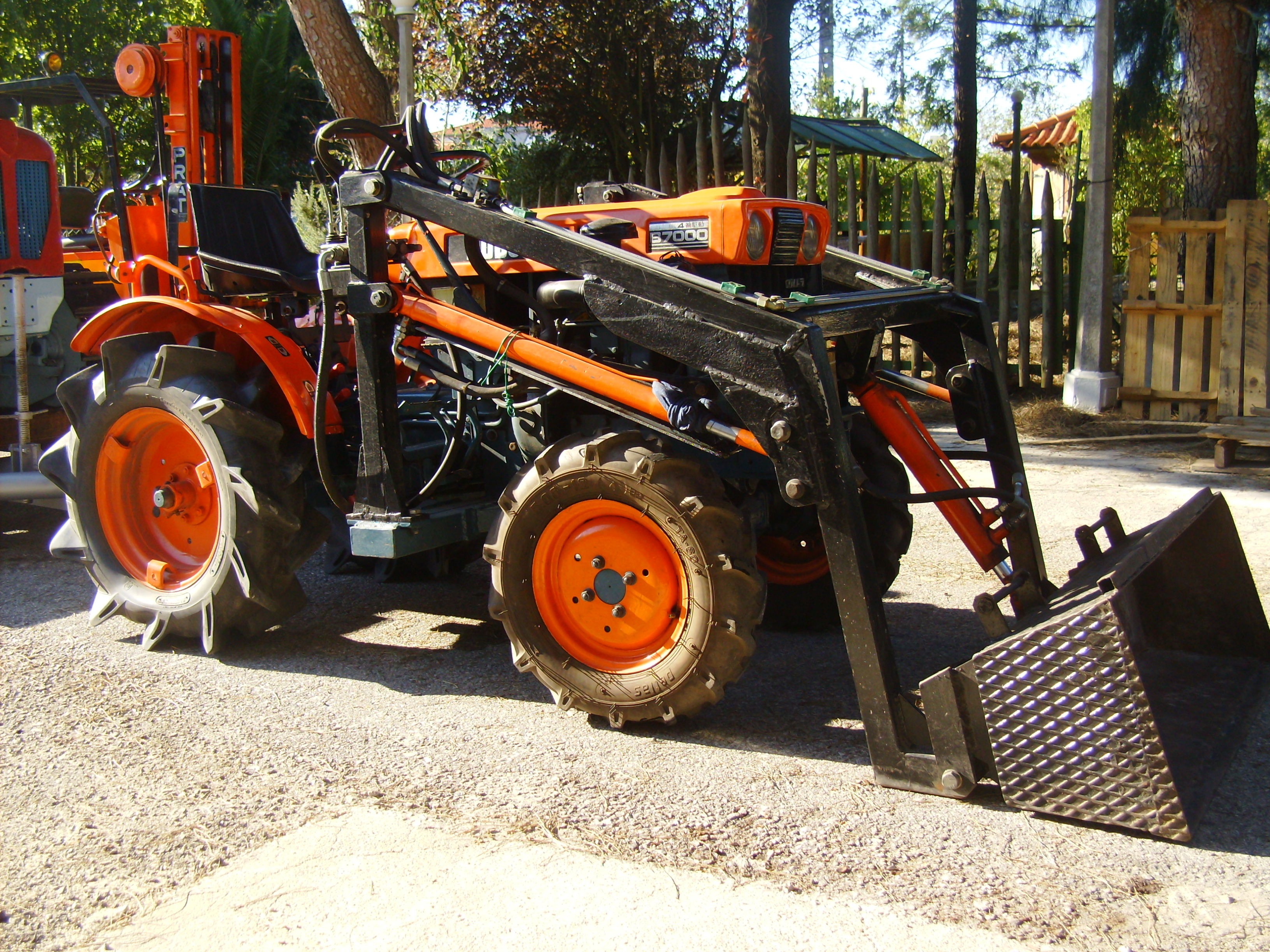

At the time Kubota made these tractors, it was very rare to see a loader on such a small tractor. So they are not really ready to easily install a loader.
There are the aftermarket ones but as mentioned before, the price is just to much.
I also was looking for a loader when I had my B7000. Ended up building one myself. Which worked perfectly.

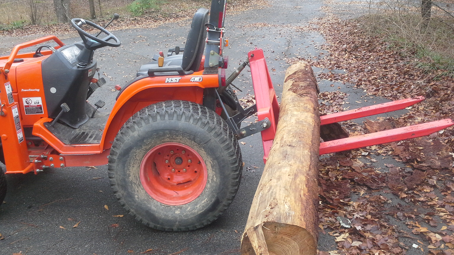

Tractor data.com lists no loader model for the B6100...actually no loader is listed for the next two progressions of the model...also no power steering which is important with a loader...!
IMO...with an aftermarket 3rd party loader the biggest issue might be the sub frame...
Dirt scoop is a good option as the tractor barely weighs 1000lb's...
You can maybe find a light weight front push blade to help with the dirt...is there any hydraulics on the snow blower?
