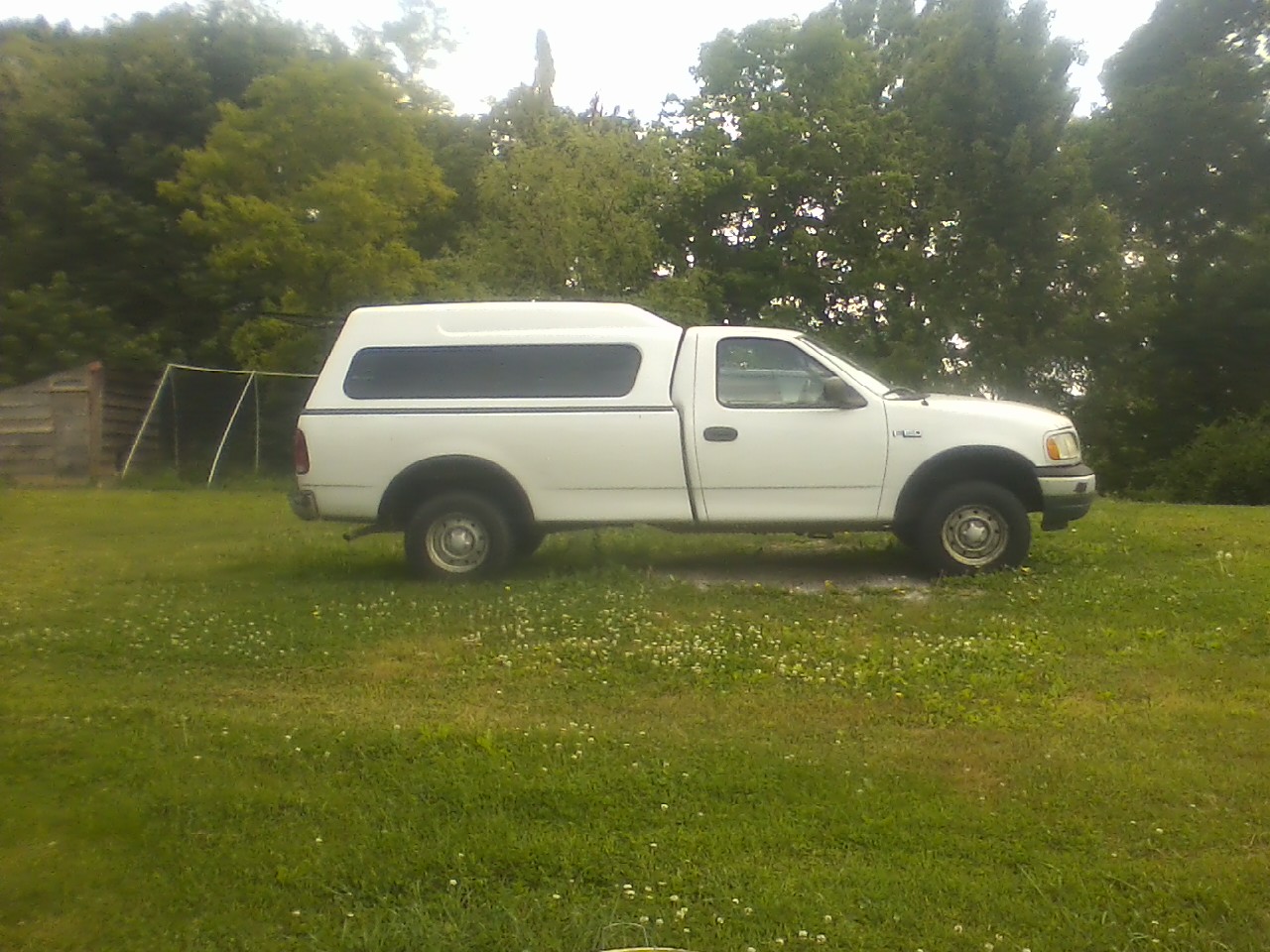

took a while but got this for $160. its a bit dirty/moldy inside but cleanable.
   / are pickup truck camper caps brand specific? #8
Great find...congrats.
