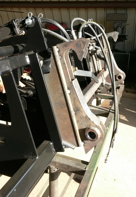

So, I quess this is what my customer is calling the "Euro Global" ... I don't think so.
   / Are new Kubotas Euro Global? #6
Nope, this is euro mount:
It is commonly found on large tractors close to 100hp and over.
JD has been offering it on many of their utility tractors for several years and calling it the Global Attachment Carrier.
Quike(ALO) is one of the main mfgs that made it popular in the US. They made & may still make loaders for Case and New Holland.

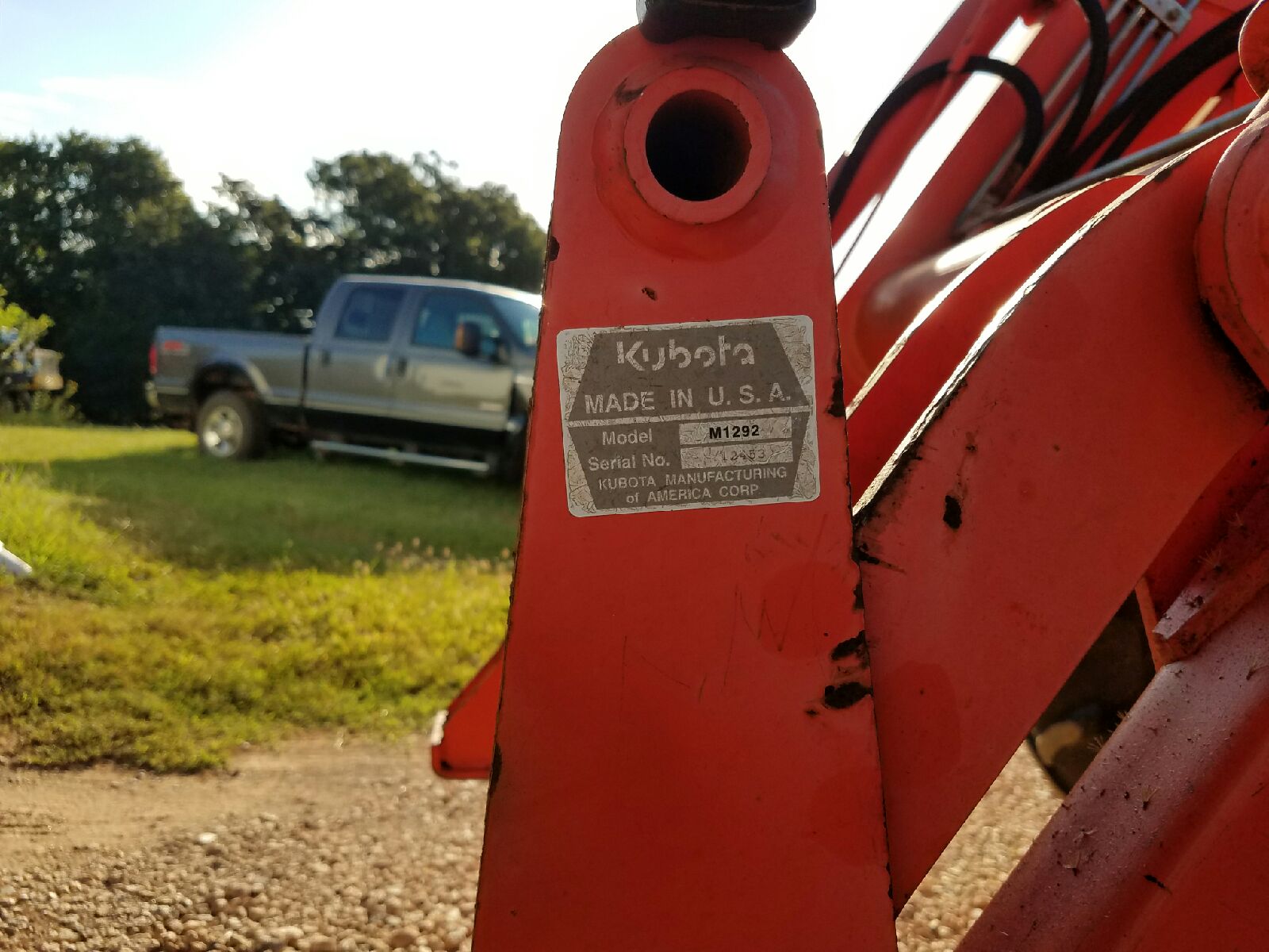

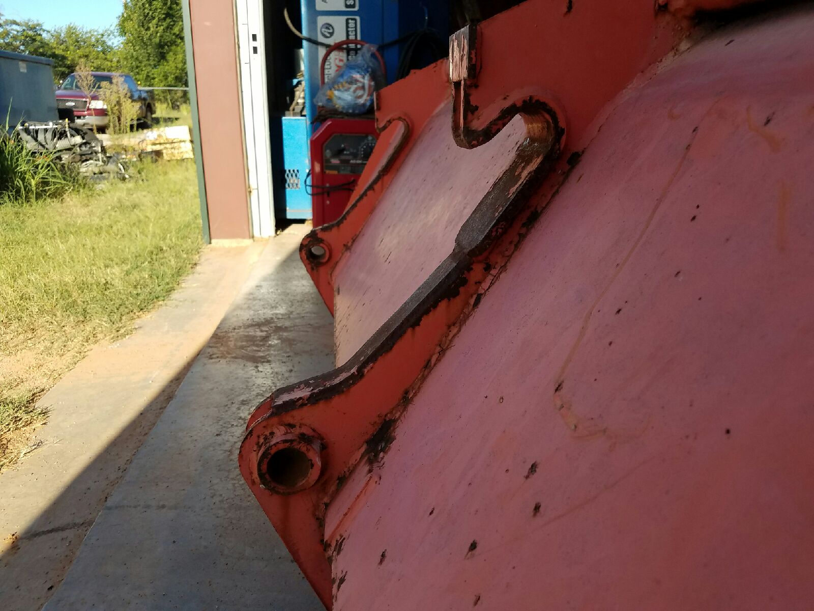

Travis thank you for the reply ... I've got the Euro global in my cad program ... I've started another thread looking for cad drawings or specs for the M1292 to SSQA, any help would be appreciated.
BR
#9
Some of the REAL old Alo loaders had the attachment lugs inline like that, guy down the road has an ALO Quicke that way. SMS (Swedish Machine Standard) rings a bell.
Looks like I'm gonna have to have the customer bring the M1292 to me to scale and draw to make this conversion.

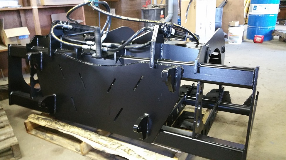

Almost done ... Still gotta roll the upper plate into the top of the hitch. The grapple is finished.
This converts him to SSQA.
