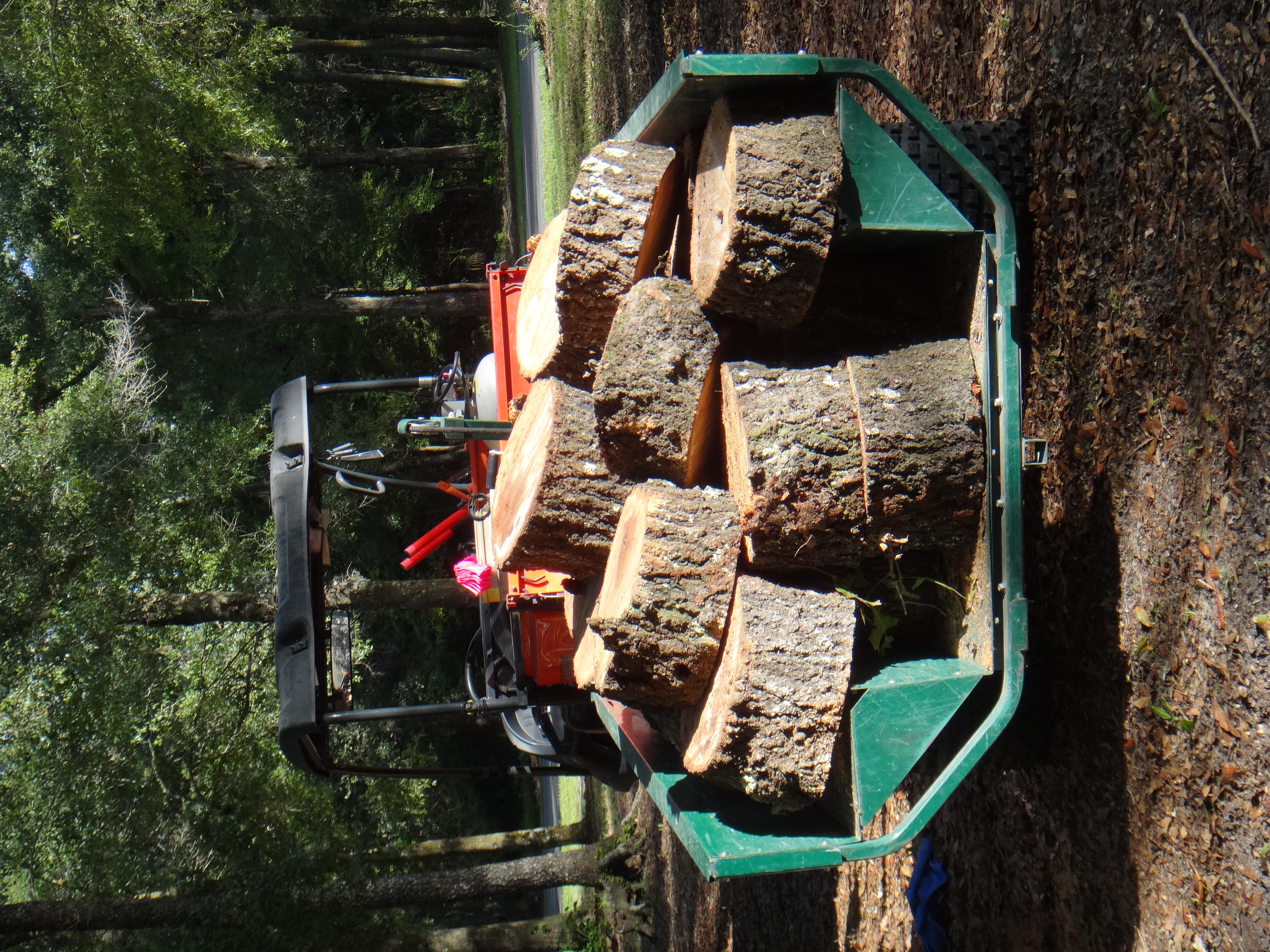

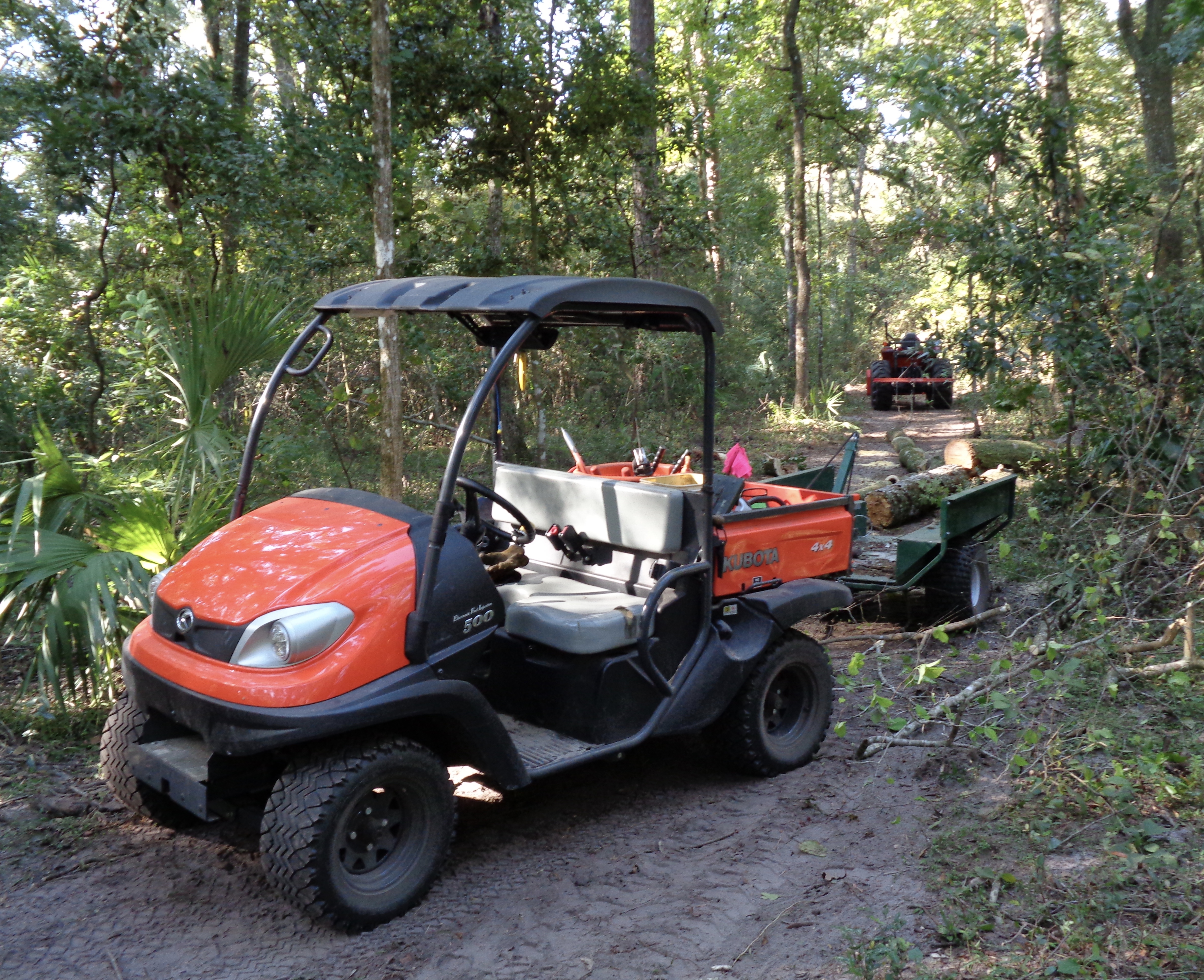

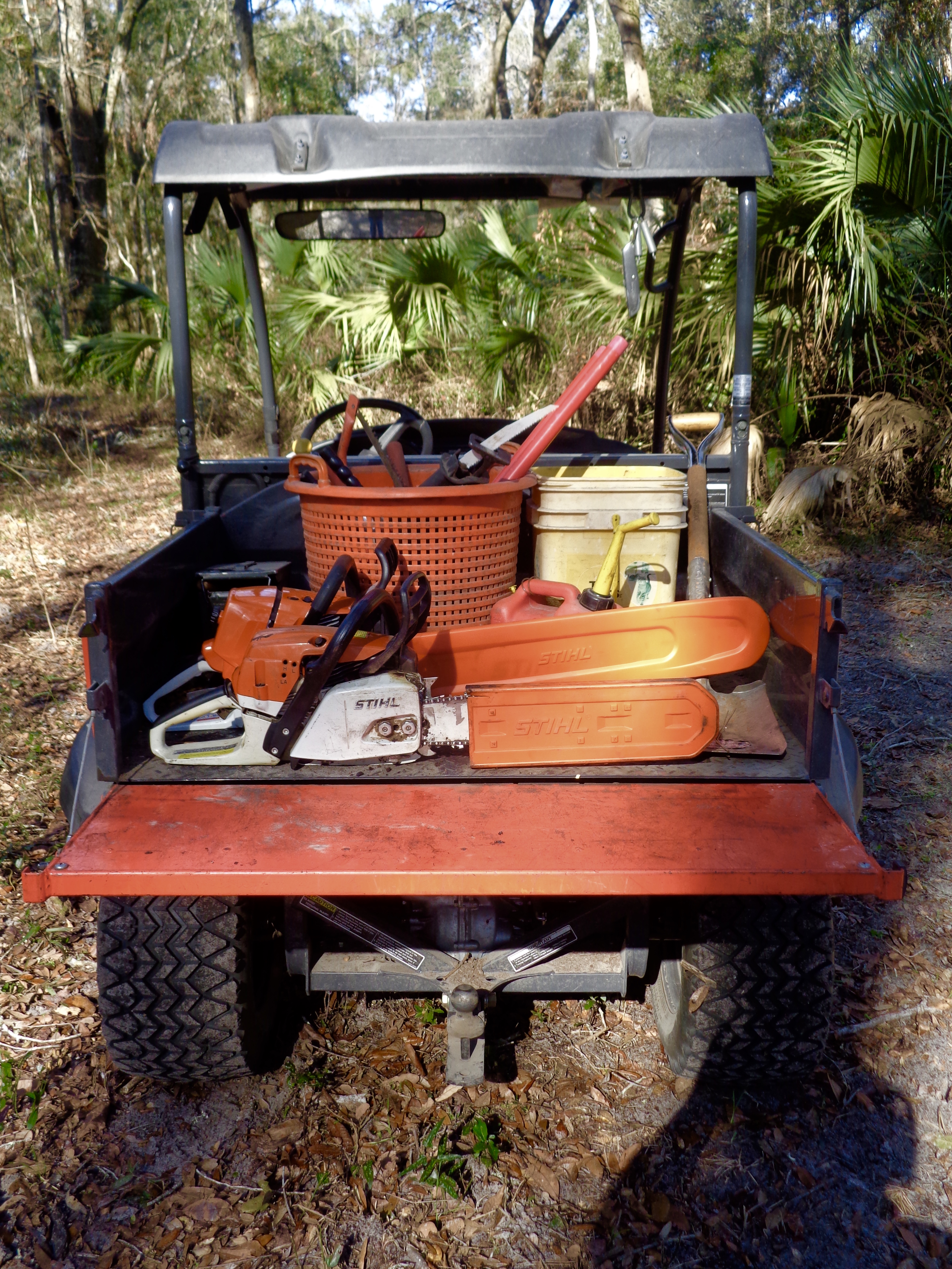

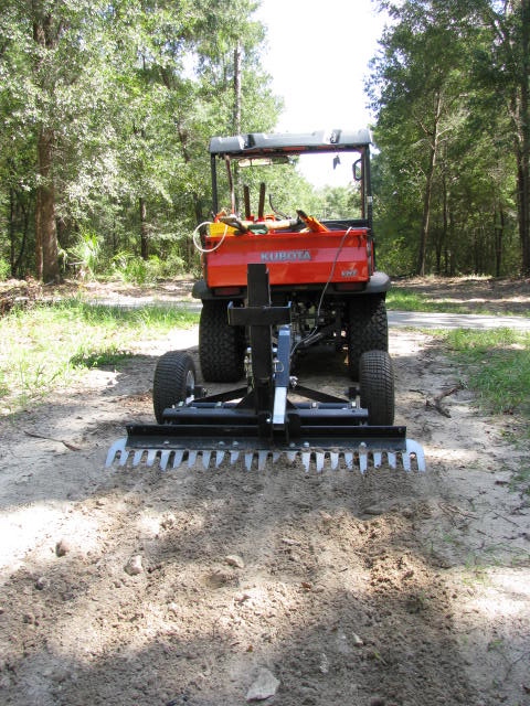

Kubota RTVs have the same HST transmissions as Kubota BX tractors. Kubota RTVs are workers.
Dad probably won't want to go faster than 25-mph anyhow.
I have a gas, 15.8 horsepower, HST Kubota RTV500. $10,000 new.
1,000 engine hours, one minor problem with contaminated gas.
RTV500 has a manual dump bed, not power. I use the bed for tools, a trailer for loads.
Most utility vehicles record engine hours but not miles.
Buying used the key factor is prudence of first owner. Prudence in operation. Prudence with maintenance.
