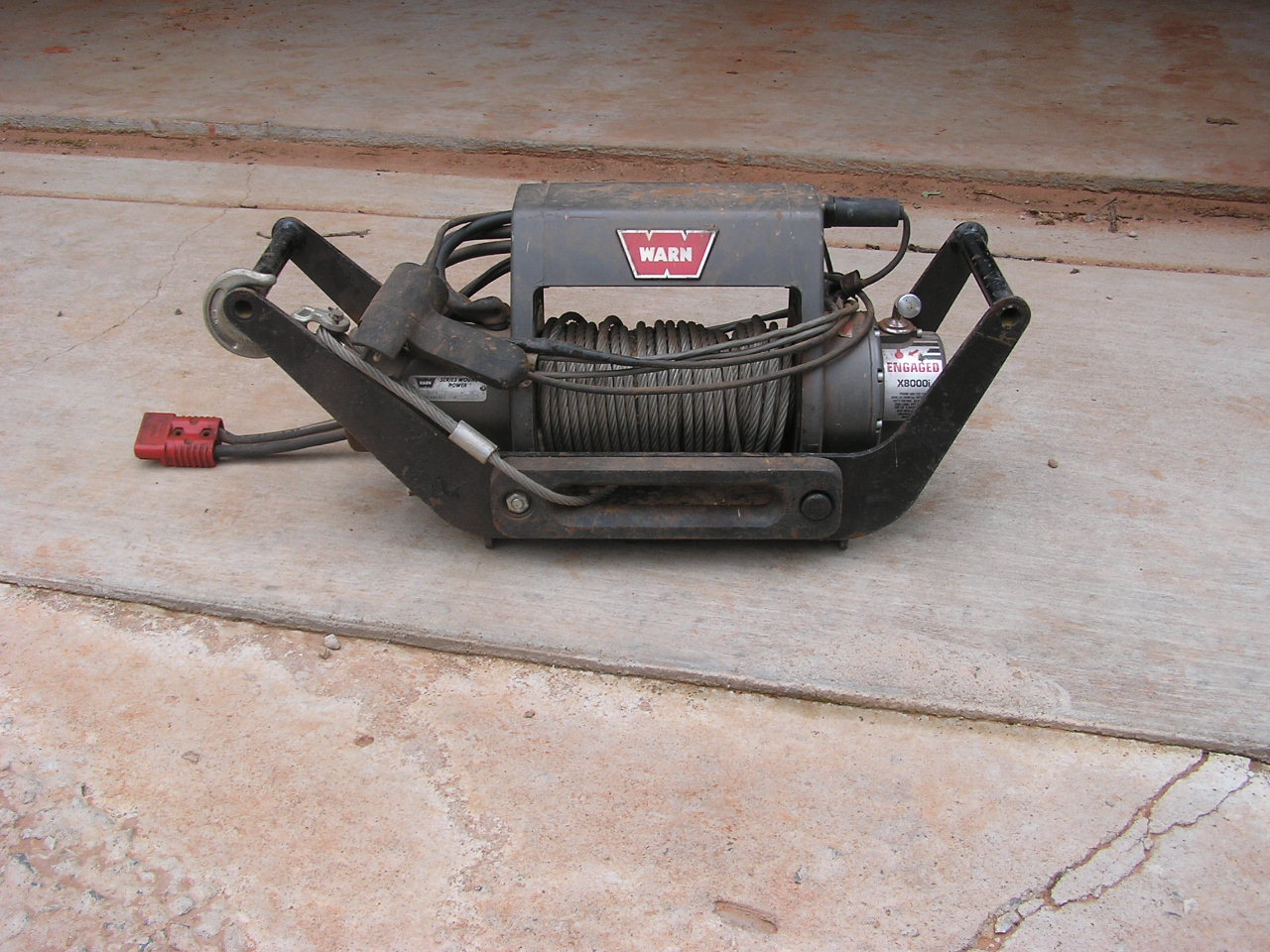

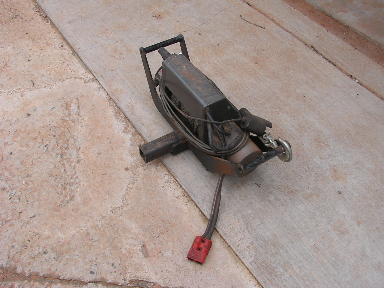

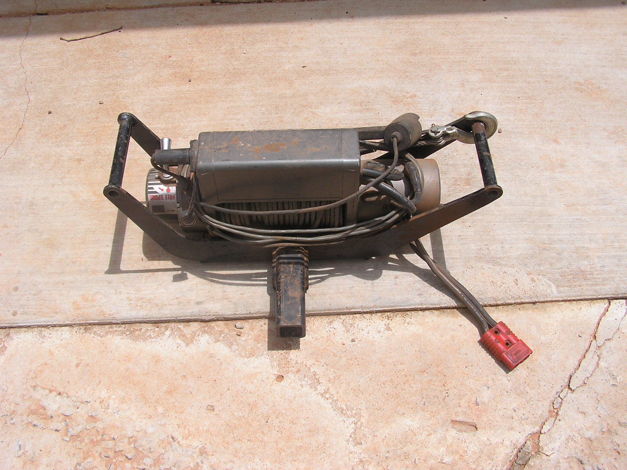

If the hitch is a receiver, make something that will slide in it when extra weight is needed.
Like this:
   / Are counter balance weights for the front ends universal
No it is just a standard flat bar he cut down. Good idea about receiver hitch though. I can't believe folks want around 100.00 each for the suitcase weights. I will be on the lookout at flea markets etc. I have seen them for sale but never thought I would need them.
