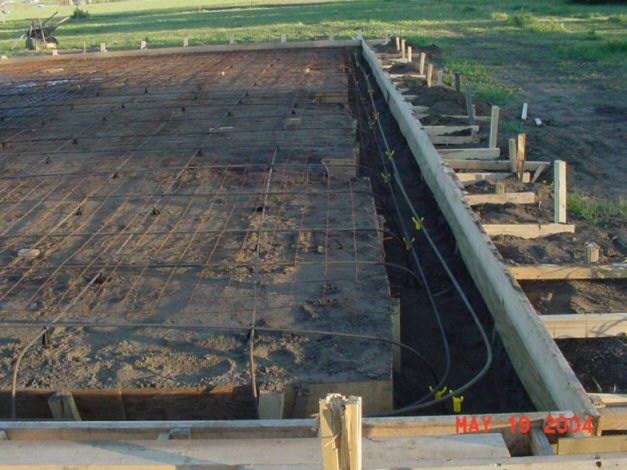

PIC 1 is the concrete forms ready to pour.

PIC 1 again. PIC 1 is the concrete forms ready to pour.
I had to resize it.
   / arch building #5
I've posted pictures before, now I can't get it to work and feel like a total idiot. I'll try again.
PIC 1 again, again. PIC 1 is the concrete forms ready to pour.

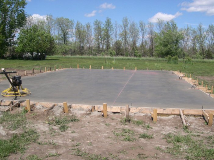

PIC 2 - Finished slab.

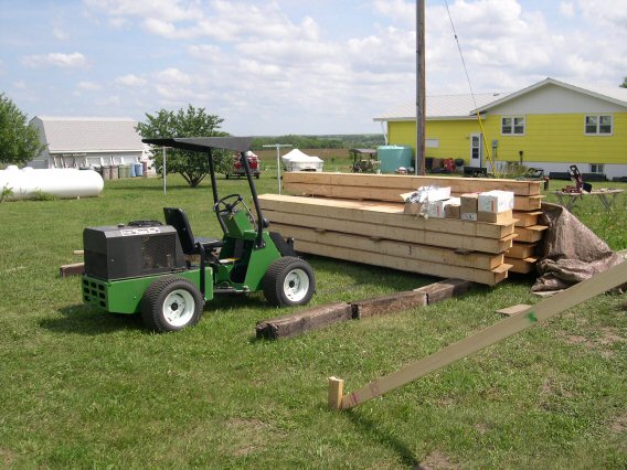

PIC 3 - The frame, or posts for the building. We used the PT425 to move these around several times and get them in position to be raised.

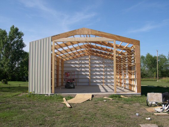

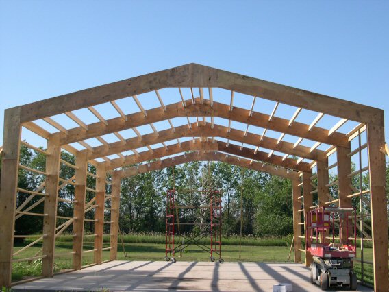

PIC 4 - All of the frames are set, the roof purlins and wall girts are in. Ready to intall an entrance door and begin the steel siding.

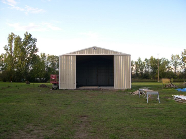

PIC 6 - Everything completed except the two sliding doors, each 8' x 14'. Lots of work left to do on the inside of course.
