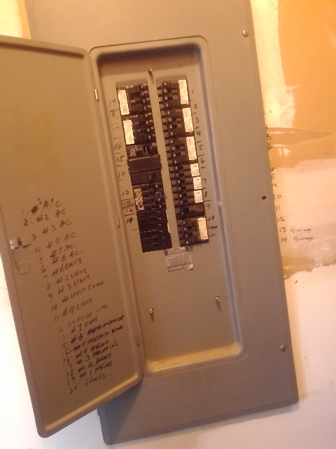

I was just given a Lincoln AC225, and was trying to figure out what size breaker I need to install.

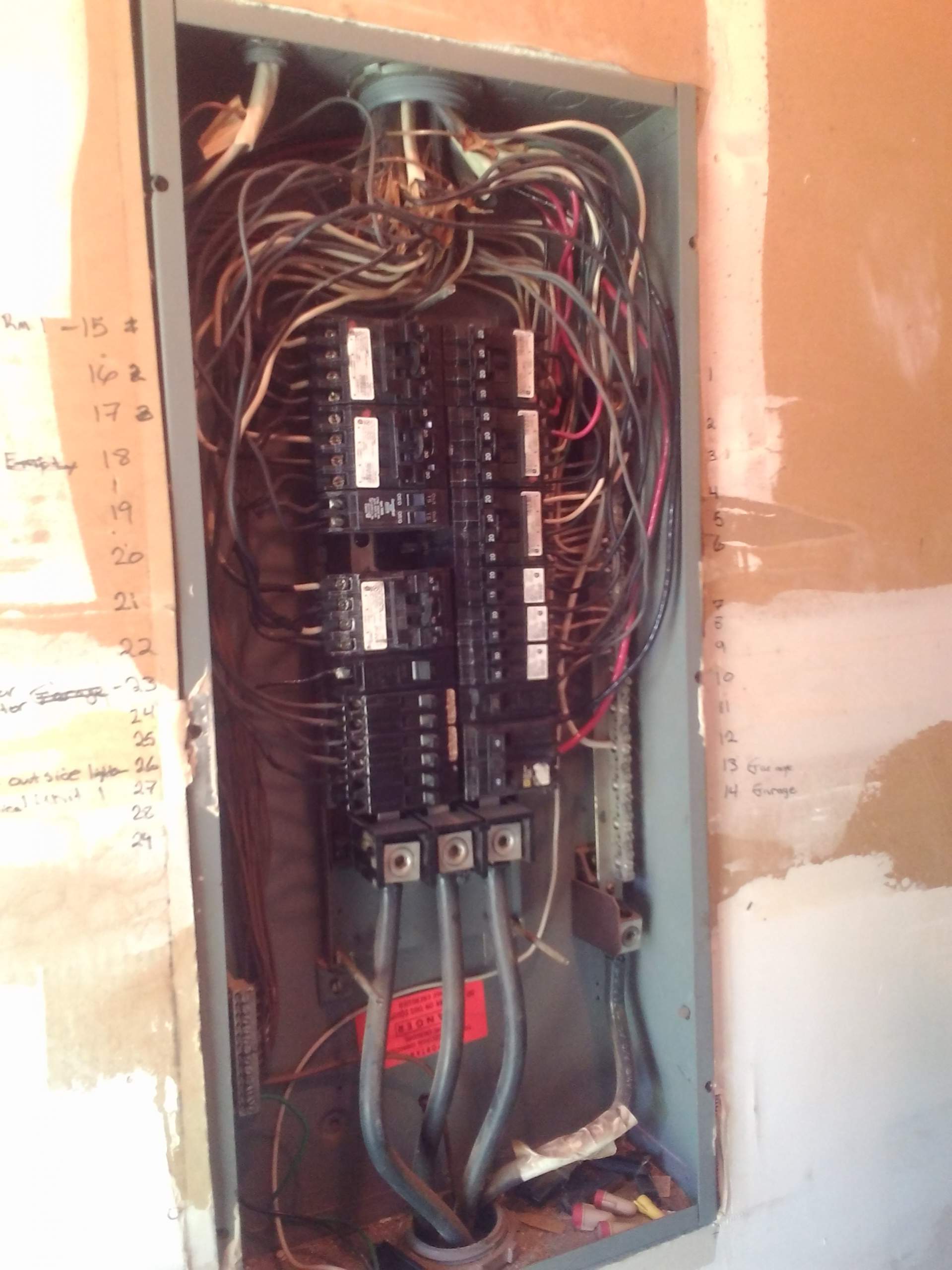

As far as power, I would like to use it in our garage, which currently has a sub-panel that is being fed with #6 off a 30 amp breaker.

Why is your panel fed with #6 but only a 30A breaker? Is it an exceptionally long run? #6 is good for 55A, and an exception in the code allows you to round UP to the next common breaker size if the rated wire size is not available. So #6 can take a 60A breaker. Then put a typical 50A 3 wire welder outlet in there for the welder and be happy.

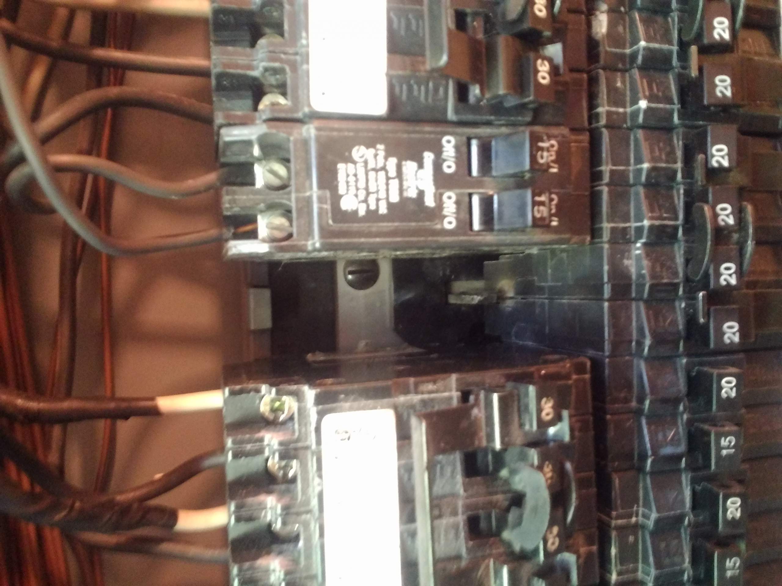

It's a long story. The subpanel that feeds to sub panel in the Garage had a burned part of the bus bar rendering some of it useless, so we had a local electrician come out and he moved some stuff around and was able to get everything to fit, but removed the 40 amp breaker and put a quad thirty in its place. I might see about getting a quad with 20-40 or the like, but I'm not sure what the likelihood of that is, as the breakers for this box are hard to find. A while back I tried to find a 20/15 but was unable to do so.
Sounds like you might want to replace the box with a new one that isn't burned and which you can get breakers for :D
