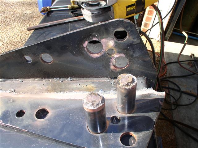

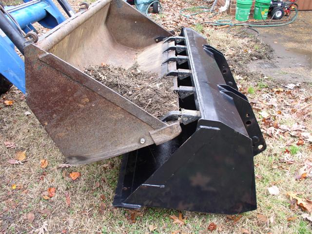

I was all set to build a new 6' material bucket with a bolt on edge. The design was done all the bends were checked I had purchesed the bolt on edge and I was ready to get a quote from a fab shop. I stopped by my dealer on a lark and saw this bucket way in the back lot. He said it didn't fit anything they have ever sold and it was shipped to them by mistake and he couldn't return it. When he said he'd take $300 it was hard to keep a straight face because I'm sure it would cost $500 to build my design and $1000 to buy a new one. I'm modifing this bucket to fit on my Woods loader. I burned off the outside bracket but the brackets are connected by two 2" solid rods with alot of weld. I want to keep the inside bracket for stiffness so I decieded to air arc the welds away so the holes would be in good shape. Any stick type welder power source will work but DC rev will make a deeper narrow groove. You can purchase 5/32" or 1/4" carbon gouging electrodes at the welding store and use a standard compressed air blow gun to blow the puddle away. I ran this at about 70 amps DC Rev. Touch the carbon to the weld area and when an arc forms pull it back slightly to stabilize the arc. The fillet directly under the arc will melt. Hit it with a shot air while the arc is still going in order to blow the puddle away. The whole sequence should take about 2 sec. and then repeat. A copper tube inserted into the blow gun will give your hand some distance from the heat and help direct the air. The whole operation took about 30 min. and two carbon rods per side. Do this outside as there is hot metal flying. That is a 7" grinder in the backgroud for size reference.

Neat! That looks like you just de-soldered it.

Well,you did know they made a holder/airblow thing all in one ,,didn't you??read what I told john bud concerning this in his fixing backhoe crack topic,,a few weeks back,,its called carbon arc air gouging,,been around for 50 plus years,,,thingy

They are about $100. Looks just like a electrode holder but has a little hole in the side pointing right down the rod. Problem is, they flat eat up air. A 5hp compressor will barely keep up. Those holders are made to hold up to 3/8 carbon rod witch will take 350A to use. I mainly do small stuff 1/4 plate etc. so I use 5/32 carbon and a blow gun with a metal tip.

Don't know how much it costs,not all that much,,cause they ain't much there,,100 dollars sounds right,I think the smallest carbon rod they sell is 5/32,,which means you need maybe 150-160 amps,,dcep,,in other words that carbon arc holder will take the 5/32 rod to,at least one made for 5/32,,,,,air,,, probably about 80 to 90 psi,,and a 1 hp compressor should be enough,guess it would depend on how much air it stored,may need to take breaks every couple min,,but not many of us would be gouging all that much,,but think you can get by with less than a 5 h.p. compressor,they work pretty slick once you get used to it a little,,
But nothing wrong with reinventing it I guess,,,thingy
