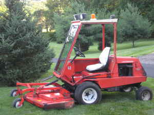

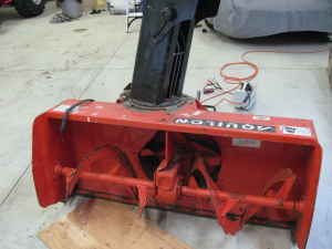

Have a 48" Aquilon hydrostatic drive snowblower attachment mounted on front of a basterdized Jacobsen LF-100 / T422D mix Turfcat. The prior owner alleges to have purchased the aftermarket attachment new about 13 years ago for approximately $2,000.00. The equipment nameplate implies that it was manufactured by a Canadian company. Attached is a digital photograph of the Aquilon and the Jacobsen it is used on.
My actual experience with its use indicates that it is a good piece of equipment.
I have been searching the web to find out more about this equipment - particularly repair / service / parts manuals. No luck. This forum and this thread is the only hit reached after days of searching. Estimate approximately 72 manhours exhausted in performing all kinds of search strings and reading thousands of resulting "hits".
Anyone out there with info - is invited to respond.

Never heard of the Aquilon brand.......... but i can assure you that particular blower was manufactured by RAD in Canada. They make blowers under the 'names' Massey Ferguson, Kubota, New Holland / Case, Frontier, and i'm sure others...... as well as their own brand, Blizzard. It is definitely a well made unit. I'd say one of the best made snowblowers on the market.

Finally received some information and help from RAD Technologies, Inc.
My AQUILON, Model Number JT2051 Snowblower was manufactured pre-1994 by Aquilon Technologies, Inc, Quebec, Canada.
The JT potion of the Model Number indicates that it is designed to mount to the front of a Jacobsen Turfcat (JT).
Here is what RAD TEchnologies had to say in an email to me:
"RAD Technologies did buy the Aquilon's assets when it went bankrupt in 1994 and you can purchase parts directly from us. We can't however guarantee that all parts are available since your snowblower was manufactured back in 1993. Attached is the operator's and parts manual for your unit.
If you need additional information don't hesitate to contact us again.
Claire Gagnon
2835, Chemin de l'A駻oport
Thetford Mines (Qu饕ec)
G6G 5R7
Tel: 418-338-4499 / 1-800-338-1615 ext. 224
Fax: 418-338-6090
e-mail: c.gagnon@radinter.com "
To save everyone some effort - Will make an attempt to attach the manual for this machine to this Posting.
Have used this snowblower extensively this winter - the thing cuts like a surgeon around delicate obstructions - like garage doors (where plows leave piles). Have to swear by it.
Sorry folks - I tried to upload the manual - but the file size was too big under the Webmaster's Rules. But RAD Technologies will accommadate you.
