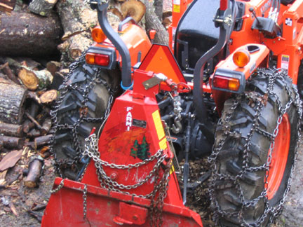

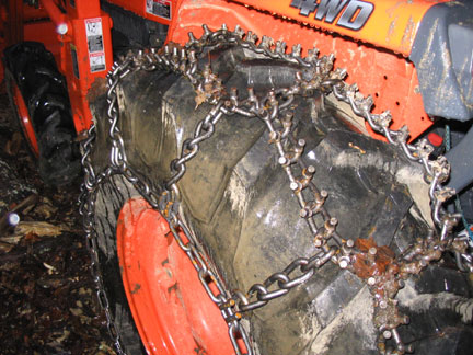

here's a couple of pics of my chains on the kubota
simonmeridew

I started this project last night in a poorly lit garage. When the sun came up today things were easier to see. Leaving the cross chains until last is an important step. I can lift these chains on the tire OK. About 80 pounds each. It was just that I didn't know what I was doing until I got there. Once I got the chain on straight, even, and tight I marked the links where the boom connector should be. Then, as you suggested, I marked the "tails" where the cross links and boom connectors hook up and cut off the excess chain with a cut-off wheel. This does make for a tidy and neat job. After this I tried mounting the chain the second time. Three hours to mount the chain the first try and 45 minutes to mount the chain on the second try. This chain is mounted really tight. No slap or chain noise at all. I did order the chain tensioner kit form tirechains.com but I really don't think these chains need it. Thanks for the help from everyone. The advice, and especially the pictures, made things a whole lot easier for me.
