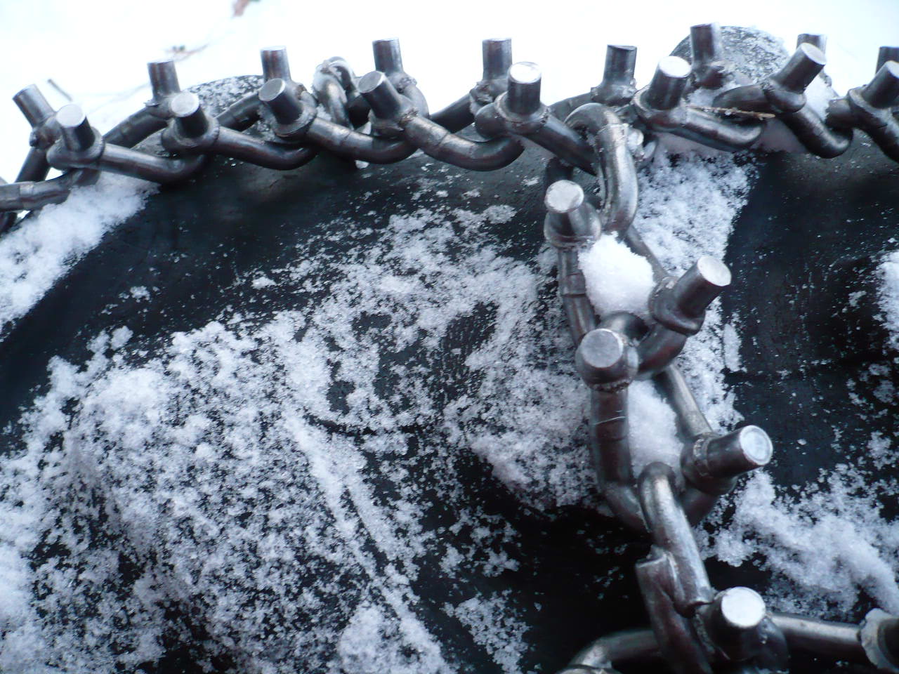

I went with the Trygg chains, but they are for serious traction. Not sure if they're more than you need. $650.00 for mine. 14.9 x 28
http://www.trygg.no/
Home page | Trygg
Those look to be almost identical to my Norse chains. I see they are made in Norway, same as the Norse.
Chilly
   / Aquiline chains: How are they? #10
Yes, Norway I believe. I'm sure they make them for everyone.
